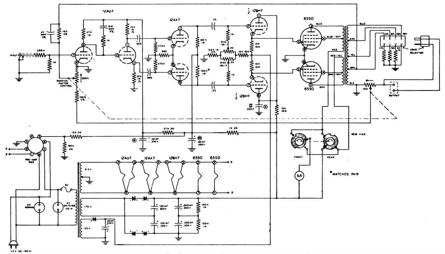

The Heath W6M (schematic uploaded) is an interesting Class "AB2" Williamson setup, which might be reviewed. FWIW, I'd change the small signal complement to: "improve" gain structure, increase open loop linearity, and boost gm.

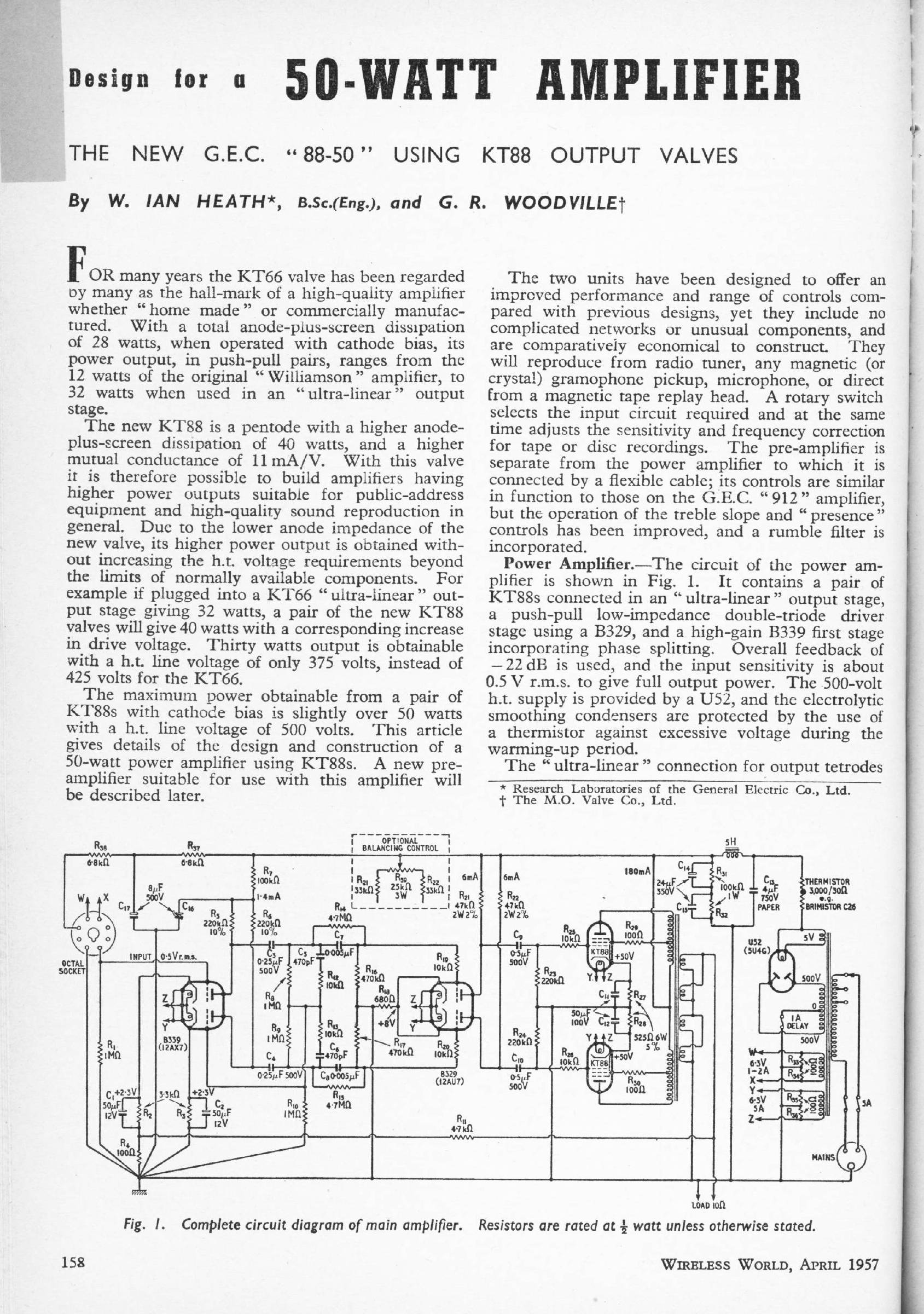

I have built Mullard and Williamson (including improved version) in the past. However, my schematic of preference is floating paraphase - differential - push pull.
Please find schematic attached, you can search for whole article on the net if you wish, its really insightful and comprehensive.
I have changed cathode bias to fixed bias, and 12AX7 to 6N2P-EV.
Please note grid leak resistors R1/R10, as well as R8/R9 need to be 470K instead of 1M, B+ voltage 460 - 490V. Output power is 60W with 3.3 - 3.9K output transformer.
Unlike Williamson, and some Mullard 520 variants, this design doesn't suffer from so bad instability/oscillation problems, and have very low distortions.

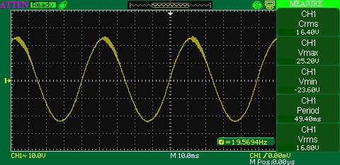

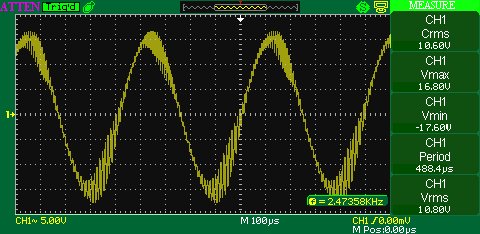

Another issue you may encounter is an output stage oscillation under certain circumstances related to the quality of output transformer. It is not specific to this schematic, its a common issue of all UL amplifiers.
Disconnect global NFB (R11), and drive your amp into overload with 8 Ohm wirewound resistor at output terminal in 20Hz - 25KHz range. If you see oscilloscope diagrams as attached, it means that output transformer is decent quality, and you will need anode - grid2 snubbers (usually 0.01uF capacitor + several KOhm resistor, exact values to be determined individually with particular transformer). With snubbers, RC HF networks C3/R12, C6/R13 should be deleted, and global NFB resistor need to bt paralleled with 50 - 150 pF capacitor in order to suppress transformer ringing.
