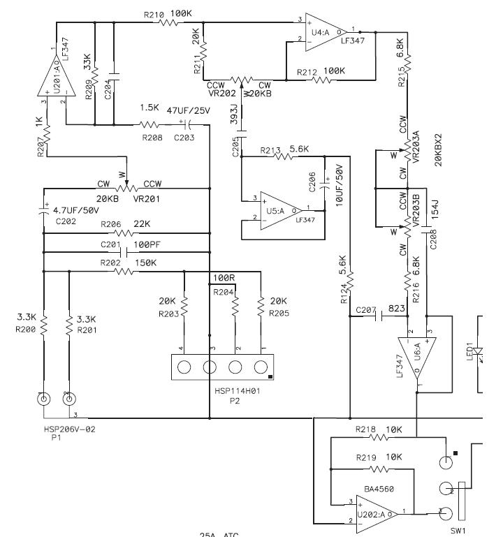

50 hz booster circuit for subwoofer
18db of boost requires a lot of extra bass power delivery and bass power handling.
18db=63times.
Send in 1W to the normal speaker and you need 63W to handle the bass boost.
If the main signal goes to 50W on a peak signal you now need 3150W capability in the bass department.
I got the circuit.
Now i want to know more about this circuit design.
I think U5- A is used for 50hz boost purpose.
What formula is used for this?
If i want to change 50hz boost to 70hz?
