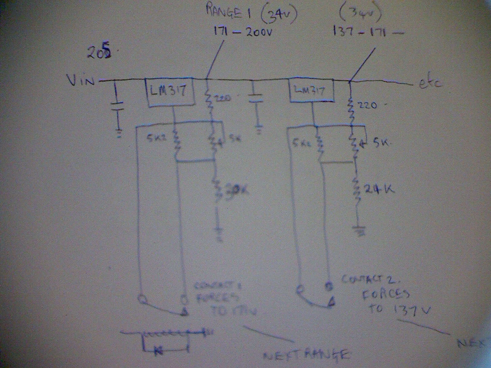

Hi Joe
This one possible method, and a overall pass transistor is another good method, but since I kicked this reply off I should clarify the use of multiple regulators.
This is what i had in mind with LM317 Regulators where 5x LM317's will give the range you require, however with some gaps between each setting.
So we then need a switch and a relay is ideal with sufficient poles. Purpose of the relay is so you cannot switch the voltage at its maximum from the prior relay, a short across the variable for each range is all that is needed.
See attached schematic showing first two ranges. The schematic shows variation of 16v possible 2600 ohms approx, so if using 5x regulator there is a gap of 18v when switching the next regulator range down. Hopefully this is not too much of a problem.
If set between adjustment and output is 220 ohms we can then design 200v to 50v ( your design requirement ) . being totally adjustable through the whole range by using 9 x LM317 but parts cost goes up.
If you do not mind some gaps and allowing for approx 34v between each we can get away with 5 regulators, in this case the lower resistor is arranged to have 6k gap ie 30k,24k,18k
12k and 8k2
Arrange a input and output capacitor using 1uf 300v on the first regulator. A TO 220 case LM317 when looking front on has its far left pin as adjustment, its output is the middle pin and its input far right
With an LM317 we cannot exceed 37v between input and output. To calculate any given output we use the following formula 1.25x R2/R1 +1 there is also a current term to consider however it is minor in the overall calculation. So R1 is 220 ohms if the lower resistor is 30k we then have a range of 171v to 200v, the second 6k away is 137-171v allowing 34v between each and if the variable is shorted we are observing the requirement of 34v between each regulator.
This is one possible option, parts cost is not too high. Cheers / Chris

I copied your schematic diagram together with your valuable info and will study this.

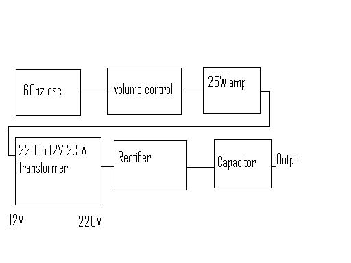

what about using tubes after all jogris has some nice schematics available .
Verschiedene Roehren-Netzteile und ihre Schaltungen
for the amperage your needing a transformer from an old tube radio is enough
http://www.jogis-roehrenbude.de/Roehren-Geschichtliches/Roehren-Netzteile/EL86-Netzteile.pdf
tubes are cheap PL84 is identical to el86 and will supply about 60 milliampere take another tube and some zener diodes and incorperate an error amplifier
the materials are easy to acquire if your having trouble i might be of assistance
one thing to note is that a solid state solution is gone in a snap while a tube will put up a considerable fight . 😀

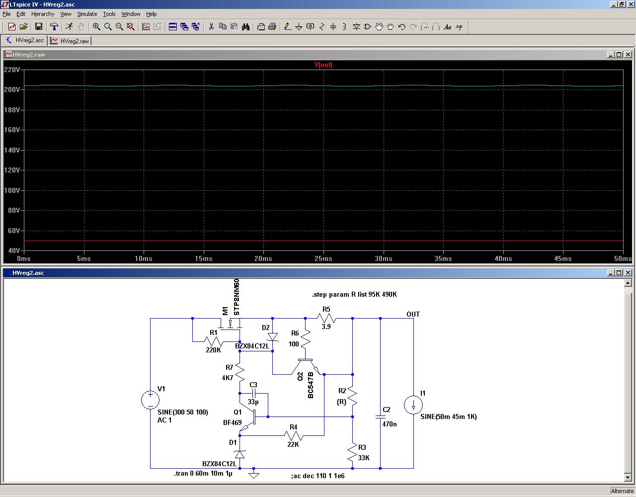

This regulator can be adapted by making R2 variable between ~100K and 500K.Hello,

Performances are pretty mean, but since you need no regulation, that should be sufficient.
Thank you very much Elvee for this circuit diagram.
At first glance I suppose the Mosfet M1 is the current limiting part of the circuit?
If the current though R5 exceeds a certain value then collector current of Q2
flows through R1 which starts to decrease the Vgs voltage of M1 increasing the
‘on’ resistance of the Mosfet. Hope this is correct?
I will analyse this circuit using LTspice (which you did also I see) to get more insight.
Joe.
M1 is the ballast element, it does the voltage regulation, and optionally the current limiting, under the control of Q2.
If current limiting is not required, you can drop Q2-R5-R6.
You can also create a foldback mechanism, to reduce the dissipation when limiting, by tying a resistor between Q2's base and M1's drain.
See the thread "Simple HV series regulator" for an example.
I do not have a copy of the .asc file on this computer, tonight I'll be able to post it (it is not complicated anyway).
