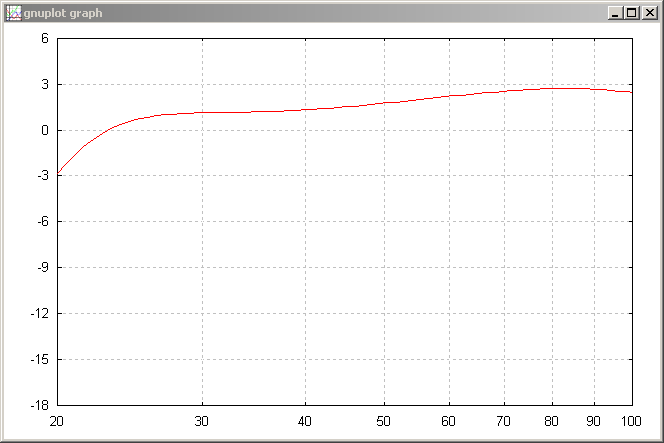

iz said:put the xls's in sealed Vas enclosures..... if it's the 10" XLS the enclosures should be 89ltr. pr. driver....
That's about a three times bigger box than recommended by Peerless. Have you modeled that alignment and looked at the FR response curve?
I made a sub using the same driver but with the 400 gram PR. The box is 26 liters after you subtract for speakers, shelf braces, etc. I used 3dB boost at 21Hz on the plate amp. The attached plot shows how it models with the boost included in the calculation. In the room where I use it, it's pretty darned flat to 20Hz.
I am completely satisfied with it.
With the 265 gram PR in the same size box with the same EQ, the modeled response is very flat to about 28 Hz, then falls of precipitously below that. I thought the gentler rolloff with the heavier PR would match up better with room lift. That's why I went with the 400 gram version.

simon5 said:My final idea is to forget the PRs.
Why? The driver is designed to be used with the matching PR's.

Try this: Put two drivers and two PR's in the 50ltr box. Add weight to the PR's to bring them up to about 400 grams. Use 3dB boost at 20 Hz.
