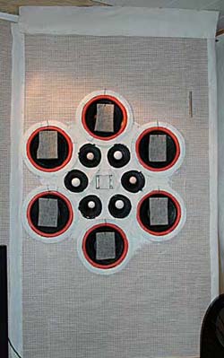

Or six? Arranged in a circle with the full-ranger in the middle?
something like that ? (from Linkwitz links)
