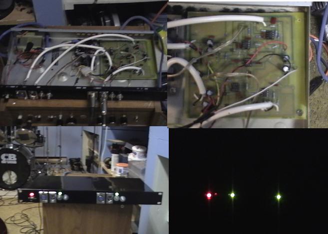

I just finnished Building a 2 Channel Full featured version of these Preamps......
I made it with the Protection Diodes and the DC Offset controll Loop and with Phantom Power and even added a Ballanced output stage so I get a ballanced output......
As for Input DC blocking Caps I just used some OK quality 100uF 63v electrolytics Bypassed with some 1uF and 0.1uF Mylar Caps which are the only caps in the Signal Path......
I am also use a regulated +/-15v Supply with +48v.......
This preamps sounds Great ......and Looks Good Too....
Cheers
Cheers
