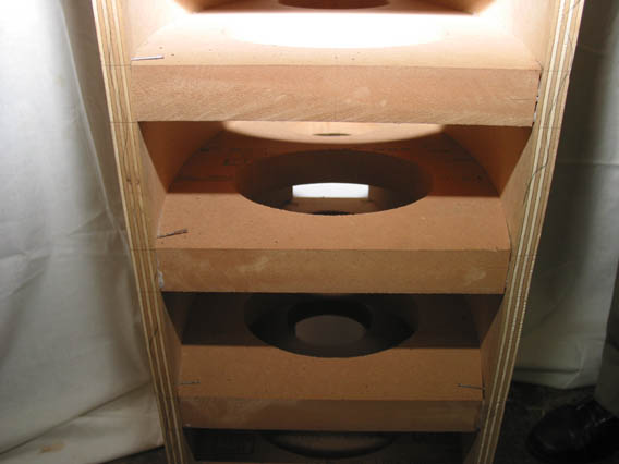

sand filled is a very nice concpet but i found it diffcult to execte because it was diffult to keep the 2 wood layers independant. somewhere they had to meet.
so i decided to use curved sides to pre stress the wood and to form non parallel sides.
i also used ply - mdf combo.
see pic.
see pic.

I do not see this as a problem: For the top of the enclosure such large dimentions are welcome, as they will permit very gentle sloping backwards, for baffle difraction and aethetics. Think Thiel...
http://www.thielaudio.com/THIEL_Web/Web_Page_Images/CS7_2_page_images/7_2prnb.jpg
For the bass: Well, if I use 10 inch drivers, then my baffle will be at least 21 or so inches wide. This goes againsed current trends of thin front baffle and huge sides, but I think I know how to make it work. Further, something like Zebra wood veneer can be used to excentuate the already wide horizontal span. True, these things will be huge, but then again, I do not have to appeal to a mass market, just me... Just to clear things up, the sole intention of this is not simply to avoid bracing, but to add mass and more mass.
In all reality however, 5 inches is just a hypothetical number chosen for discussion. It may work out just as well with, say, 3 inches and some Black Hole...
I tend to agree with Sreten in that it isn't a good idea to make excessively thick walls to avoid the difficulty of bracing. As was mentioned by Mark, it is about balance of tradeoffs.
Comercial speakers often don't include fancy construction techniques due to the extra cost or manufacture, the ones that do are usually quite expensive. Some may disagree, but I think B&w tend to make boxes that are fairly complex in their construction relative to their cost. However, when it comes to DIY it makes sense to "do more with less." We have the luxury to build boxes that are more elaborate, to make TL's and horns, or very inert boxes with elaborate internal structures to get rigidity. But to reinforce an earlier point, if you make your box too heavy, it becomes very difficult to work with and to move around, something that a DIYer will want to do a lot.
I have heard of people using the CNC router idea, but if you do that at high cost you start to kill the advantage of DIY. Why do this when you can get the same result in other ways.
Here are some good examples of making curved timber speakers by various means:
curved speaker construction
For making a curved box, the layered lamination method looks very promising. I had previously planned to build a curved subwoofer with this approach, combining matrix bracing, constrained layer damping. I would have used two curved skins bent around horizontal bracing pieces carefully cut by router at vertical increments of say 200mm. The skins would be connected to each other by liquid nails. Internal skin would be 18mm, external skin 12mm. The skins would be made of 3mm sheets laminated together laid one at a time. This allows them to bend and form a continuous curve forming the sides and rear of the box, joining at the front corners of the baffle.
I'm not sure if these images will work:
If that doesn't work, they can be seen here on my site, also with a brief description:
Curved subwoofer construction on my website
Please note: this design was not fully resolved, and for the time being has been shelved.
regards,
Paul Spencer

I like the gasket idea and not screwing things in tightly. I have done something similar with blutak on my mids cabinet but nothing on the tweets as I didnt think the tweeter would cause anyting to vibrate. Hmm I guess I was wrong, now where did all that spare rubber go.....
My speakers are three way, all the drivers in separate boxes, with translam on the mid and tweet enclosures. Tweeter more for an aesthetic match to the mid. Either way if I touch the tweeter enclosure when the music is playing (this doesnt have to be loud) you can feel it being shaken quite a lot by the other drivers movement. I put some large cell bublewrap between the tweet and midrange cabinet and they ALL (this is no joke I was surprised at how much this worked) dissapeared. Listening was also better, vocals sounded smoother and more airy, everything sounded more relaxed or just flowed from the speaker more easily. It sounded kinda like you would expect it to, just improving the high frequencies. Which subjectively improved the rest of the sound.
I agree that separate boxes are the way to go, with different construction techniques for each box.
amo, doing 5-inch walls is OVERKILL! In my opinion, anything thicker than 1.75-inch should be reconsidered, unless of course, you're making a subwoofer box with two or more 18-inchers. I think the best solution is to use a composite of materials (layers of stuff sandwiched together) to deaden the cabinet. MDF is usually the material of choice for most DIYers and commercial manufacturers, but when two relatively thin panels are combined with, say, a layer of foam, you'll achieve better results with less weight. Of course, don't expect to get away without bracing this kind of cabinet.
Good luck.
Good luck.
I saw and listened to the TAD speaker at the audio show here in S.F. It was built out of stacked layers as described. There were metal rods vertically clamping it -presumably it's glued also 😉
All thread would wwork well for this.
It's a method of making cabinets I've considered a lot. $600 for materials and cutting might be a pretty good deal. 5" walls are going to be a problem because the may block sound from the back of the woofer a bit. The walls of the TAD were about 2.5" to 3" I think. Some of the layers had Y shaped bracing between the walls. From my inspection there were say 3 layers with braces, the a bunch without, then more braces.
After seeing and hearing the speaker, I'd say GO FOR IT!! but walls like TAD uses are probably enough. The only problem with thicker walls are that the speaks will be HUGE and material cost.
The TAD "head" with the combo 3" mid and 1" dome (both Berillium) is mounted on firm but flexible material to decouple it from the bass box exactly as mentioned above by 5th Element.
The speakers were some of the more impressive I heard- especially for large scale stuff like symphonic music
- 5 inch walls?
