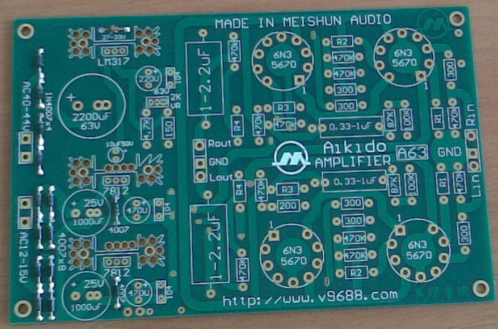

Hello guys, i bought a 4x6N3 preamp board. It is made by Yuan-jing, and the seller did not give any schematic, anybody can help me to understand what kind of preamp it is, or if somebody has a schematic ill be more than happy.
I have used it and is working, the board has 2x AC power inputs, one 12-15V AC and one 30 - 44V AC, From what i saw it is using 2x7812 for filaments, and one lm317 for anode curent limit.
I will attach the image of the board.
Hope i can find some help here.

Difficult to say exactly whats going on--without schematic...
Possibly two SRPP stages capactively coupled, although would have thought 40V +B was a bit low for that........
Dunno--Email seller, ask for schematic!

Its 40v - 44v AC input probably followed by a x4 multiplier. Which could give approx 220v DC.

Not enough caps for voltage multiplier.
The smaller cap has an 80V rating. Looks like FWB followed by the large cap. Probably 60V B+.

Thank you all for fast answers, the big black cap is 220uf/63V.
I had measured and between anodes and Screen( which is Ground) i have 41V dc and 29V dc on each triode of the double triode pack.

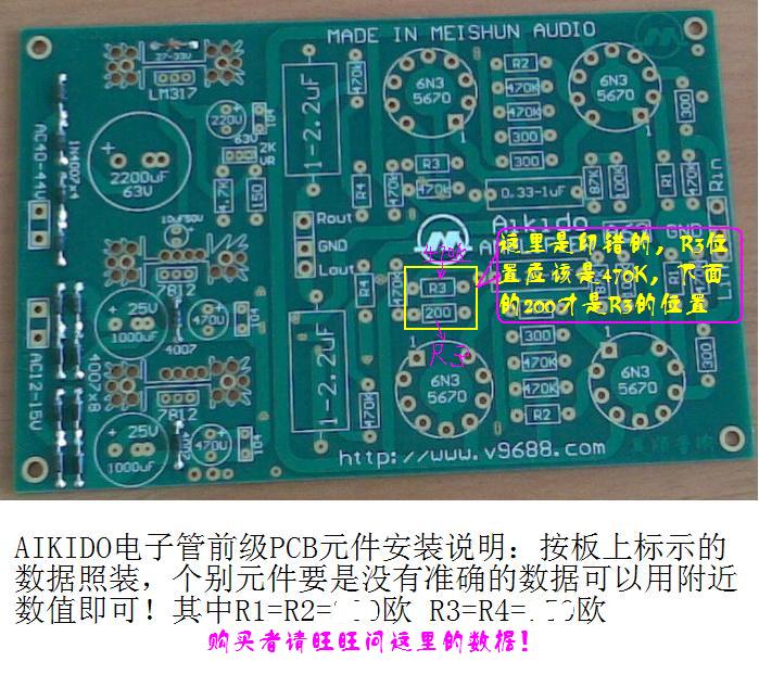

This is the one! Thank you Koonw !
This look like the one. Thank you for help and, may be will help others in the future.

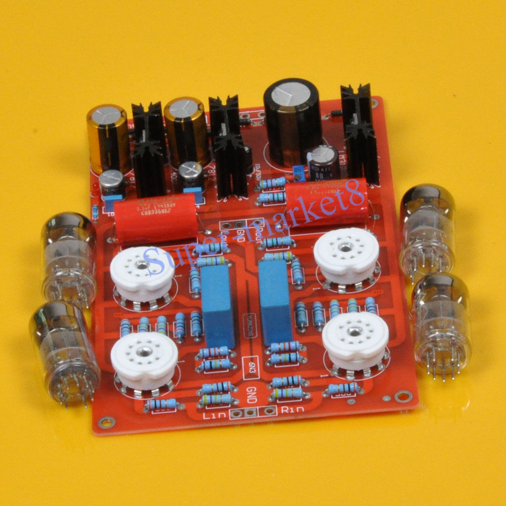

I've received my board. Looks like yours, but the electrolytic caps and some resistors should be replaced.
The mystery for now is the plate voltage. In my board the plate voltage seems target for 48,5 V. The capacitor at the LM317 output is rated for 50V, but I'll check the tube graphs in the datasheet.
A previous check should be done to evaluate the possibility of a higher plate voltage and it's consequences in this circuit.

The plan includes a 71V/8200uF Nichicon LKS after the rectifiers plus a 330uF /63V Nichicon Fine Gold after the LM317 and an Elna Silmic II 10uF/100V at the control pin of the LM317.
New caps for the heaters power line; Nichicon KW after Graetz rectifiers and Fine Gold after 7812 regulators. Also the two 1uF MKP capacitors at the noise rejection block are to be replaced by 2 WIMA MKP 1uF 250V.
Nichicon LKS "Beast".
A little mode at the value of resistor after the voltage pot can get the voltage at 62V for the plate. All 470K resistors will be replaced by 1% metal film 1/2W, as the R5 (82K) at the noise rejection line. All rectifiers are 2A/600V ultra fast type.
Four General Electric GL-5670 are ready to operate in the PCB, but first I have to measure the amp gain, check distortion values and overload margins at the input.
