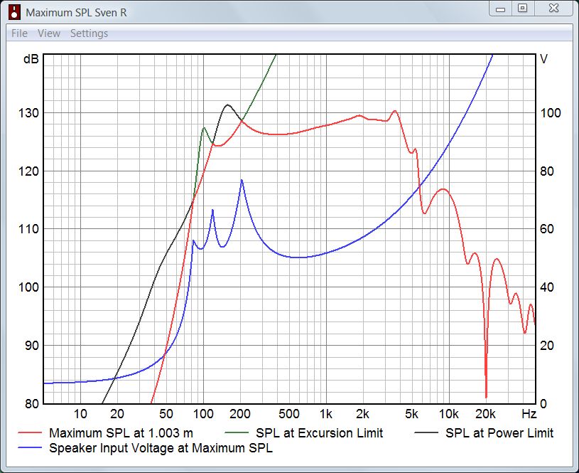

Hi Sven,
I made a simulation of your speaker. A closed box of 23 litres without crossover:
The SPL at 2.83 volt/1m is more than 100 dB, but the impedance is only 3 ohm.
The maximum SPL is above 125 dB, but the power is 800 watt:
Below 200 Hz the SPL is restricted by the maximum linear excursion limit. A vented design can boost the range around the tuning frequency, but it is worse at lower frequencies:
The drivers only need a volume around 5 litres each, and the vent is 128 mm diameter and 75 mm length. I'm not familiar with high power PA and wonder what happens, if you feed 800 watt into such a small 20 litres box. Probably you need much more vents for cooling purpose!

If you're only going to take them down to 150HZ, I'd use a closed box design for better and more consistent (over frequency) physical damping. Ports can become un-tuned over time, as the drivers age. I'd also see if they wouldn't work fine down to 100HZ since the male talking voice is usually around 110HZ according to my own tests.
Using a vertical line array is a great idea. It's acoustic output drops off more slowly as you distance yourself from the cabinet, and the vertical off axis response will roll off significantly faster than with a single driver, which means significantly less floor and ceiling bounce, which often causes severe (10dB) comb filter notches all across the spectrum in a typical listening room.
I would hesitate to go much above 1kHZ for the upper crossover point, since the horizontal off axis response will roll off in a way that won't integrate well with the tweeter, which will probably have much wider dispersion when it comes in around 1.5kHZ due to it's small physical size. Any abrupt frequency response anomoly between about 800HZ and about 6kHZ is particularly difficult to listen to since that's where our ears are most sensitive (see Fletcher-Munson curves).
