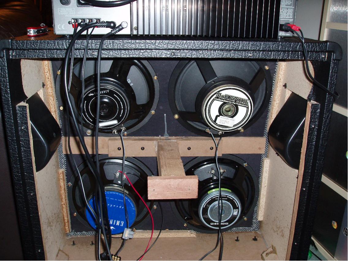

As promised, here's a photo of what's inside so far.
I simply went for the cheapest speakers from reputable companies - some are second hand and I got those for next to nothing.
Total speaker cost: £70.
Going to try putting the back on when I work out how to get the connections right. Probably will go for a 4-pole speakOn, to make use of both channels of this amplifier.
I'm going to try playing with the back on for a while, see how I like the sound for bass guitar.
Chris

Right, for now the 2ch amplifier I was using for this has been re-installed in my stereo, so I'm using a 60w (at 4ohm, so I'm only getting 30w) guitar head.
Sounding a little bit warm at the moment, but plenty of oomph with the closed back: I don't think I'll be going ported any time soon.
Next thing to do is work out the characteristics of each speaker and decide (HELP!) which one to put where.
