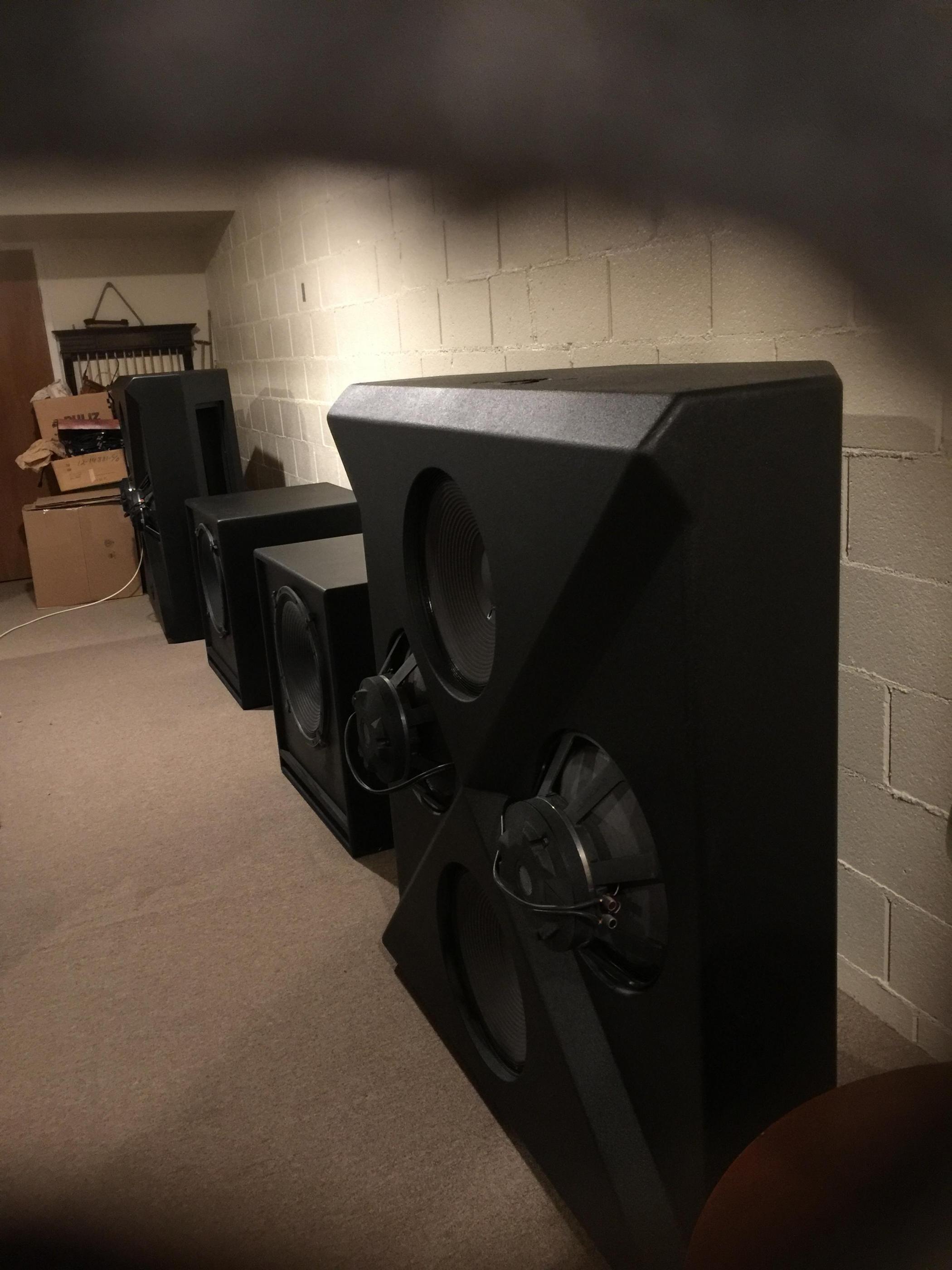

done and playing!
~260 pounds per cabinet.
-90 pounds 1/4" thick metal plate on top cover, double thickness on bottom.
-double front and rear baffle. Plywood.
-plenty of internal bracing
-serial/parallel wiring arrangement (8ohm, 105db efficiency)
-Sealed, of course
-initial crossover actively set at 50hz-500hz (as per previous dual 15")
WOW, subjectively much better than the previous dual 15" version I had.
bass doesn't "seem to trail the compression driver" like it did. It just does dynamic effortlessly with assurance, drums are the most realistic I ever archived in my years in the hobby.
I remembered from single to dual 15, the step in perceived dynamic was important, going quad bring it up more step, almost tempted to go octal
Will need to tweak DSP and will eventually post measurement on my website.

Hi, can't view your pics from Wix. Could you upload at least the latest one on here please
It shows on my browser.
That is strange, not sure what to do here.
here a quick link
new quad 15" bass bin - Fane 15XS colossus prime (4x15")
- 4x 15" bass bin, push pull arrangement
