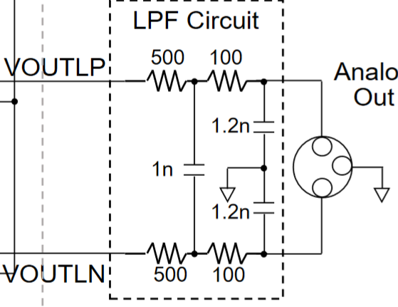

I'm designing a DAC + HPA based on TPA6120 with the XLR output level of 4Vrms and PSU voltages of +/-15V. I'd like to use TPA6120 in a differential configuration (see attached TPA6120 circuit) taking an input differential signal directly from the XLR output after a XLR LPF (see attached XLR circuit).
I noticed that the absolute maximum differential input voltage rating for TPA6120 is 6V (see attached TPA6120 Absolute Maximum Ratings table). I assume it's 6Vpp, not 6Vrms.

But the differential voltage is tiny/zero as the TDA6120 acts to ensure that - assuming its powered up of course.
With two antiphase signals of 5.64V p2p, they both vary from -2.82V <-> +2.82V w.r.t. ground, since 2.82 - -2.82 = 5.64. But again the amp chimp doesn't see the differential input voltage, its sees its DC offset voltage modulated by a tiny fraction of the incoming signal.

It's neither, it's just 6 V maximum differential voltage. That is, at no time should the voltage between the pins exceed 6 V in either direction, so the maximum allowable peak-peak voltage is 6 V - (-6 V) = 12 V if there is no DC component.
Anyway, it's all irrelevant because of what Mark wrote.

Thank you for clarifying things! Is it because TPA6120 has a closed feedback loop, so it maintains the differential input voltage at zero volts, correct?
After your explanation. it makes more sense to me, thank you! I've missed the point that both of those voltages are +/-2.82V w.r.t. ground, so the max differential amplitude between them could therefore be 5.84V only.

I think you are confusing peak and peak-to-peak.
4 V RMS differential signal means that the difference between the two voltages is 4 V RMS. If everything is symmetrical, you have 2 V RMS at one output and 2 V RMS in the opposite phase at the other output.
For a sine wave, 2 V RMS corresponds to 2√2 V peak. Hence, each output varies between -2√2 V and +2√2 V momentary voltage.
The peak-to-peak voltage at each output with respect to ground is then +2√2 V - (-2√2 V) = 4√2 V. The peak-to-peak differential voltage is twice as high.

Ok, I think I got my mistake. I was missing the fact that momentary voltage between peaks on + and - lines swings between +2√2 V - (-2√2 V) = +4√2 V and -2√2 V + (-2√2 V) = -4√2 V since they're in anti-phase. This, in turn, gives +4√2 V - (-4√2 V) = 8√2 Vpp which equals to 4Vrms.
Now, it seems right to me that if I'd make both the + and - lines to output 4√2 Vpp each this would correspond to the 4Vrms XLR spec. Previously, I thought that for the 4Vrms XLR spec, I'd need both the lines to output 8√2 Vpp each.
So basically, signal level on all lines of 2Vrms RCA and + and - of 4Vrms XLR have exactly the same voltage w.r.t. ground while, at the first glance, the lines of the XLR output seemingly should have double the voltage of the RCA output line, but it's not actually true.
This also explains why a RCA LPF generally has a gain of 0.5 if its opamp inputs are connected to an XLR output if a device has 2Vrms RCA and 4Vrms XLR outputs.
