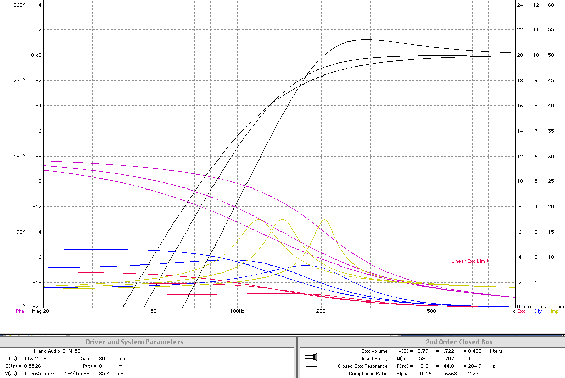

Well, unless the satellites have a flat impedance at 100Hz (very unlikely) you're unlikely to be high-passing them per se with a nominal 100Hz cap based on either the nominal impedance or the Re nominal. You're more likely to end up with something essentially similar to the old trans-cap approach of squeezing more extension out of an acoustically undersized sealed box by having the series cap interact with the rising LF impedance & thereby boosting output around those frequencies. Assuming you don't want to heave a large input LCR Zobel across the speaker (large components = expensive. I've done it, but it costs) passive filtering is problematic at these frequencies & you'd likely need to go active to actually get the sort of rolloff you're aiming to achieve.
I specifically have in mind Tozzi One, ScanSpeak 5F, and Markaudio CHN-40 (both in sealed cabinets).
Would you recommend 4th order active slopes? I believe Marchand may have an appropriate kit, although probably not cheap.

Tozzi One is not a great box, have a look at the CHN-50 (what is in Tozzi) in a better box.
