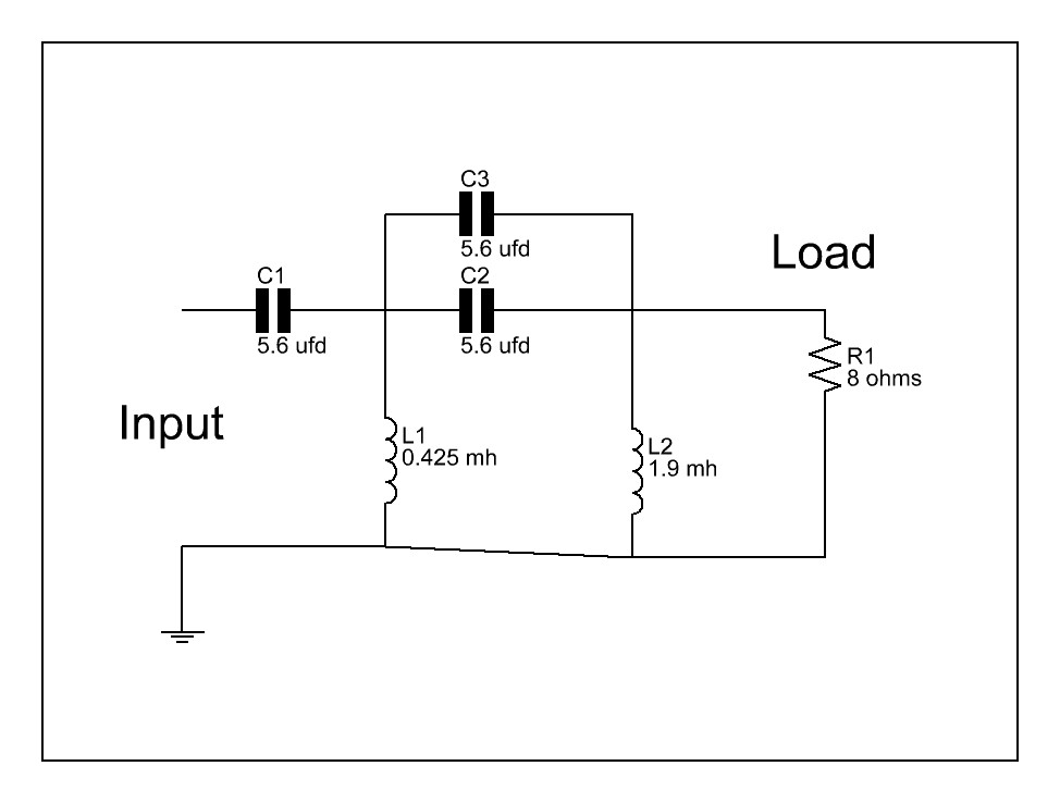

Herewith attached the circuit.
It is linkwitz 4 th order.The inductor values are mentioned on PCB.
I hv not included the L pad circuit.
I hv tested this with DAAS 32 & used 8 ohm resistor as load.
By right quick on graph we come to know the attenuation & frequency.
The graph is linear ( no bump or notch) & proper.

As long as the test resistor is non-inductive, the curve should look textbook and be at the predicted crossover frequency (within the tolerances of the components).
However, your speakers (drivers) are not non-inductive resistors.
This is probably why the performance varies so much.

i have not attached the driver to this circuit.
All tests have been carried out with resistor load.
I think that the drift is due to component values as Loren42 say.
The capacitors are +/- 5% & drift is almost more than 15%.

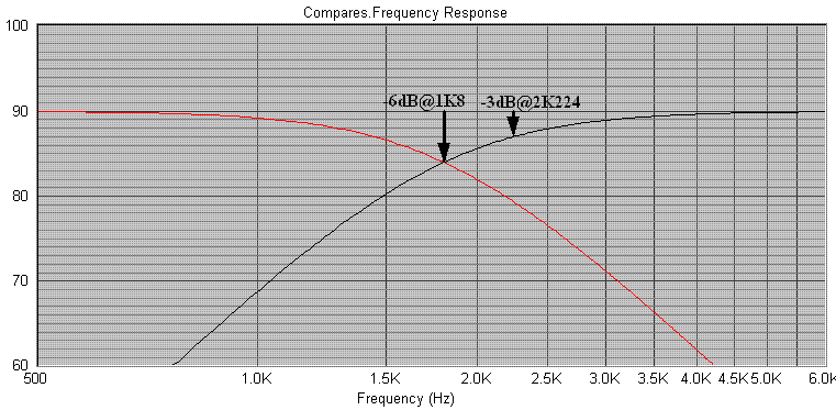

Oh I see, so you didn't test the driver. Then the drift is caused by component "tolerance", but this drift is not a big deal. The real issue is after you connect the drivers where actual impedance is different with nominal impedance.
The big drift you see on your simulation is because you see at -3dB while you should see at -6dB.
The crossover point of different filter not always at -3dB. For example, 2nd-order LR is at -3dB, 4th-order Butterworth is at -3dB, and 4th-order LR is at -6dB.
Attached is a picture of LP and HP slopes of LR4 crossing at 1K8. As you can see, they are crossing at -6dB. If you look at -3dB the corresponding theoretical frequency should be 2K224.
Now you want to compare 2K224 with 2K4 of your measurement. Is that a big deal? No. But if you want to argue, first measure your load resistor. If your load resistor is below 8 Ohm (e.g. 7.9 tho rarely) then you will expect a higher frequency than 2K224.
