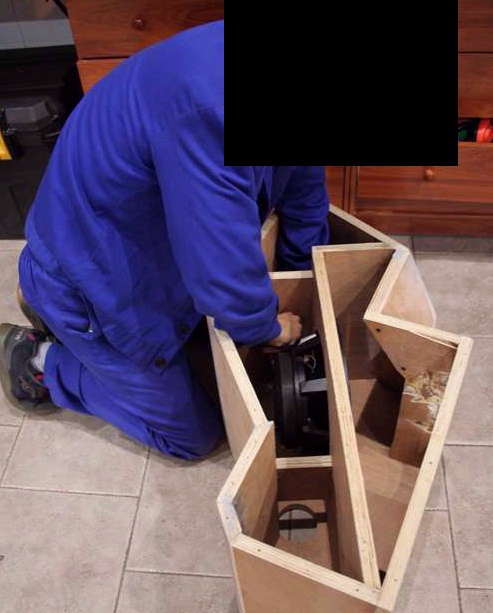

There are probably far more happy owners of my custom bandpass enclosures out there than there will ever be of yours.
You are going to fail. No more free advice, except that I find everything that MTX and other classic brands are currently making of very little use.
The first example that came handy...
