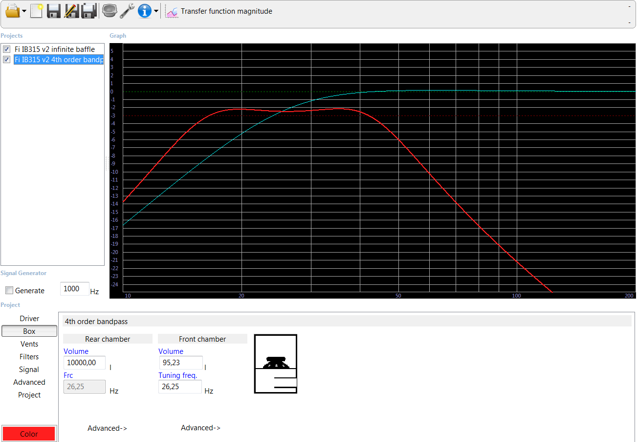

You are an absolute god send. Thanks so much for the help. I’m thinking I shoot for that flat response wave by tuning to 26hz. I used Lv = ((94250 * R^2) / (fb^2 * Vf)) – (1.595 * R). So with a 4 inch round port R=5.08cm I got a length of 30.2 cm or 11.88 inches.
I would use flared ends to avoid chuffing. Can you run this in your model and see how it looks. Box volume is 95.23L.
Flaring is a good idea.
4th order bandpass, infinite rear chamber, 95.23 L front chamber tuned at 26 Hz:
-3 dB response is from 14 to 48 Hz. That will boom hugely if you factor in cabin gain. With a 4" (10.2 cm) port and 500 W of power the air speed inside the port will be 48 m/s at 20 Hz which is way too much. With a 15 cm diameter diameter port 😱 it is 22 m/s. That port would have a length of 70 cm. If it's too boomy, you can shorten the port to get more 'upper' bass (50 - 60 Hz). You would need separate kick bass units to cover say 48 - 150 Hz.
I would go for an infinite baffle setup and let the woofer fire through a hole as large as you can cut. That will remove the need for kick bass units playing down to 48 Hz as the woofer can play up to a higher frequency, result in a smaller 'cabinet' (as there is none really) and removes the need to fit a large port. See attachment, red is bandpass and cyan is infinite baffle.
