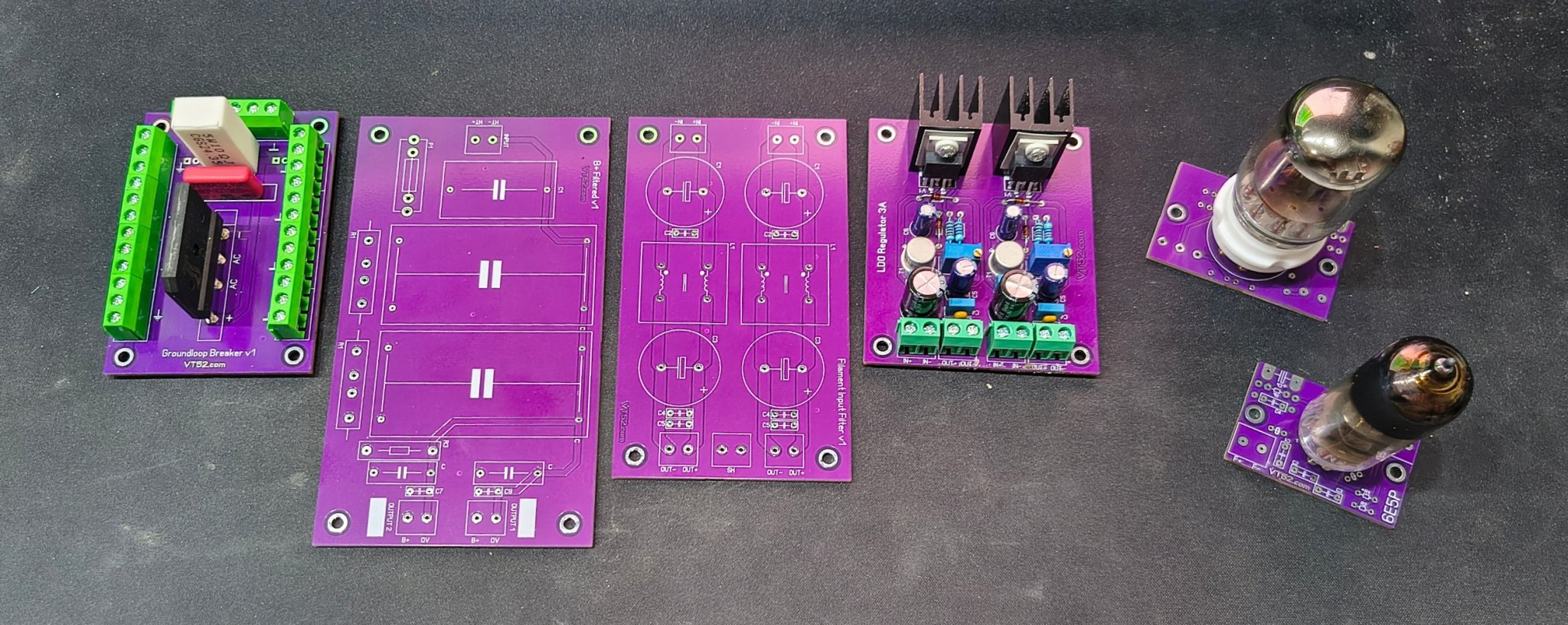

Hiya,
Been posting some pictures here and there of a new project I have started on, might as well share the whole thing. The idea started in 2018 for a regular amp (speakers), but life happened and I lost track of audio once more. The good thing is that I already have some parts that I can re-use, so in today's thinking "they are free".
Goal:
  • Headphone amplifier, 35 ohms
  • Tube, single-ended,1000-1500mW of raw power power
  • Daily beater, so no rare tubes, nothing end-game, just good music and a cool looking piece of kit
  • Must fit on desk and desk must not collapse
Tubes:
  • 4P1L
  • 2P29L or 6E6P, might also look at other wee tubes like 6Z49, 6C4S, 5842 etc

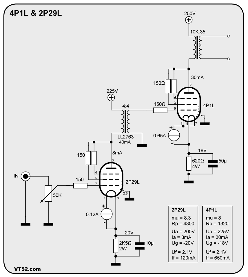

As I want to tinker with the driver tube a bit, the power supplies will be setup to be universal for a 250V output tube and a 200V driver, current for each tube can be up to 50mA with headroom left.
4P1L will run at 225V/30mA/-19V initially (245V/30mA B+)
6E6P will run at 200V/30mA/-3.4V, 2P29L will be 6mA/-20V, so we have 30mA/-20V as worst cases for the PSU (225V/30mA B+)
As I am betting on the 2P29L, the rest of the info will focus on this combination so as not to have two projects in one.
Supply Chassis:
  • Separate chassis for raw DC supplies to conform to the "must fit on desk" rule

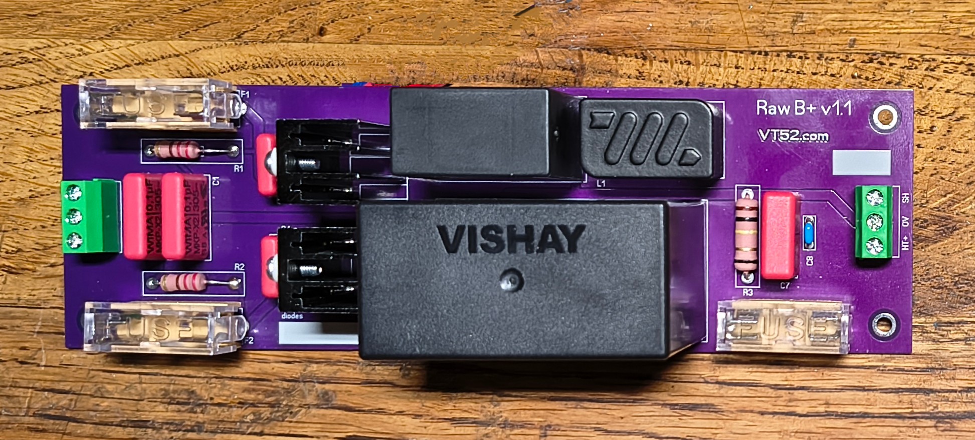

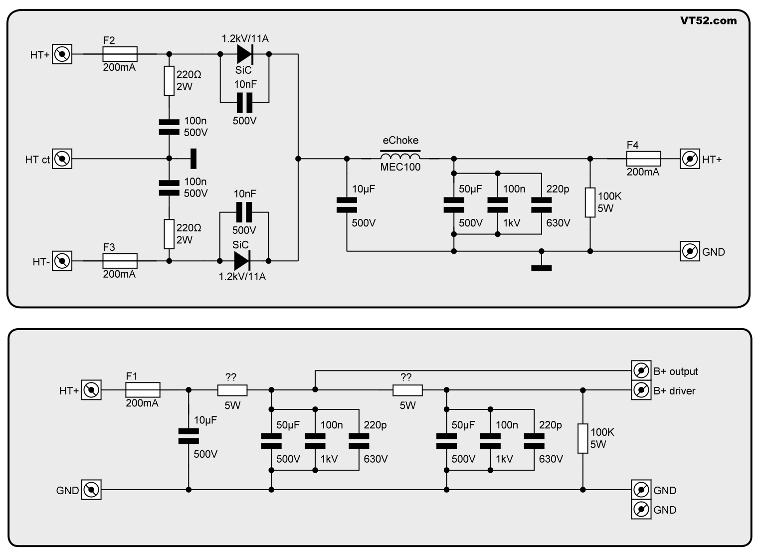

  • PCBs
  • B+ will be SiC diodes, eChoke and MKP caps

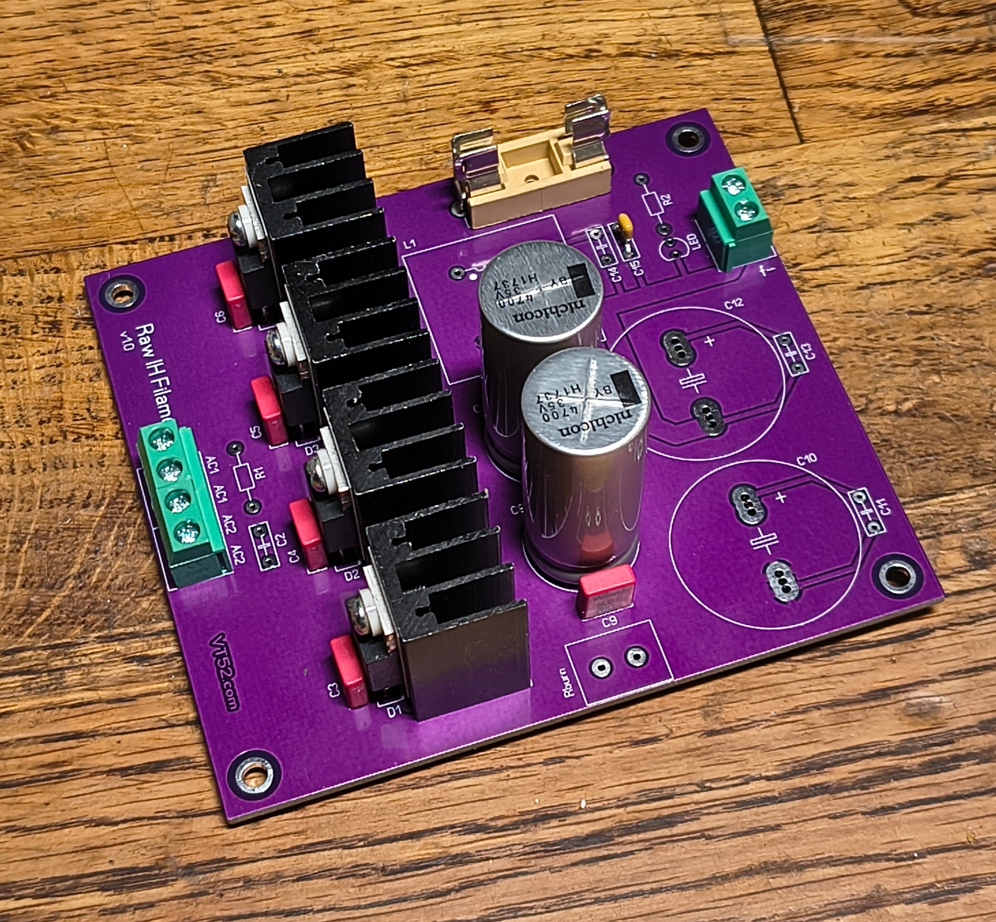

  • Filaments with SiC diodes and FW/KW caps
Signal Chassis:
  • Filter for DH filaments, then Coleman regulator (current source) for DHTs
  • LDO voltage regulator for IHT
  • Passive B+ filter with RCRC to tune for both stages

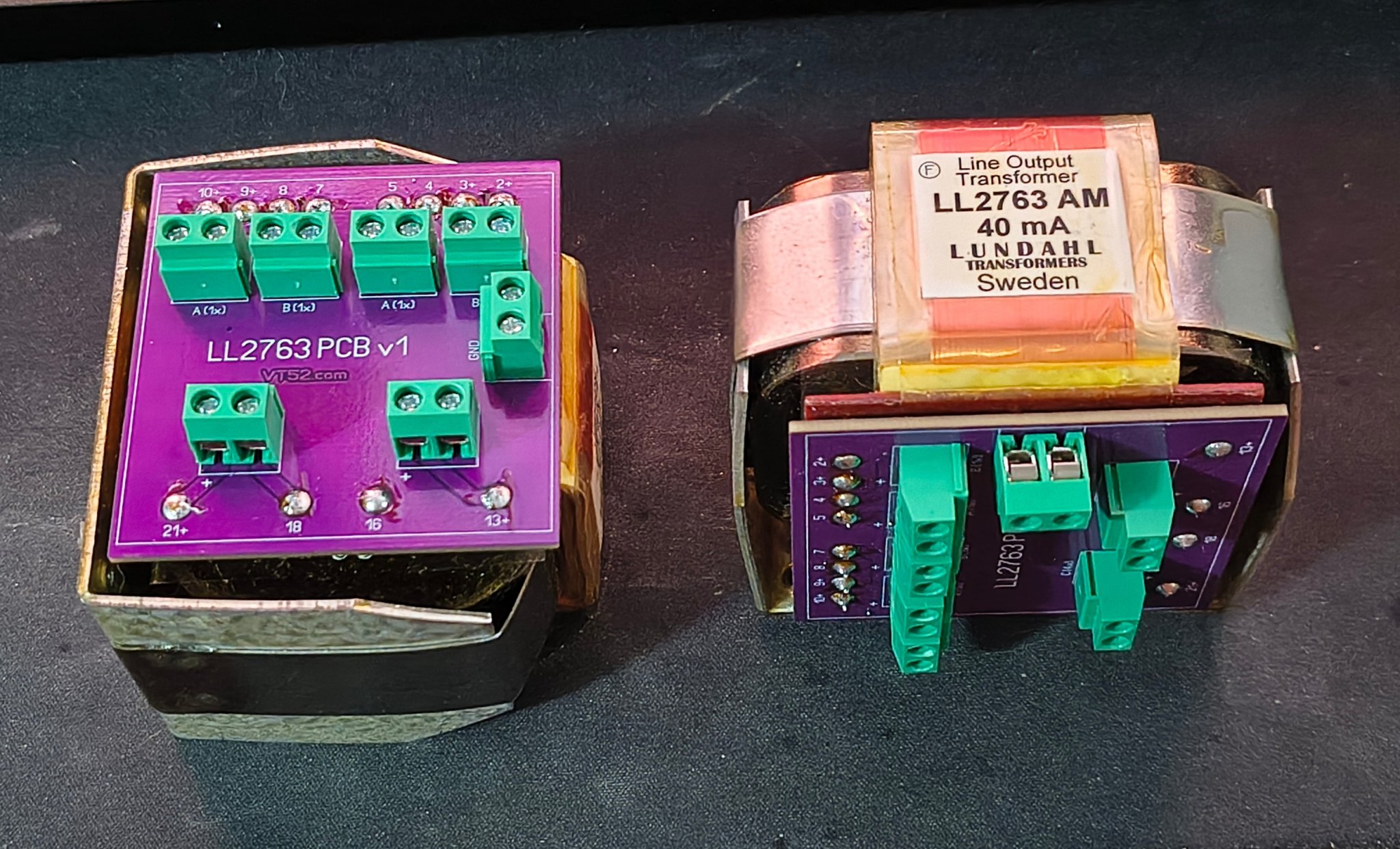

Iron:
  • 2x SE OPT 10K/50mA
  • 2x Lundahl LL2763AM-40mA interstage
signal path

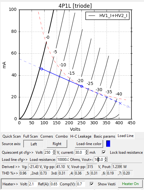

eTracer loadline on one of the 4P1L I have tested. 1.2W max with 10K.

How big is your desk? 😉 Not sure you need any pcbs for this other than the 4 Coleman boards. There will be nothing much to fit on a PCB here. Also, at 1W dissipation, the 2K5 1/2W resistor will be very short lived. Better use 5W for cathode res. I would rather use a nice indirect heated tube like the 6e6p for the input stage and the 2P29L for the output stage. The 4P1L is too microphonic, at least in my hands. Not a very practical tube but maybe I did something wrong and I am going to try it again.
I looked quickly at the lundhal LL2763 and didn't find any Alt to get 1:1 ratio. What connection gives you that?

PSU will be on a shelf nearby, the signal section should fit in a 200x300mm chassis. OK, still not small. Mostly the signal iron taking up space.
PCBs: Yep, this will be all that goes into the signal chassis (2 of the longer ones). and yes, the holes for the large MKP caps are too small, new boards already ordered).
Supply chassis has six boards with rectifiers/caps: 4 of these for the filaments and 2 similar ones for B+ but with 500V MKPs.
When I have the test setup working (wood board) and all the right values etc, I will make a dedicated PCB for the headphone amp. That way I can use the seperate PCBs for future test setups.
I looked quickly at the lundhal LL2763 and didn't find any Alt to get 1:1 ratio. What connection gives you that?<<
Ah yep. there are some typos in there I see. Also the 2P29L has a lower rp. Thanks for catching that! I have a lot of 2W/5W Kiwames, so it was going to be one of those either way. I should just not place wattages, I never re-check them.
The LL2763 can be hooked up in 4:4 even though the datasheet does not list it, but I have to test that. Induction will drop. Else get another IT.

Yes, the 6E6P is already on my short list 🙂 Microphonics should be manageable and I have been used to this in older tubes I ran. There are no speakers to introduce noise, and I almost never bang my head on the table.
I also thought of just using the 6E6P as a spud, but past spud amps have never stayed around for long. The 5842 is also a really nice tube, I always enjoyed that one as a driver and even a spud. But don't get me started, I will never make up my mind 😀 The all-russian theme is pretty cool.
The 2P29L (rp=4300) as output tube is a little on the weak side I think, but I should have some high Z OPTs around to test that out first. 2P29L driver and 6E6P output? 😀
