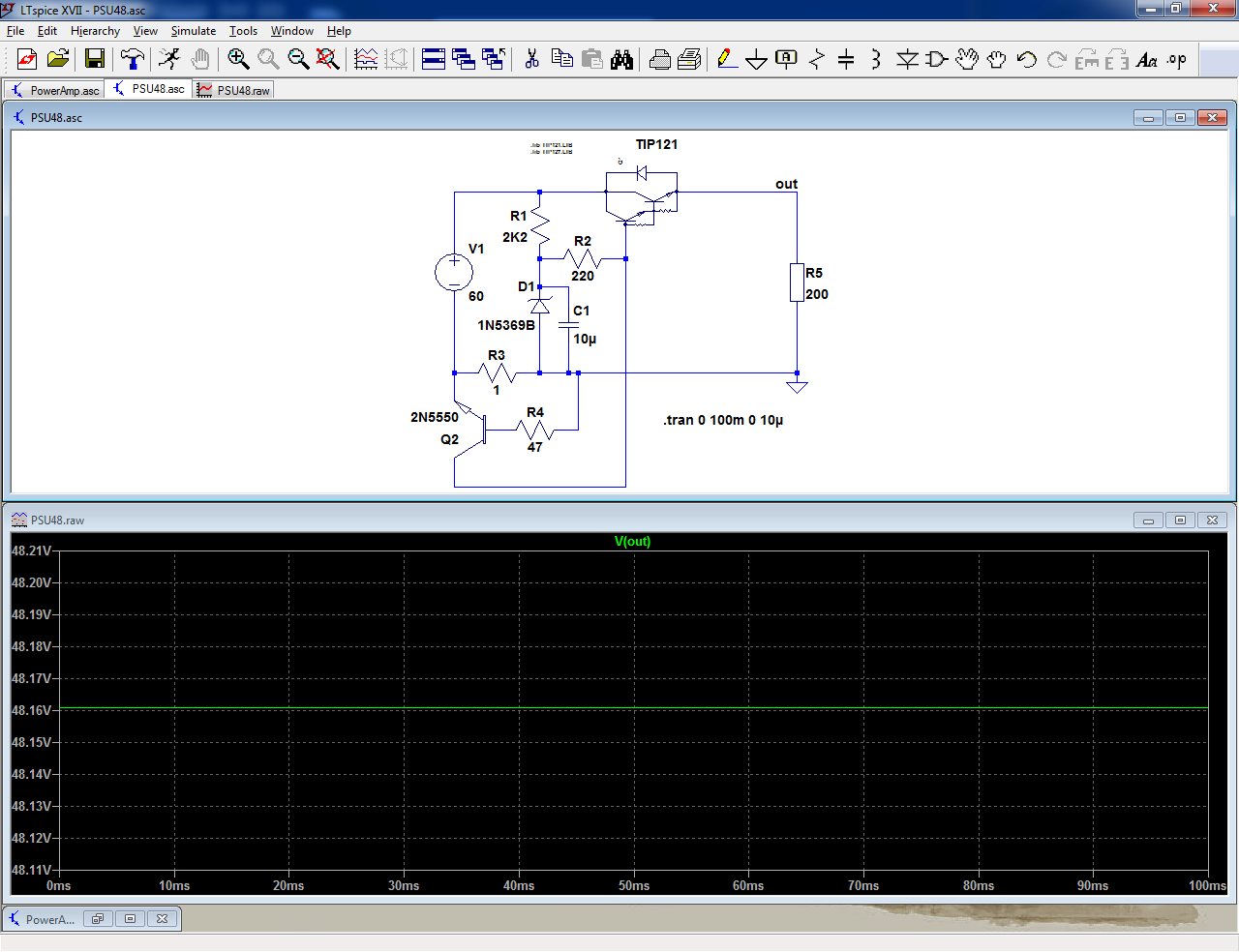

A TL783 is more sensible solution, but if high performances aren't required, a simple transistor+zener reg is perfectly sufficient.
It can be protected if it needs to, and the zener can be bypassed to shunt its noise

Here is an example of simple regulator, equipped with an overcurrent protection and a zener bypass:
