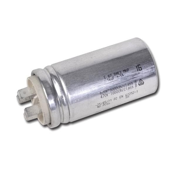

I am building a RH84 V2 EL84 valve amp and need to source a 47uf 450v motor run capacitor and a 200uf 450v electrolytic or motor run capacitor for the CLC Power Supply. I am struggling to find a suitable 200uf 450v capacitor. Should I install two 100uf in parallel or is it better to use a single 200uf?
For the 47uf 450v I am thinking of using this Kemet motor run capacitor
KEMET 46uF Polypropylene Capacitor PP 450V ac ±5% Tolerance C87 Series
RS Stock No. 911-9421 Mfr. Part No. C878BF35460SA0J
KEMET Motor Run Capacitors, C87 Series
C87 Series Polypropylene metallised film with cylindrical aluminium can type filled with resin; faston, plastic deck or cable terminals and overpressure safety device.

It does have 4 tab connections so I am not quite sure how raptors connect it

Out of these two which is the best to use, or should I go with a well known electrolytic from Vishay, Rubycon or Nichicon ?
Finally, is it worth adding a parallel suitable film cap around 10% of the value on these as well or is that not needed or beneficial in the psu side of things.
