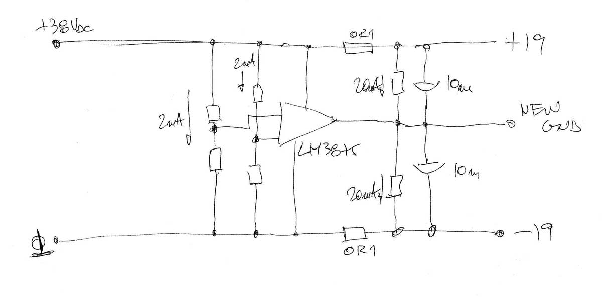

I'm not sure what you mean,by "mid point" do you mean the common between the upper + half and the lower - half? If so I would not remove that connection,just move the ground from there to the negative rail point.Thank you for your help.
If you are uncertain about the idea of creating a mid point in your amplifier circuit, then it would be best to not try the conversion.
Perhaps it may be simpler to show the precise schematic (along with your proposed modifications) for the PSU you're considering along with the schematic for the amp circuit.
You want to have just a unipolar 46V power supply (only "+" and GND), right ?
Not bipolar and no GND in the middle ...
The only potential issue I see with your solution from post #7 could be the choke in the "ground" / 0V line ... don't know if that would create problems.
Regards, Claas

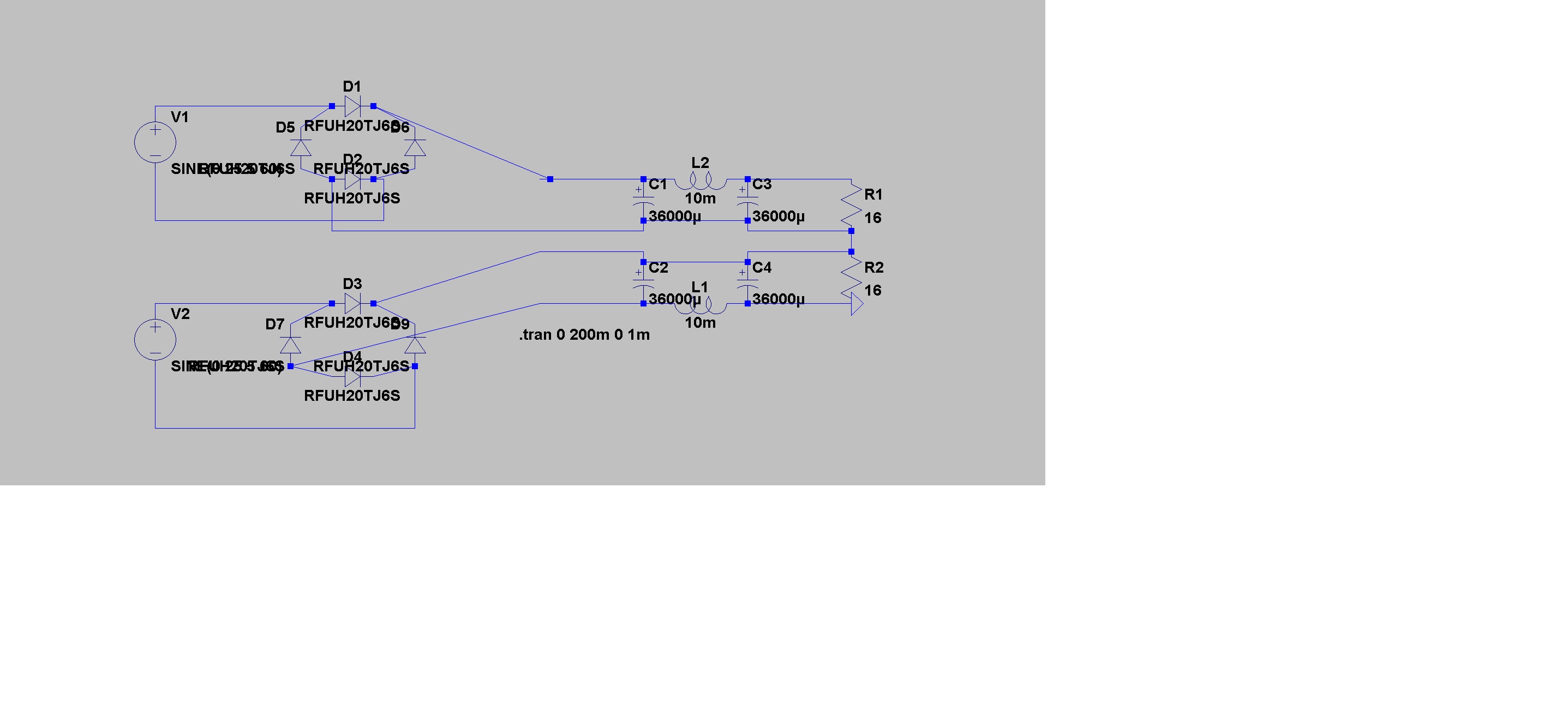

This is what i am talking about.So this is a no no.If so i'll think about a switching supply.
This would be fine. The two floating supplies are joined only at their outputs, plus to minus,
with no other connections. It does not matter in which branch the inductor is located.

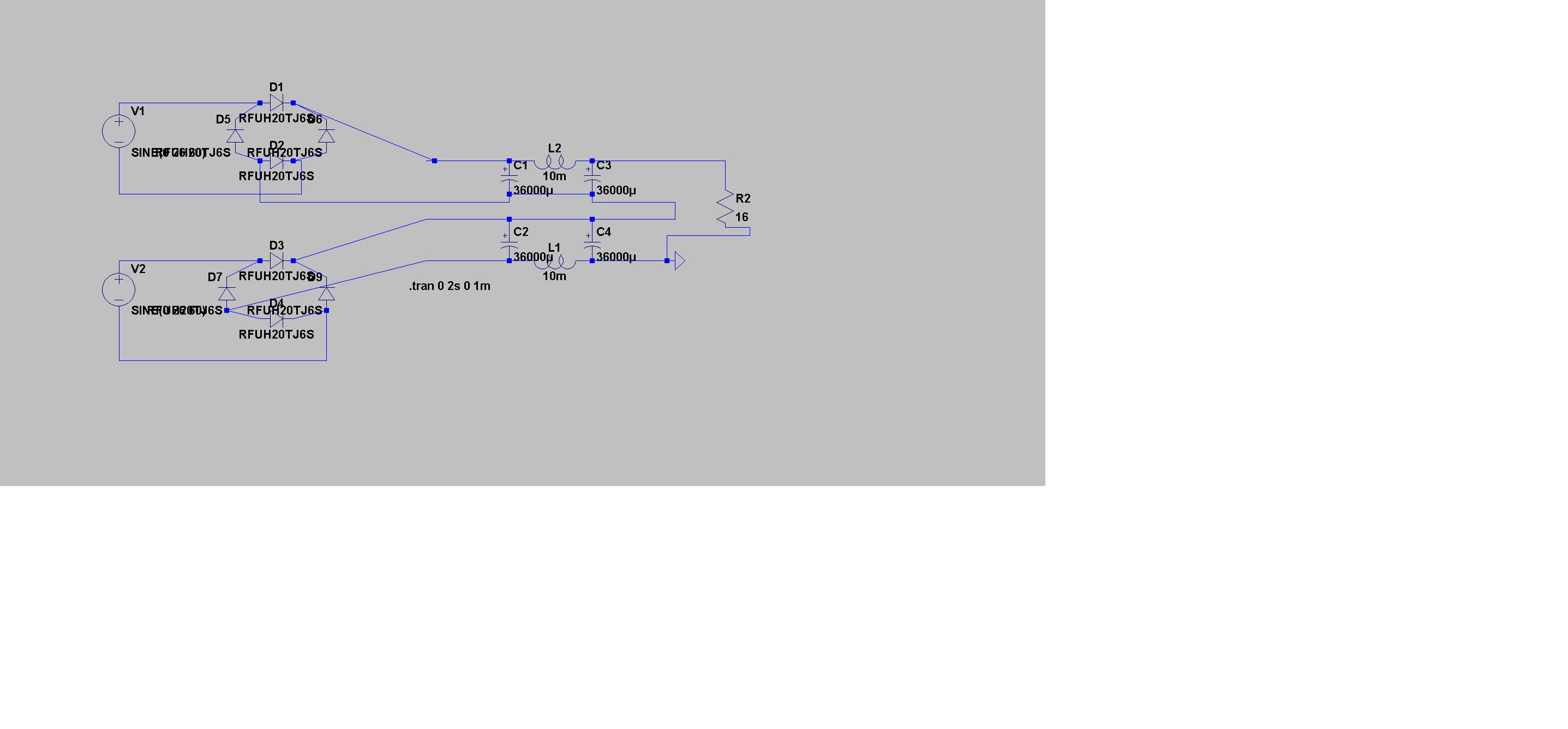

BTW,i made a mistake with the Spice pic I posted.The 2 ,16 ohm resistors across each half wouldn't be there but the connection between top and bottom half would.I then redid my spice sim and noticed with a resistor of around 16 ohms across the + and ground points simulating a roughly 2.6 amp load the voltage drops to about 43 volts.
It's normal for an unregulated supply to drop 5% to 10% under full load,
from the open circuit voltage, unless it's extremely over-designed.
The 23V are typically the under-load voltage of the usual FirstWatt PSU. Probably your unloaded voltage will be higher with 18V AC secondaries.
