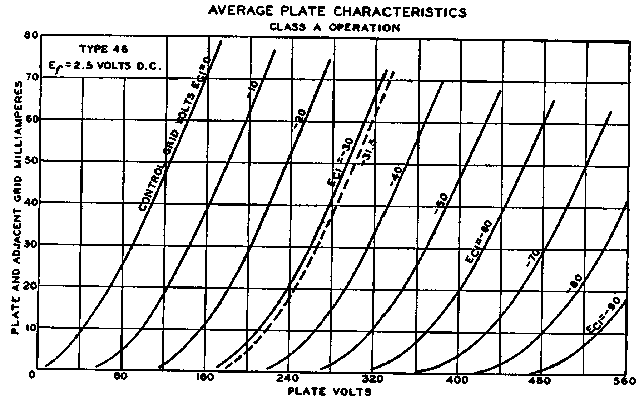

The 46 are regarded as a great driver tube. With the G2 connected to the plate, they operate Class A. I suspect the 46 would sound good as an output tube. I also guess the 45 might sound a little better, but at $50+ each for NOS, I would try that 46 tube.
The '46 while triode strapped has been used by a few people as an output valve by some people - doing a Google search turns up some schematics.
Triode strapped, at 250Va and 22mA, into 6400 ohms, it will give around 1.25W. Not quite the same as a '45, but somewhat similar.

Yes, absolutely worth a try. A couple of years ago I threw together a single channel (triode strapped) 46-based SE amp. Used a 6SL7 as a driver. I experimented with both classic grounded cathode and SRPP for the 6SL7 driver. Sounded a little different but I can't say definitely what I preferred. I also just used whatever junk PP output transformer was on the chassis I had (from Eric Barbour's idea for Single-Ended Glory for Under $100 GA 1997 Vol7 Num3). Ran the 46 at about 250 volts and 25ma.
I never built a "nice" version with two channels since I wanted to pursue a higher power design. But it definitely sounded nice even with one of my speakers which are something less than 90dB efficient. But definitely only enough power for a small room.
