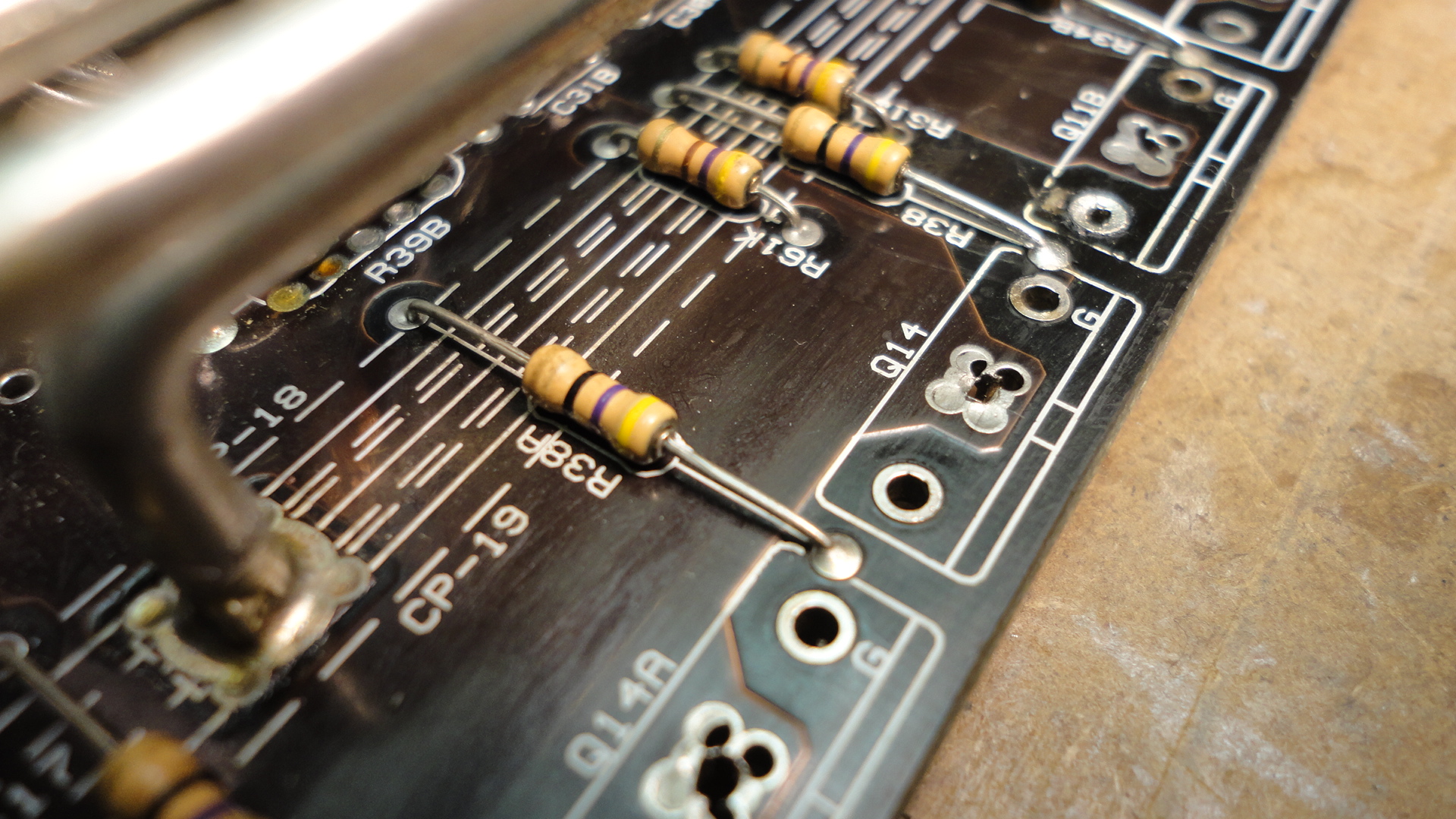

They are the ps gate resistors (46 ohm 1/4 watt 5% I think, lol), they are the originals. 3 of the 6 in that bank are burned up. Values are still in tolerance, but burnt up. The drivers and everything else with the amp are fine. He had one break legs and 2 others in the bank failed. I was only going to replace the bank and resistors. I'm not a fan of replacing them with 47 ohm without replacing them all (even though I realize the difference is minimal). Which I guess I could...
I attached a pick of one of the good ones. They all read between 45.9 and 46.3ohm.. mostly being 46.0 (which is technically still in tolerance for a 47ohm too, lol). So either the bands are actually violet and not blue, and the resistors are all way on their low side... or this amp uses 46 ohm gate resistors, lol.
What color does the band look to you guys? I mean I usually go by other side and stuff, just cause it's hard to tell sometimes. I've been repairing AB amps for awhile. This would be the first amp I've had needing 46 ohm gates. Just for some reason these bands all look blue to me.

Again, don´t go behind the call of duty trying to source 46 ohm resistors, 47 is perfectly fine.
As said above there´s practically no current going through them, no voltage drop, no dissipation.
It will make NO difference to amplifier´s functionality.
Save your OCD to get same or very close switching Mosfets, *there* you will find a lot of variation and it´s significant.
