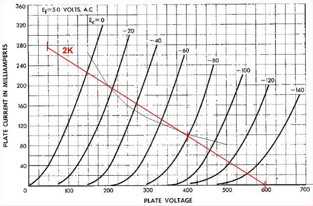

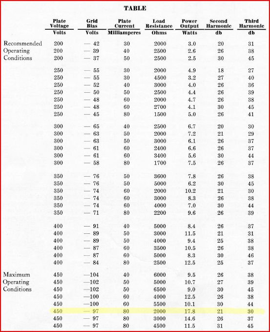

3nity said:Hi,
Has anyone had the chance to test this kind of amp?
A JJ 2A3-40W push pull biased in Class A.
Is it possible to get 30/40 watts on a 4 ohm speaker?
There may be a way to get about 35 watts at the expense of
distortion and damping factor. Check out the SE op point at 450V
anode and 80 mA into 2000 ohms. Class A (more or less) push-pull
at this op point and 4000 ohms plate-plate would give you about
35W at the anodes and well over 30W out after losses. The anode
dissipation will be 36 watts at idle.
The chart is for a 300B but the JJ 2A3-40 has the same characteristics.
For a 4 ohm speaker you just need a 4000 ohm to 4 ohm OPT.
Michael

I think 40W is barely approachable in class A with a 40W anode dissipation limit, and that with an asymmetric load line. The best I can imagine in A2 is about 38W with a 2K per side (4K plate-plate) load impedance, and whether it qualifies for class A is debatable.
I personally would rather shoot for 20-25W power output with decent damping factor and reasonable distortion in A2, and 15-20W in A1
