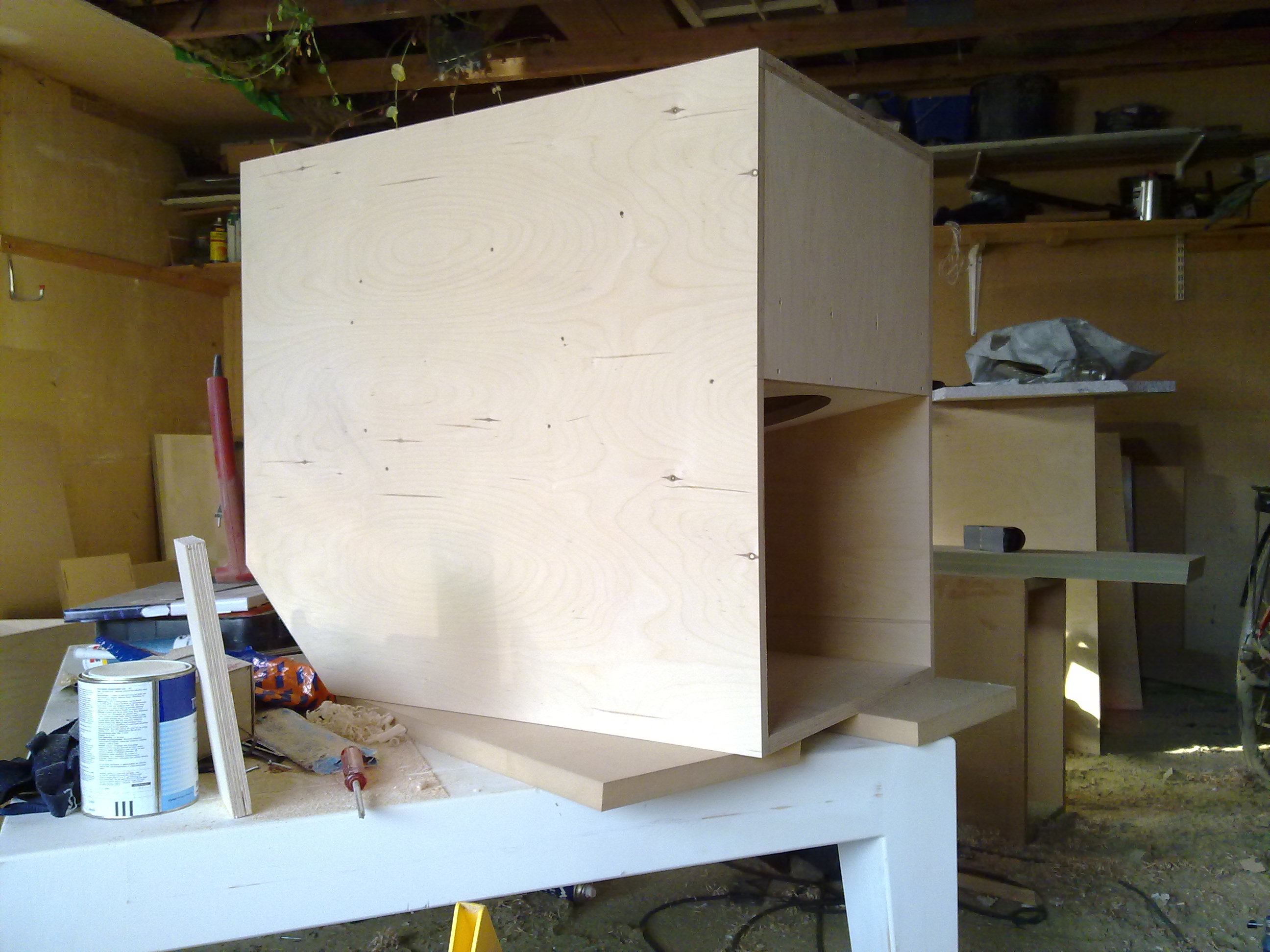

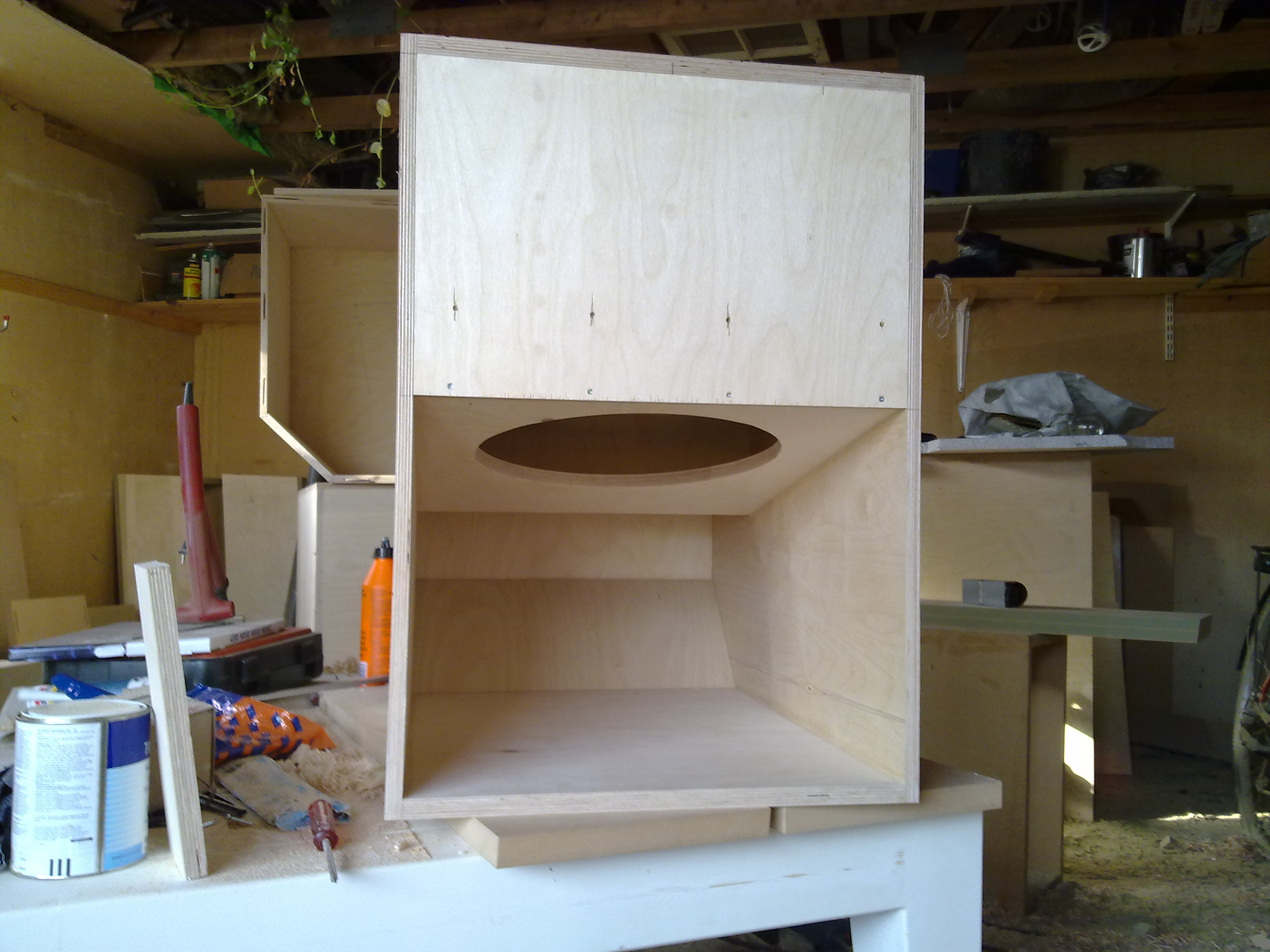

I have build some speakers trough many years and i would like to share my latest project with you.
Goal: reasonably flat down to 35Hz, minimum 100dB @ 40Hz/2,83v 2pi.
Easy to move around, DJ use.
I will build 4pc first.
There are many 15inch speakers that simulate well, RCF 15NW100, Beyma 15P1000/1200/1300ND, Faital 15HP1060 etc.
I have some brand new Eminence 3015LF on my shelf, but they seem to do the job best in lower compression ratios.
There is one part i am unsure how will affect the result:
After the first bend there is a slight negative tapper towards the second bend...
Any idea?

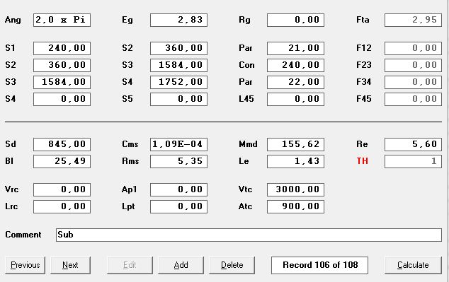

I have simulated it, but i am not sure what to "call" the S2 > S3.
It seem to to be midway between CON and EXP looking at the schematic liters.

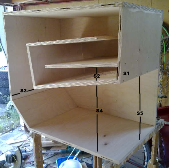

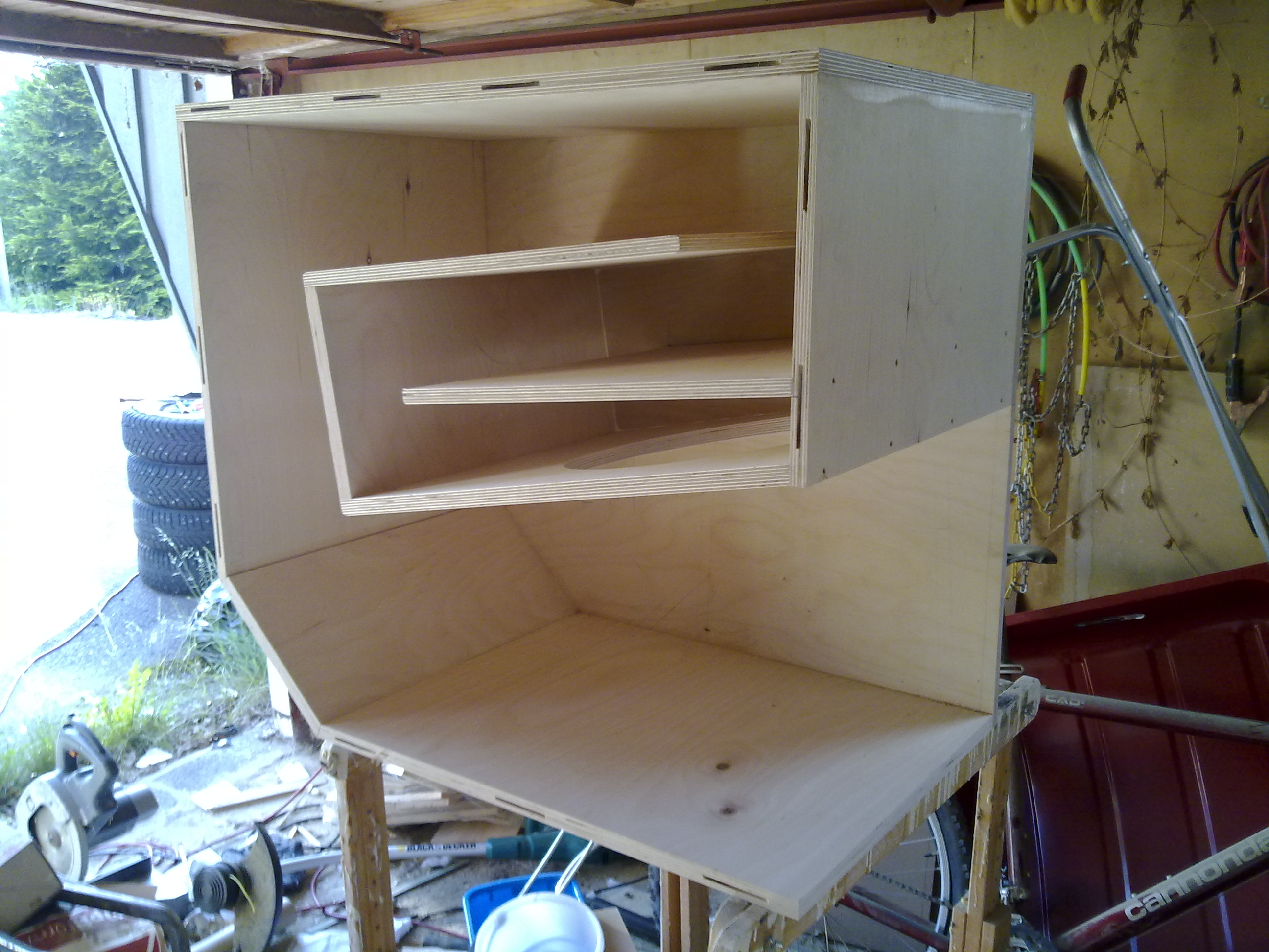

Hi Dag,
For a 4-section simulation in Hornresp S1/S2/S4/S5 are defined by the box construction and the loudspeaker location. To find the location for S3 you almost have to draw a roll-out of the horn path, and find the point where S3 best matches the horn shape. Soho54 provided quite a few nice examples, here is one:
http://www.diyaudio.com/forums/subwoofers/175658-tham15-compact-15-tapped-horn-21.html#post2451737
As to the flare, somebody calculated, that for hornpath with parallel sides, as in tapped horns, PAR is normally the correct flare.

I think PAR is only right when paralell walls are used and the expantion is with 90 degrees bends!?
In my horns it expands a little more.
In liters it ads up between CON and EXP.
But i will try to simulate with four segments.
Here is how i calculated 3 segments:

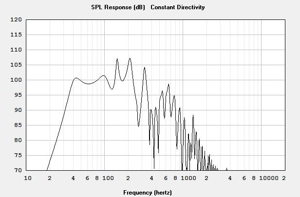

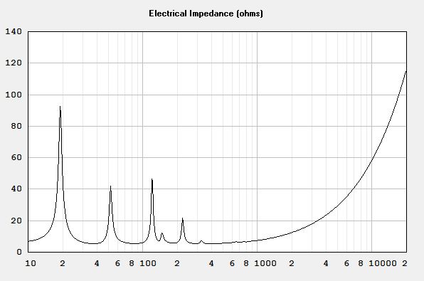

Four segment simulation with Eminence 3015LF (i know- i know, but that is the only 15 inch driver at hand now)
Made a quick impedance meassurement and its not exactly spot on...
The height of the peaks is one thing, another is the first peak which are some 6Hz higher than predicted by Hornresp.
The shape and location of the first peak suggests that (1) the horn is a bit shorter than the sim (how did you measure its length?), and (2) you might have some leakage around or near the driver.
That explains it, i just laid the horn upside down so the magnet was facing upwards, holding the speaker firmly in place.
I guess i should mount the speaker before taking more measurements.🙄
The length was measured along the midle of the path, dividing the 90 degrees bends in four.
