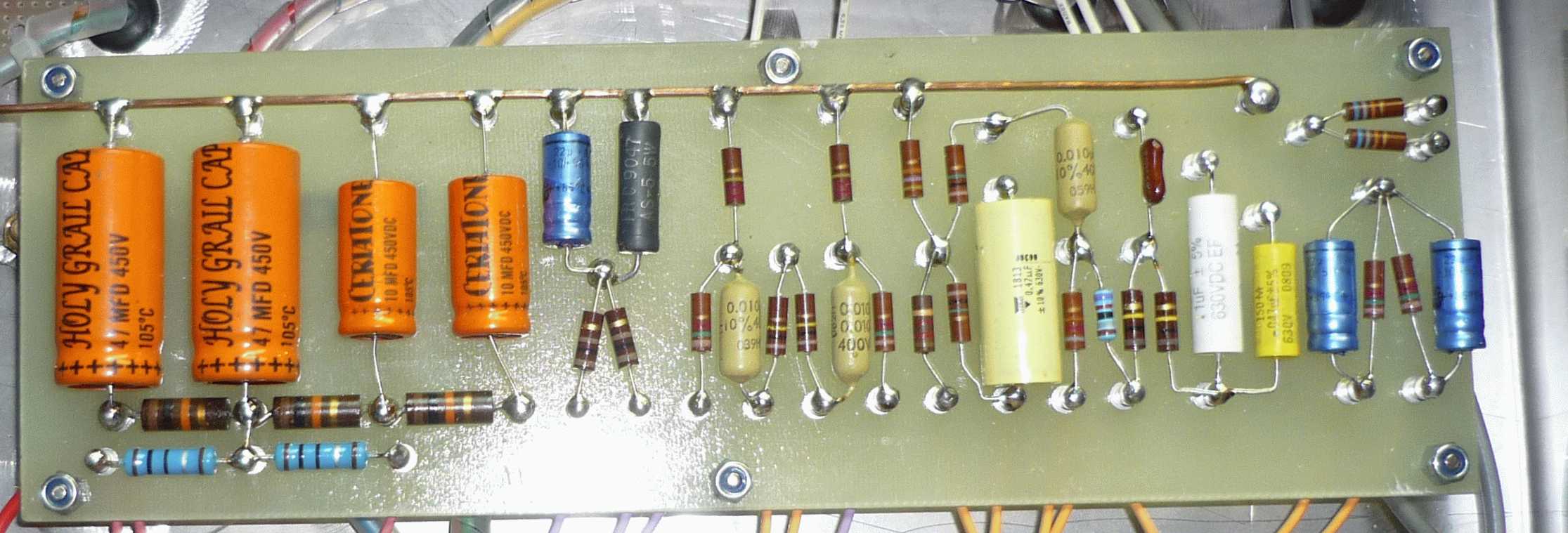

Nice soldering work there Eric. Very neat. I need to take this approach.
Thanks Brit01,
I've been a sparkie (Electrician) for about 33 years, the last couple of decades in technical fields. That helps with the soldering. I probably went a bit overboard on some of the turrets though - some had to be wire-wrapped to accomodate the component leads and as such needed a bit extra solder. The trick is not ot overheat the join, but still get good run-through for an effective bond.
I've added another shot if you're interested. If you were wondering, the small circuit board mounted on the PT bolts has a small bridge rectifier, resisitor and electro for the LED on the front panel - cheers.
