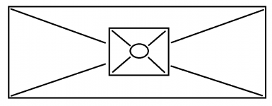

Thats a cool design, however I'm not sure I'm totally game on the twin 8.
The sh-96ho seems like alot of crossing freq seeing how its got alot of low end extention while I already have 400hz n below figured out.
I'm debating replacing my 90-400hz kick bins with some 90 to 700-800hz dual-kick bins.
This would let me use mid-range compression drivers down to say 700hz.
Atm I'm debating a 2x horn design where I use a mid range compression driver from 700-3k and a high range compression driver from 3k up to 20k.
The main reason for this is since I would like to hang them from 10-15 feet in the air and using a 2nd compression driver to cover the mid-range would eliminate the need or requirement for there to be 6" 8" 10" or 12" drivers in the cabinet to play the mid range between the kick bins and the highs.
This would eliminate the need to build 4 different cab types ( 4x subs/kicks/mids/highs vs 3x subs/kicks/mids+highs) while keeping the system 4-way since the mid+high compression drivers would be in the same smaller cabinet.
I already have four double 15 with horns that I could use for my mid range but the main reason for this change is cuz I'd like to be able to hang the horns to get them out of peoples faces when they dance next to the 20f wide, 48inch tall wall of 18's.
Whole goal of this is basically to eliminate the 2x15+horn bins, so replacing them with twin-8 that is the same cut corner type of design isn't really changing much.

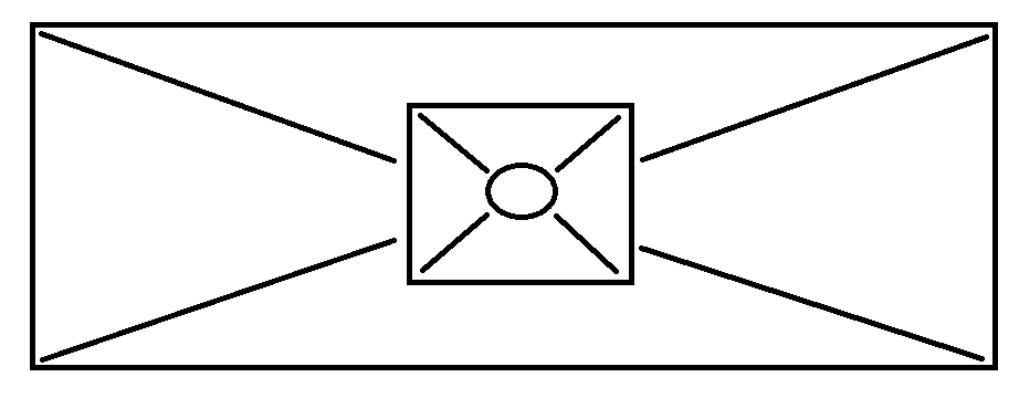

You could use a coaxial compression driver down to 300hz on a large horn. B&c and BMS make them.
Yeah.... $500-900 for a coaxial driver when I could make my own coaxial cabinet seems silly. Plus I'm canadian so my dollar is worth 25% less and I pay a extra 18% duty on boarder, may as well add a extra 50% value to that price.
I'm seeing a 10x22 horn path that goes down to 500hz for $25 and a 5x5 horn path thats 3.4" deep for $12. Drivers that would work for $40 mid compression from dayton, $50 high compression from PVR.
All that together is under $150 in parts that would cover the same range and I could put the 5x5 horn+pvr compression driver in the throat of the 10x22 horn path.
Cut em like 700-3k-20k and it would cover my top end.
