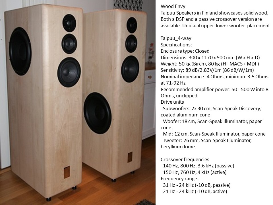

While you can still purchase high quality wood....
Wood Envy.... A Life Time speaker.
Taipuu Speakers in Finland showcases solid wood cabinets. Taipuu has a 4-way design using Scan Speak drivers which is well documented on their website, and the VituixCAD2 cadtool website also models this speaker.
Taipuu Speakers - Taipuu Speakers
Taipuu Speakers DSP active speakers - Taipuu Speakers

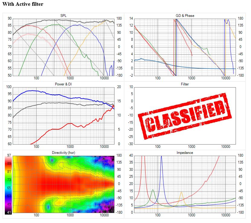

For DIY you can select an audio signature created by cones of paper(natural), plastic(smooth), or aluminum(detailed). A medium cost aluminum build might use SB_Acoustics drivers plus a bottom side-side pair of 12" Dayton subwoofers, all drivers in sealed volumes.
tweeter: 1" dome SB26ADC-4
midrange: 5" SB15NAC30-4
woofer: 8" SB23NACS45-4
side-side subwoofers 12" Dayton RSS315HFA (4 or 8 ohm)

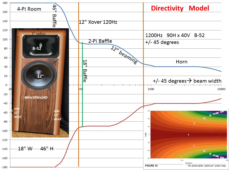

Have you sketched your room + speakers, or used free speaker placement room analysis tools? Would speakers with a 90-degree or 60-degree horizontal polar pattern remove early reflections from near side walls?
Horn Controlled directivity.... 18" wide cabinet... $600/speaker in parts
Admittedly I have not done any research on placement in my listening room. I do have the luxury of high, 10 foot ceiling but my room is wide about 20 feet but shallow 15 feet.
Do you have any suggestions when dealing with shallow rooms where the speaker is 12 to 14 feet from the listener? Thanks!
