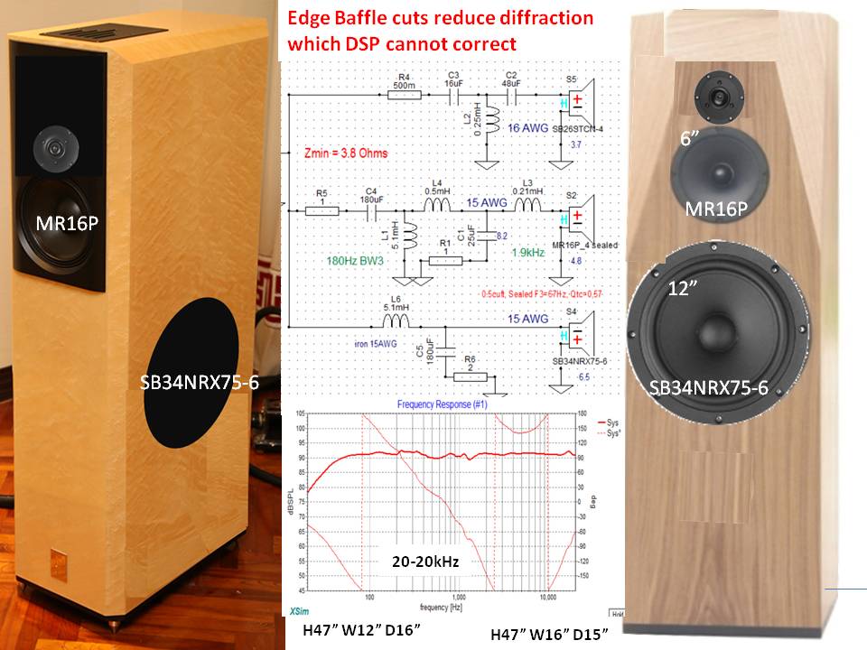

Speakers with two 8" woofers are very common because they allow a narrow 10"-11" wide front baffle, and provide the same area as a 12" woofer. You can even mount the two woofers side-to-side near the bottom of the cabinet if you want a 7" wide front baffle for your 5" midrange. Audio Physic Inc... championed this narrow front baffle.
There are a few 12" woofers like the SB_Acoustics SB34NRX75-6 which produce deep 32Hz bass in a tight transient SEALED 3+cuft cabinet. The 12" can be mounted on a wide side baffle, and the cabinet can be tall to get 3+ cuft volume.
An "overlap" creates at worse a 3dB bump, which is unlikely to be your worse deviation from "flat" response.
