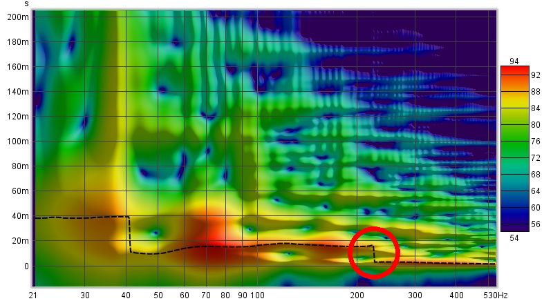

No new measurements unfortunately, but I have a question to the spectrogram in the attachment.
What does the encircled step mean (if anything)? 220 Hz is the XO point between the midbass and bass horn. It looks like it is less than 10 ms, which would correspond to half the wavelength, so may this indicate an out of phase connection? Or is it just a coincidence?
By the way, the lower step can be explained as the phase shift around Fs of the bass horn. The delay length corresponds also to half wavelenght.
