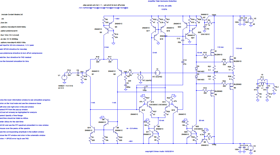

Hi everyone,
I've designed this amplifier based on NE5532 opamp, that has 3 voltage gain stages, I wanted to test it because it has an enormous open loop gain and it's an interesting design, the problem is the frequency compensation, it seems almost impossible to add a dominant pole capacitor, I've also tried to use MIC, and the ac simulation has shown good results, but when I try to do a transient analysis the simulation runs slowly and oscillations appear. Can someone help me here?

Op amp circuits don't typically translate into good discrete circuits. Op amps can provide some performance parameters that are virtually impossible to translate into discrete designs, because of their thermal tracking and very close tolerances in the individual device even though tolerance from device to device can be as high as 30%. Op amps also behave differently at high frequencies because of their physical size.
I can understand why you would emulate the 5532; it provides very good performance in an inexpensive and simple to use package. These virtues will not translate to a discrete circuit unfortunately.
I think it's the input stage that is its secret; the 5532 is far from an ideal op amp specwise but it works very well in audio circuits. Doug Self's "Blameless" amplifier has sorted all this out for discrete designs. Take a look at it if you haven't already; his input stage is highly optimized and maybe you could emulate that for your own design.
Poles "stack up" and cause problems with high open loop gain circuits if not properly sorted. Rule of thumb is to have poles separated by a decade; but this is not always practical. The fewer the poles the easier it is to sort out; one way around this dilemma is to use a two stage circuit. Dominant pole should be in the first (ideally) or second voltage gain stage. Output stage should be as fast as possible.

check your circuit carefully. a regular diff amp inverts between the input and VAS, but your circuit inverts twice,,,, try swapping the feedback connection and the input connection on the first diff amp... you might find the simulator will like it a lot better..... i've made a similar error a couple of times with LTSpice, so now if the sim crawls and the circuit oscillates, i look to see if i've got the correct number of inversions.
