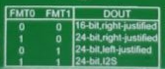

Note that the DIR9001 module has 2 jumpers (FMT0, FMT1) for settings,
something that none of the other 3 have..
