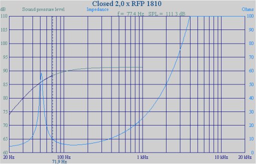

I consider too use them in 2pcs 44L sealed boxes
Modeled up in Cad 4,0 this will result in a curve like seen in the attachment
Have anyone an idea of how this will work in a living room about 35 m2?
I have tested 2 of them in a 58L ported box tuned too 40 hz but belive sealed will be smother and offer more deep down
Wich other options do i have with these drivers?
