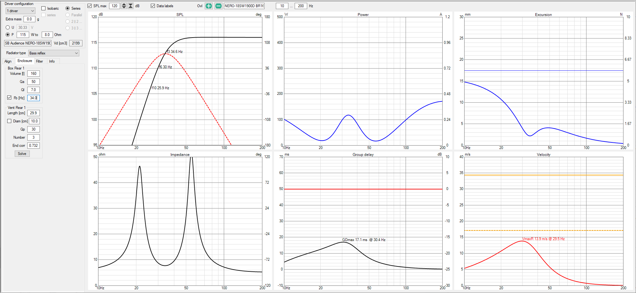

I'm in search of a decent PA/hifi type 18" LF/sub driver for a vented 160L enclosure aiming for -3dB @ low 30s. It would be nice to have 95+ dB sensitivity at an acceptable xmax to achieve at least 115dB down to F3 and possibly good F10.
Budget is up to $400-ish and available here in the US. Been looking at the B&C 18TBW100 and 18TBX100 as possible options. Neo would be nice but a ferrite motor wouldn't be out of the question. Already tried the 18NW100 but its specs weren't as advertised.
I've looked at the so called 18" Marty Cube design, which is roughly what I wanted but I'm open to anything comparable. I prefer vented over the popular horn loaded TL for more accurate, tighter low end. A larger vented box is a good compromise IMO.
Please reply here with any suggestions in line with my preferences and goals.

The SB Audience NERO 18SW1900D looks like a fit other than the DCR is 5 ohms not 3.5. 17mm Xmax and matches your box parameters.

@perrymarshall That's a brute of a driver. I wanted 4 ohms due to maxing out available amp power. I have a QSC GX8D available for the task which will do about 1200W a side, but it will likely be overkill for hifi use.
I also considered a 2 x 15" design with 8 ohm drivers, widening the field of choices.
My concern is enclosure size. I wanted to stick with 160L mainly due to the available format of wood to build it. One sheet of 60 x 60 cm birch ply would be able to make up the basic sides in a single layer, but a double wall 1.5" (3/4" per layer) box would be better, mostly for heavier ferrite motors.

The following simulation is for the NERO-18SW1900D in a 160-litre enclosure detuned to 26Hz. To compensate, I've added a 2nd-order high-pass peaking filter set to f0=27Hz with Q=1.60, which boosts by about 4.5dB at 30Hz or so, as well as controlling driver excursion below the vent tuning frequency. The computed response simulated in VituixCAD is shown below. With a nominal 115W re 8ohms of input power, we obtain 115dB SPL at 30Hz, which meets the design target. Here at 30Hz the response is only −1dB relative to the passband, which is at 116dB for this input power. The f3 is 26.7Hz, which also comfortably exceeds the design target of being −3dB in the low-30s frequency-wise, and f6=24.1Hz, which which is relatively low. The driver displacement at this power level is a bit under 1/2 of Xmax, so there is quite a bit of displacement in reserve for short-term peaks being reproduced linearly.
If we forego the use of the peaking filter, we can still get very good low-frequency extension. The VituixCAD simulation obtained when the vented enclosure is tuned to 34Hz is shown below. Here we have obtained f3=34.6Hz, and f6=30Hz. The response is −1dB at about 40Hz relative to the passband. This response isn't as extended as the previous filter-assisted one, which was −1dB at 30Hz, some 10Hz lower.
If running at very high power levels, it might be prudent to control cone excursion below 30Hz. This can be done by adding a 2nd-order Butterworth high-pass filter. Its cut-off frequency could be set to 16Hz if only moderate control was needed, or 20Hz, or even 24Hz, if stronger control was thought to be necessary. The appropriate choice would depend on whether or not there was going to be lots of signal content around or below 20Hz.

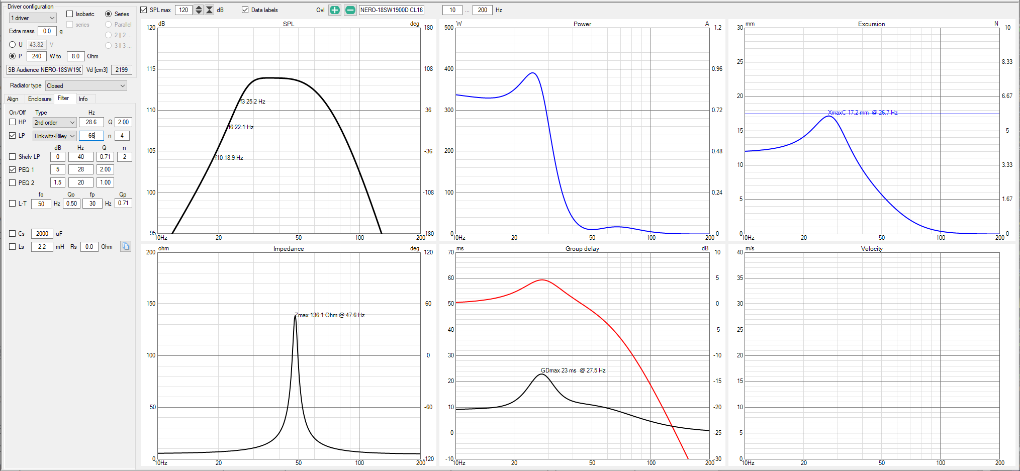

If the NERO-18SW1900D driver is placed in a closed-box 160-litre enclosure instead of a vented-box enclosure, it is possible to achieve the following response. Here a 4th-order Linkwitz–Riley low-pass filter has been applied, as its rolling-off frequency response interacts heavily with the increasing output of the sealed system when the frequency is increasing, and therefore needs to be accounted for. The f3=25.2Hz, which is quite good, but the maximum SPL is only 114dB when the input power is 240W re 8ohms, and Xmax is reached at 26.7Hz at this power level. The peak power input is almost 400W.
The NERO-18SW1900D driver has fs=34Hz and Qts=0.42, while the 18LW2400 driver has fs=35Hz and Qts=0.31. In a 160-litre vented-box enclosure, the 18LW2400 ends up having a much higher f3 cut-off frequency for any tuning that is relatively flat. This makes it less amenable to having its frequency response extended lower when the enclosure volume is fixed at 160-litres. The effects of the difference between a driver with Qts=0.42 and one with Qts=0.31 are very strong and cannot be overcome (at least I can't seem to).18LW2400 might be workable for your list, too.
@witwald I greatly appreciate the extensive sim and detailed post. Thats a serious driver. I agree with the higher Qts being beneficial and comparing smaller differences in dampening which can really affect F3 and F10. Running into excursion limits at a few hundred W isn't necessarily a problem but it can get away from you fast depending on the material you're playing.
There's also the magic Qts range which i usually favor for QB3 alignments. A Qts of .37 to .43 fits into this scheme and allows for better transient response. Group delay can be an issue but its generally not severe with carefully thought out QB3 alignments.

Thanks for all that!If the NERO-18SW1900D driver is placed in a closed-box 160-litre enclosure instead of a vented-box enclosure, it is possible to achieve the following response. Here a 4th-order Linkwitz–Riley low-pass filter has been applied, as its rolling-off frequency response interacts heavily with the increasing output of the sealed system when the frequency is increasing, and therefore needs to be accounted for. The f3=25.2Hz, which is quite good, but the maximum SPL is only 114dB when the input power is 240W re 8ohms, and Xmax is reached at 26.7Hz at this power level. The peak power input is almost 400W.
