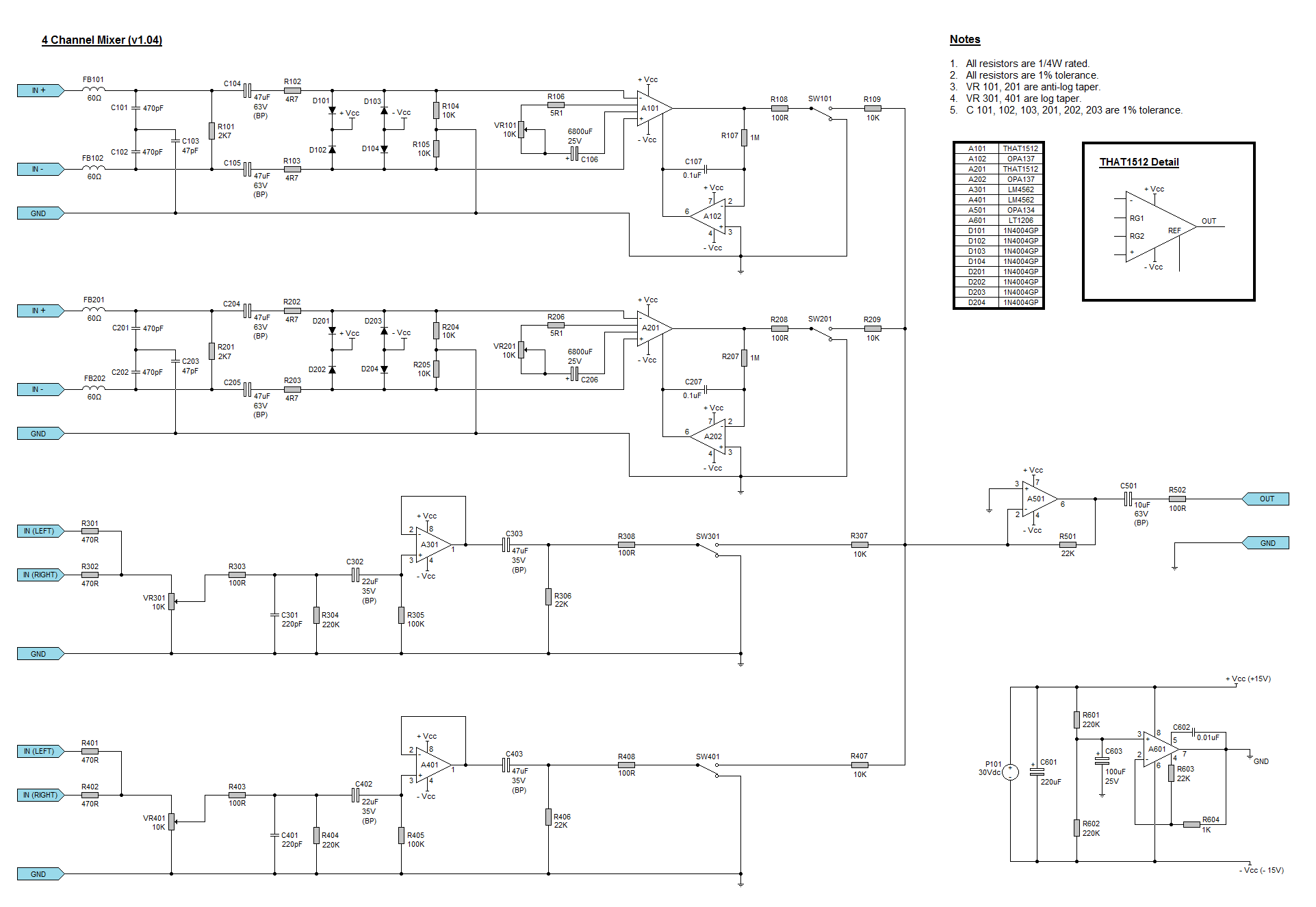

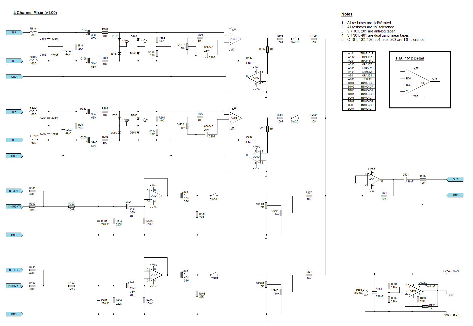

Hi all,

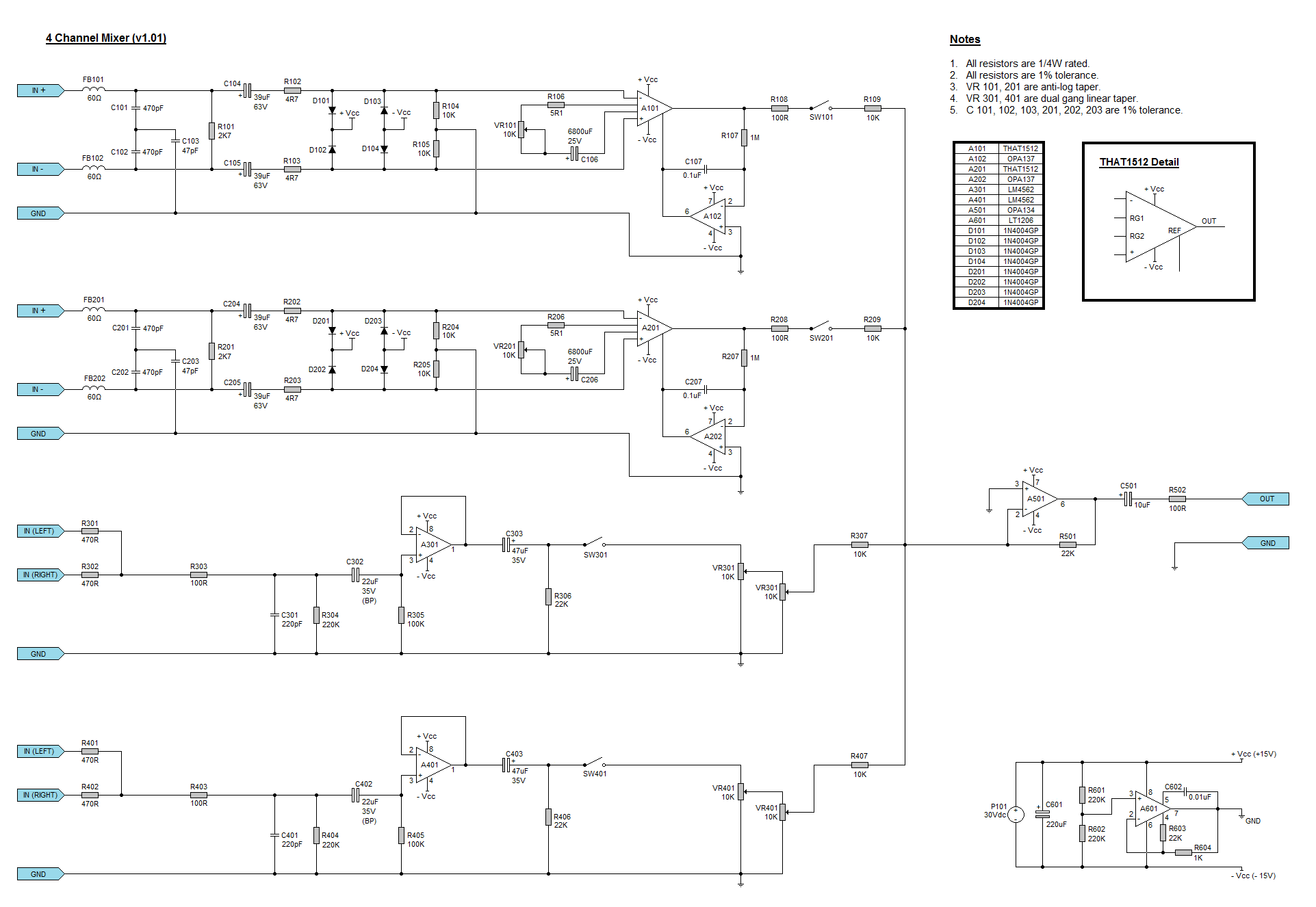

Following the simple two channel mixer, I have now drawn up a design for a basic four channel mixer. This version has two balanced XLR inputs with preamps (channels one and two) and two unbalanced stereo inputs (channels three and four). All channels need to go to an unbalanced output. As this will be used live on stage, a “popless” mute switch is required for all four channels.
I have attached the schematic and I was hoping people would be kind enough to critique the design.
The preamp stage for channels one and two is based upon the Dantimax ThatMic design with a few changes to the variable gain stage, the addition of an OPA137 opamp and the removal of the phantom power supply circuit (dynamic mics will be used). The OPA137 is to drive down the DC output to 0V as per the recommended design for the INA217 (as seen here – page 7).
For channels three and four, 0V DC output is achieved using C303/R306 and C403/R406 and is taken from Douglas Self’s Small Signal Audio Design (p. 341).
Are these methods the best to get DC output to 0V – thus avoiding pops and clicks when the channel is muted? If not, what changes should I make?
Are there any other goofs I have made (quite likely being me!)?
Sorry for the questions again, but I would really appreciate any help.
Thanks very much!

Hi all,
I just edited the attachment – I had missed off a resistor part code. The file attached to this post is the correct one.
If anyone has any feedback on my design I’d really appreciate it.

I had a quick look at your schematic:
1) Unless you plan to add phantom power, the input caps C104, 105, 204 and 205 (and also the output caps C303, 403 and 501) should not be polarized.
2) Why are ther 2 pots on the line-level outputs (VR301, 401)?
3) Why C103, 203?
4) A601 could be replaced with an inexpensive op-amp and I would add a capacitor from pin 3 to ground.
Cheers, E
Hi Mickeymoose,
Thanks very much for looking at my schematic, I really appreciate it.🙂
I am certain phantom power will not be added in the future as this project will be used only with dynamic mics. I have therefore changed these caps to bi-polarized versions as per your recommendation (please see new schematic attached).
I have probably drawn this poorly! VR301 is one pot as is VR401. These are dual gang pots and I have tried to show both “gangs” on the schematic. I selected to use a dual gang linear pot to get closer to a true logarithmic control. I have read that using a linear pot in this way provides superior performance to that of a standard “log” pot. I read this information from Rod Elliott’s “Better Volume (and Balance) Controls” page (see figure 5).
3) Why C103, 203?
This was a design feature of the Dantimax ThatMic pre-amp design on which this is based. I must say I did not understand this feature but as I have plenty of space for this inside the enclosure I plan to use for this project, I decided to retain it the design.

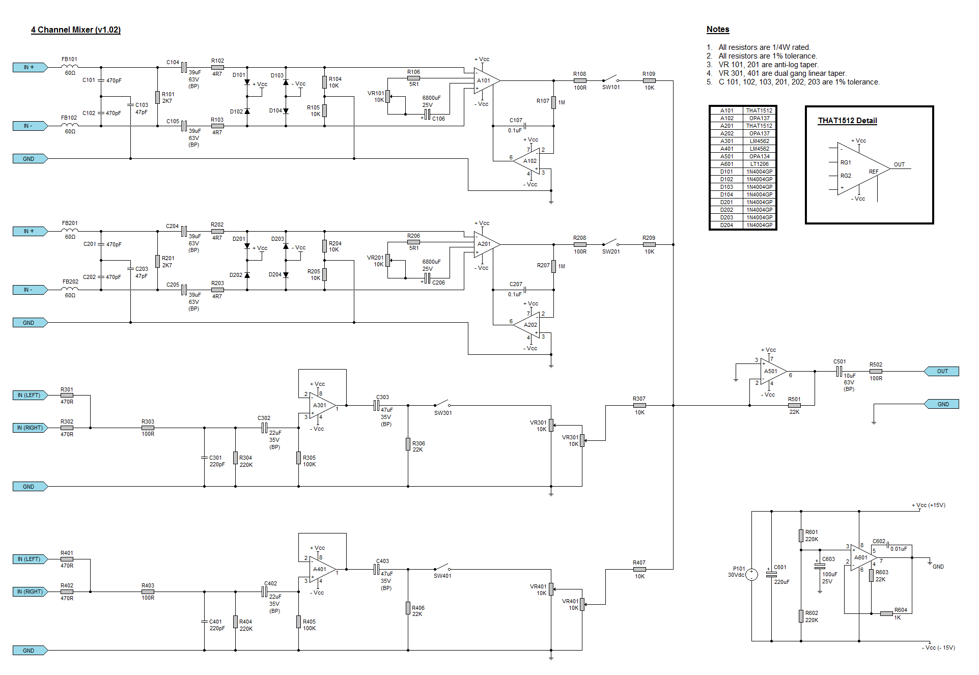

I have added a 100uF cap from pin 3 to ground (please see new schematic). Is there a particular opamp you would recommend as a replacement for the LT1206? Budget concerns are not really an issue with this project so I don’t mind paying for the LT1206.
Thanks very much again for looking at my design. I really appreciate the help.🙂

Hi Dufflefan:
I had a quick look at Elliott's website. I believe he writes about hifi systems and a balance control married to a level control. I'll have another look when time permits, but I believe a log pot would serve you better. Or use a linear pot in the feedback loop of the amplifier (goto Shure.com | Global Home | Choose Your Region and serch for the M267 schematic and look at the U201 circuit)
Also, you will have some level shifting (and propably some popping noises) when SW101 and 201 are activated. This than becomes a active selector, not a mixer. All 4 circuits should be permanently attached to the mixing bus. If you need switches, do not use toggle switches, but self-cleaning slide switches!
Cheers, E

Sometimes I get lazy! Put a 100 ohm resistor on the outputs of A301 and A401. Than the 4 switches to ground to short the outputs for muting. The op-amps should be able to handle that and you can use cheap toggle switches for this. Alternately, use analog IC switches especially designed for this. Level shifts will be minimal. E

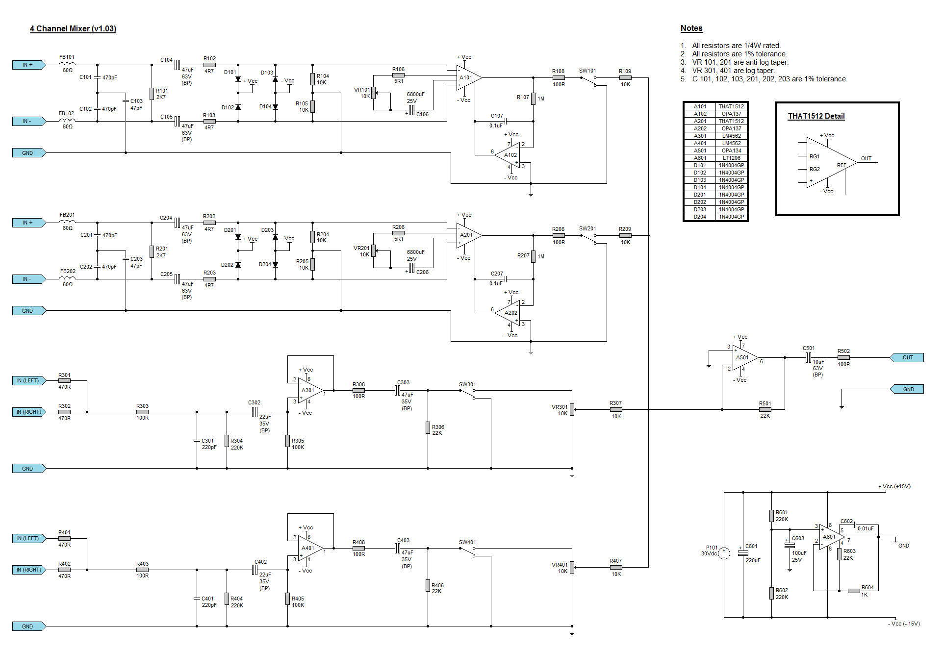

Hi again Mickeymoose,
Thanks for all your help - this is my last question I promise!!
I have added the 100 ohm resistors (R308 and R408) and attached a revised schematic. Have I placed these correctly or should they be placed after DC drain resistors R306/R406 and before the switches (so as to isolate shunt capacitance)?
I have also decided to keep things simple and use a log pot for VR301 and VR401.
Thanks a lot once again for your assistance.🙂
Dufflefan.
Hi Speedskater,

Dufflefan:
You missunderstood me. The switch should place a short between the 100R and the 10kR to ground, otherwise you still have the level shift when an input is muted.
When all channels are active the 10kR are in parallel and set the gain of A501 with R501 (10k:4) if one channel is off it is 10kR:3.
Your ground symbols are OK. It is just the way your program does it and identifies the circuit nodes.
Overall gain is also affected by the settings of VR301 and 401. Maybe they are better placed at the inputs of A301 and 401 or go with the scheme of the M267.
And: keep asking! E

I have moved the volume controls to the inputs of A301 and A401 as suggested.
I have also relocated the 100R resistors (R308/R408) to the end of the outputs before the 10K resistors. Between these I have inserted the switches which divert the signal to ground when muted.
I have attached a new schematic showing these changes. I hope this is correct!🙂
And: keep asking! E
Thanks again for the guidance, it is very much appreciated!🙂
Dufflefan:
Your current swithing (muting) arrangement will cause gain changes when the switch is activated.
What I meant: Connect the 100R to the 10kR. The switch onto this junction, the other side to ground. Muted when the switch is closed. This is not the best, but the cheapest way. I prefer a semiconductor solution. E

Hi Mickeymoose,
I've got it now!🙂 Sorry for the misunderstandings.
I think I'll stick with the switches for muting purposes but next time I'll read up on semiconductor muting. I haven't read enough on the subject as yet but I will certainly be considering it for my next project once I've read more.
Thanks again for all the assistance. When you're learning with these things having such help is a huge benefit. It is greatly appreciated.🙂
