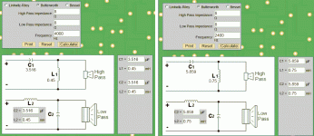

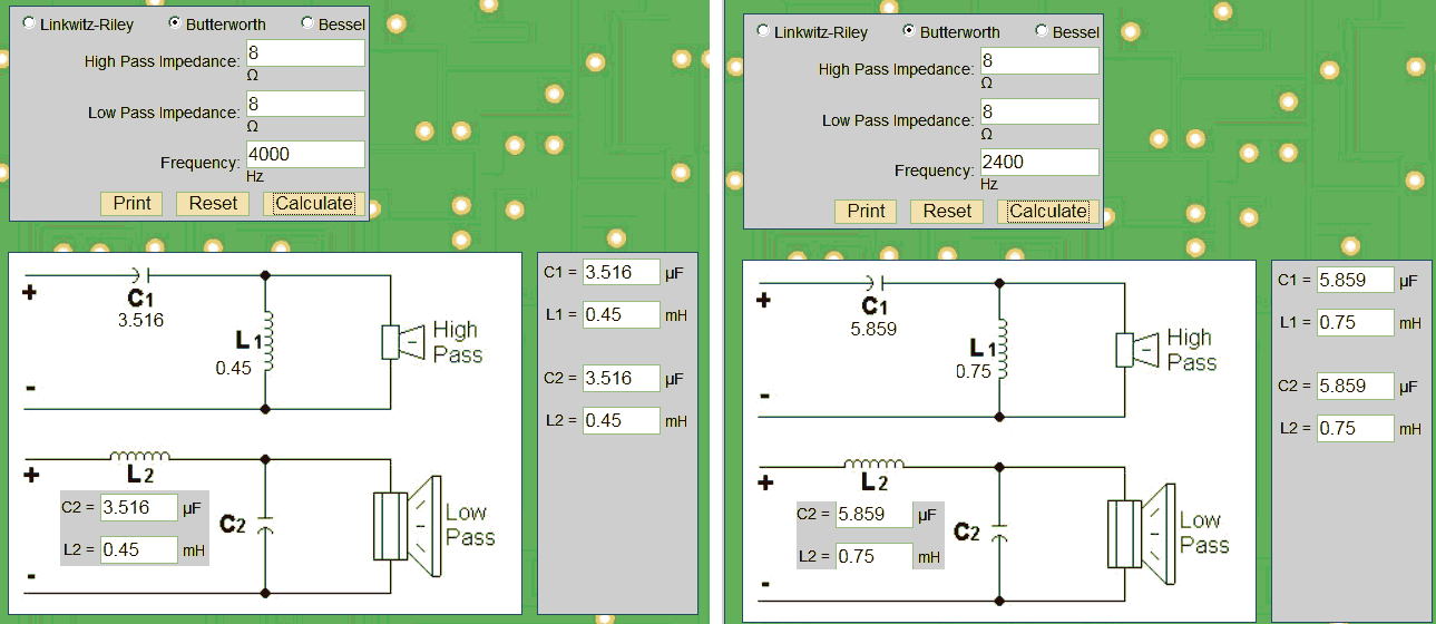

4,000 crossover to 2,500
I bought some binding post with 4,000 crossovers attached. They were so inexpensive that...I can remove the crossover & only use the binding post & I'm still ahead. But...I need a crossover for 2,000 or 2,500. Is there a way to convert these 4,000 crossovers to 2,000 or 2,500?
> go from 4kHz to 2kHz
He asked for 4000 to 2500.
The transposition is 4000/2500 or 1.6.
If it is a simple L-C crossover, make all caps *and* all coils 1.6 times bigger.
"Problem" -- the caps and coils are typically the most expensive parts. You can probably buy a ready-to-go crossover cheaper than you can collect the bits to replace or shim-up the existing coils&caps.

It sounds like trying to modify these 4,000 crossovers is lot of hassle & no savings.
Thanks for the help. I will take the components off the crossover & save the parts for a future build.
