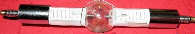

the lamp is double end short arc metal halogen lamp. can replace lamp of :
