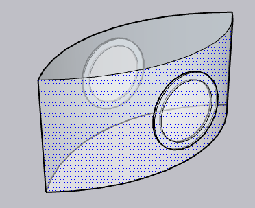

I was thinking about making an elipsoidal Di-pole sealed speaker, two prototypes, one with the speakers along the biggest diameter and one in the shortest one. That may prove to be real difficult, but maybe in XPS (XRK makes me more confident with it) or 3D printing it could be doable.
The Nautaloss II called my attention, maybe with a different front baffle.
But, would't two speakers pointing forward create phase issues at nearfield, which is the intended use?

it would be more reasonable to just make the Bipolar and see what happens, just for learning purposes.
I guess an elipsoidal sealed Di pole may end up being a real good surround... Still i struggled to find some figure of 8 speakers...
And yes it would go far from the walls of the room.
I guess it would be a real 8 for wavelengths lower than 4 times driver's distance.
My biggest concern is to lower diffraction and baffle step as much as posible just with the box design.

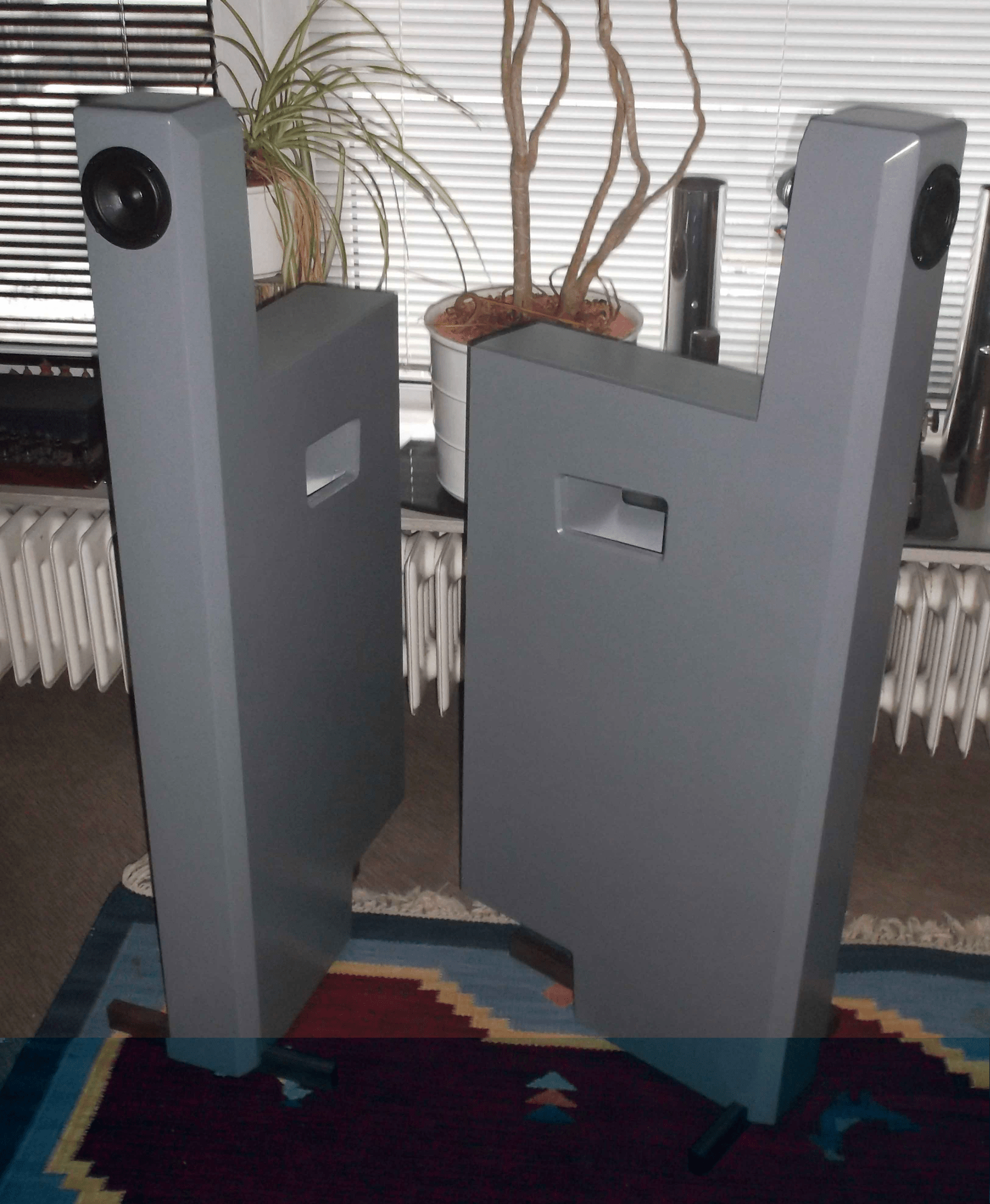

for Bipol go for a double horn down 35 Hz look MINI POSAUNE https://www.diyaudio.com/community/threads/hm-double-bass-horn-mini-trombone.319751/#post-5494908
