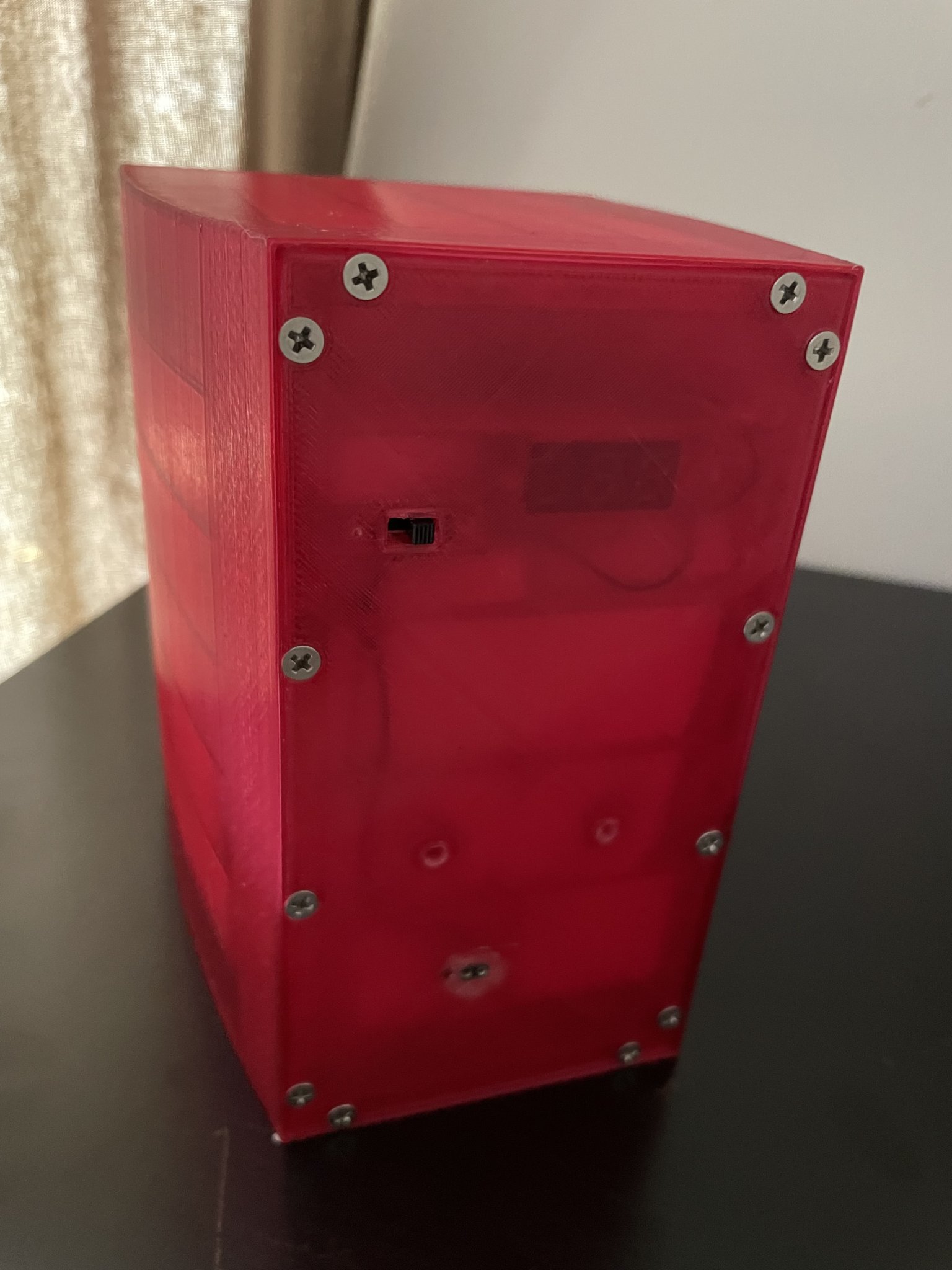

Wanted a super lightweight stereo speaker pair for travel because as we all know those bluetooth boomboxes are an abomination, okay some sound pretty good considering the size, but you can’t beat a stereo source, no matter how much fancy reverb algorithm you throw at it.
And so it came to pass, Red translucent PETG, okay so 1mm wall is not strictly true, there are 15mm ribs, but the result is a 1.8L 200g vented box, F3 95Hz.
Together with the Faital 3FE22 driver, and 12v power tool battery 220g, comes in at ~3 pounds for the pair.
This is my first experience with the 3Fe22, and man what a beast, completely amazed by the clean rich powerful sound coming from them.

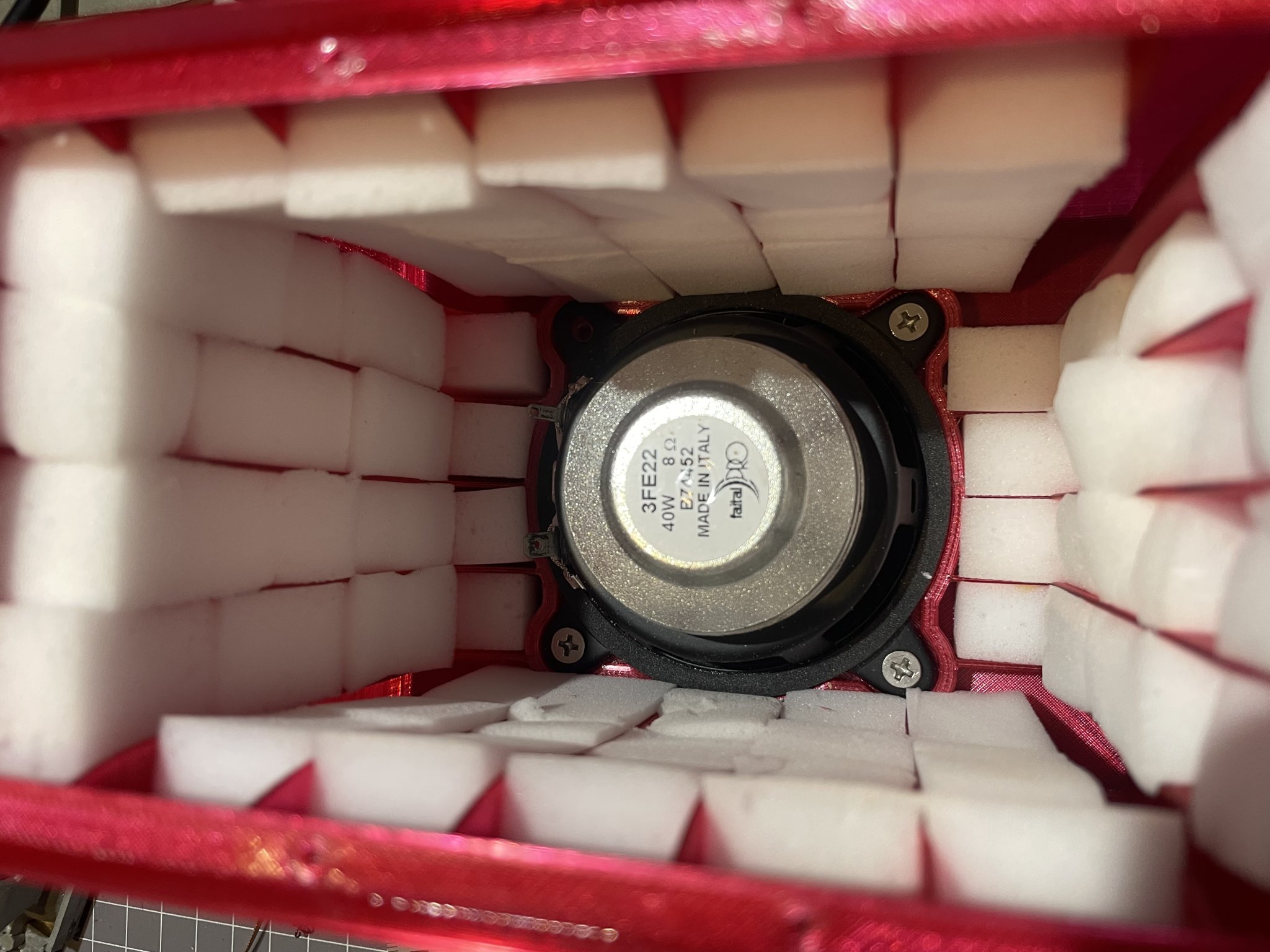

First version had the traditional hole in the cabinet, and was going to work out later what sort of grill I was going to mount on the outside, and then duh, just integrate it into the design.
Lined with Melamine cleaning sponge from Daiso, because that’s the only open cell foam I had in the house, and works brilliantly, I bet it’s what Marie Kondo uses in her speakers.

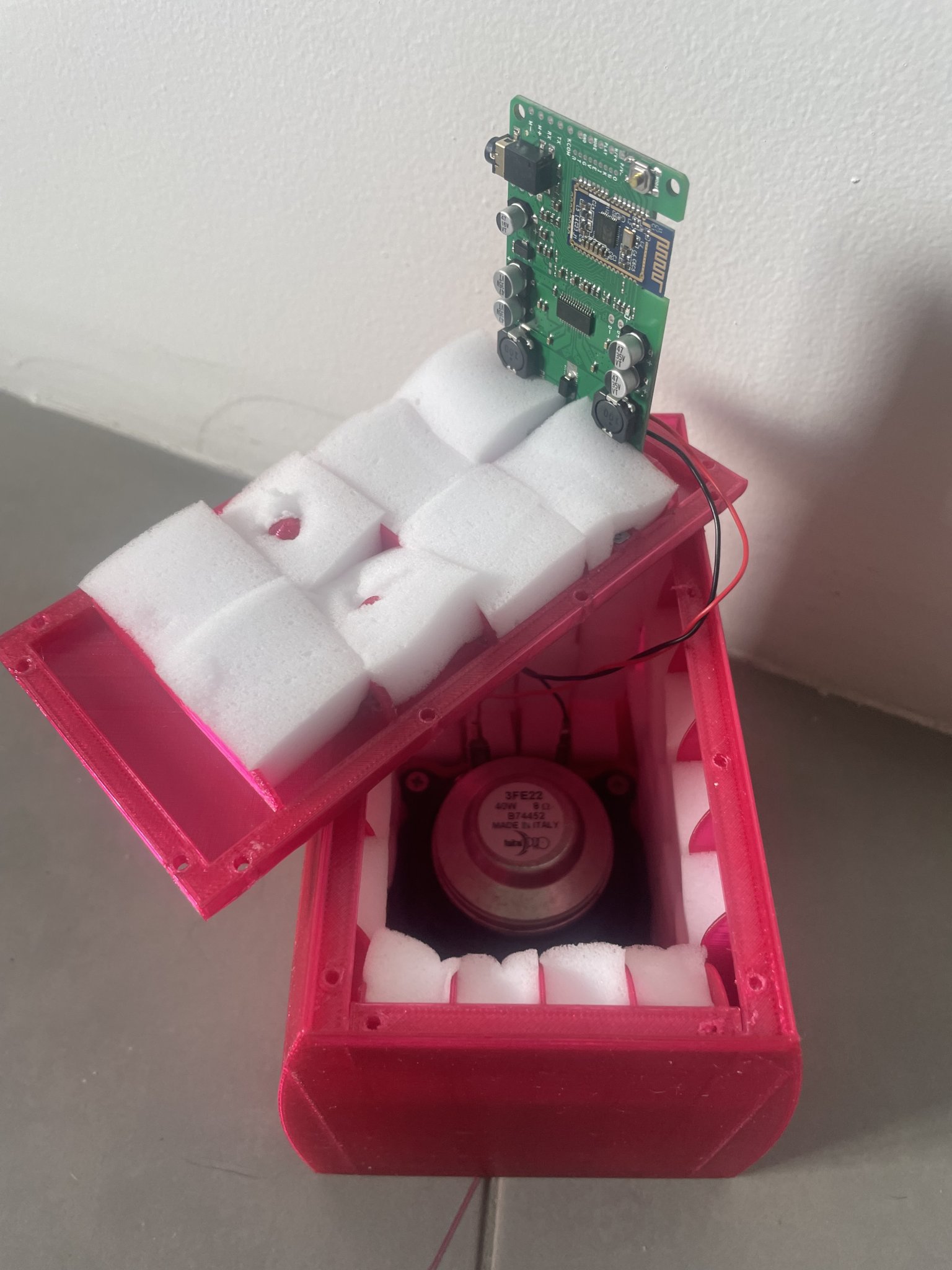

Amp is the Aiyima true wireless stereo module, it sounds really excellent.
The only addition is a power switch and a volt meter, because this PETG is translucent I didn’t have to make a window for it.

Which TWS amp are you using?
These ones are the green Aiyima boards, Don't know the model number, but it claims to use the TPA3110
