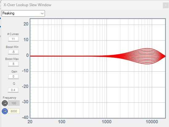

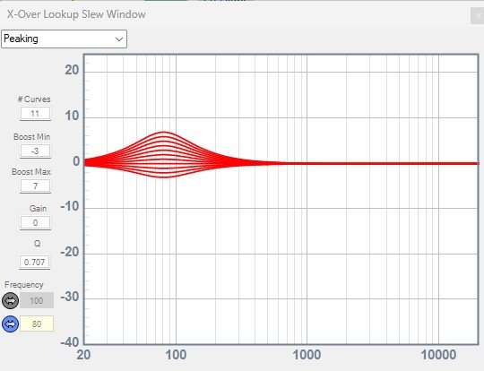

- Do you want to keep the treble and bass adjust capability? I included screenshots on what they currently do. You can change the number of curves, the maximum cut/boost and the Q.

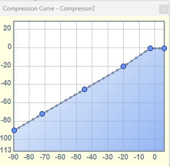

- The outputs include compressors to prevent any possible clipping (see screenshot). This shouldn’t be a problem if you’re simply using crossovers without any parametric EQ gain. Would you want to keep them?

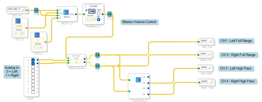

Here’s a screen shot of the project. A few notes:
- I kept the master volume control from the 3E project. For some reason 3E didn’t delete the “Read Hex” block. This is used for program debug to read the pot’s converted numerical value and I think 3E just forgot to delete it. It does no harm and you can try it out while in Sigma Studio.
- Your 3E amp gets full range outputs CH1 (left) and CH2 (right) while your tube amp gets high passed outputs on CH3 (left) and CH4 (right).
- I set the high pass at 100 Hz using a Linkwitz-Riley 24 dB/octave filter. That means the output is 6 dB down at 100 Hz and rolls off at 24 dB/octave below that. Just click on the blue square in the crossover block to change the frequency and/or filter type.
- This project doesn’t account for gain differences between your 2 amps. You can adjust the tube amp if it has adjustable gain. If not, you can add a volume control block to adjust the gain for one amplifier. The safest way is to reduce the volume on the most efficient amp.

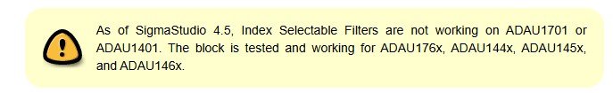

- You could use the “General 2nd Order Index Selectable” filter if you wanted to use a pot to control crossover frequencies. However, I found a note from Analog Devices (see screenshot) about this. So, you’re out of luck unless someone else has an alternate solution.
