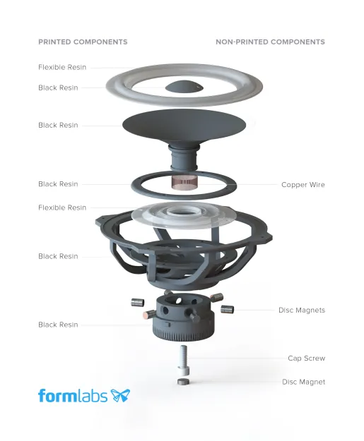

https://hackaday.com/2015/01/27/3d-printed-speaker-pushes-rapid-prototyping-boundaries/
"We think Formlabs has really figured out the key to advertising their line of 3D printers — just design really cool stuff that you can 3D print in resin, and release them publicly! To celebrate a firmware upgrade to the Form 1+, they’ve designed and released this really cool 3D printed speaker which you can make yourself."

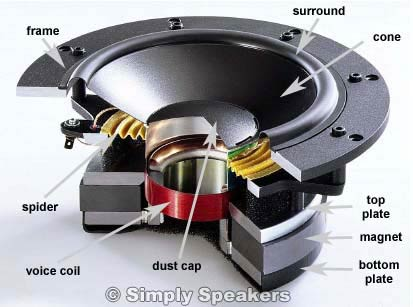

And a basic terminology map so you have a better idea about the typical pieces in a woofer:
https://www.simplyspeakers.com/speaker-repair-how-to-tips-tricks-faq.html
