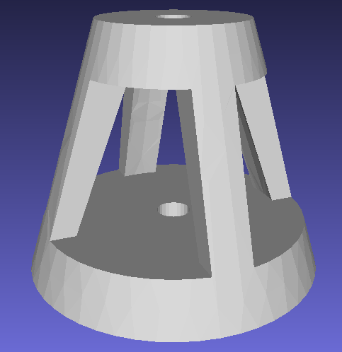

You might need to tap holes in a plate for standoffs, or into a heatsink to mount transistors. If you are like me and are a clumsy machinist, then you have experienced the frustration of breaking a tap inside a hole that you are trying to cut threads into because you are not holding the tap handle straight. If you are lucky enough to own a mill, you can position the tap in the mill to hold it straight, but if not, you may have to do it by hand.
So I have designed these 3-D printed parts to hold the tap perpendicular to the surface of the part being tapped. The tap is inserted through the top and bottom hole, and the bottom surface is placed flat against the surface being tapped. These might be used also to help drill the holes straight as well.
This is a parametric FreeCAD model so you can change the dimensions to suit the diameter of the tap being used. I included 2 mm, 2.5 mm, 3 mm, 3.5 mm, 4 mm, 4.5 mm, 5 mm, 5.5 mm, 6 mm, 6.5 mm, and 7 mm diameter hole guides already generated with the model. A picture of the 3.5 mm model is included which is usable for 4-40 SAE or M3 taps.

In mechanical engineering metal taps come in three shapes -
Tapered tap to start the thread --this helps to hold it steady .
Intermediate--once a semblance of a thread has been cut by the "start " tap ,this tap is used .
Plug tap --this is the final cut tap .
When drilling the initial hole correct allowance must be made for a full thread otherwise it will be easy to strip the thread.
This correct engineering sequence makes it easier to cut a good thread ---using a plug tap straight away is asking for instability when holding the tap holder and a good chance of a poor internal thread which will --yes brake the tap .
Doing the job correctly to a standard achieves good results.

A battery drill/driver makes a great tapping machine.
Torque limited.
Easy to hold still while the motor does the turning.
Much more stable than a tap wrench.

Tapping machines and attachments have an adjustable over running clutch, it runs free if the tap sticks or breaks.
Using a drill on soft material like plastic is border line, but I would never use it on metal to drive a tap.
And smaller than 3 mm I avoid anyway, too delicate...

Anyway, enough of the grumpy tirade, and back to threads, if I've got a difficult thread to tap I sometimes start with a taper, the go in a little way with a plug, then taper - I keep alternating to reduce the torque. I also regularly sharpen taps and dies. If I had to drill/tap a hole without a drill press or milldrill I'd stick the workpiece in a vice, pop a drill in the hole to check the angle and tap accordingly. I tap holes daily, I've used the same 10 taps ( different sizes, taper/plug ) and haven't broken one in a least 10 years. I like to get a lot of use out of stuff.
