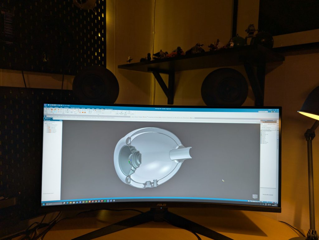

I’m also lazy by nature, so if i can keep the 3d printed finnish i should. That means no joints or other interferences that might need patchwork. So I instead decided to go with a speaker that fits in the printer of 195x195x195mm and came up with an egg shape where the speaker will be on the bottom end. Since it’s the first version i decided to keep some parts modular, like the front and the bass reflex tube. This means i can change from sealed to vented box design and i can change tuning and the baffle according to measurement results. Fixed parameters are the internal volume of 2,1 L as well as the intended driver, a Faital 4FE32. I have some previous experience with the 3FE25, so took the opportunity to build around its bigger sister.

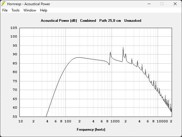

Hornresp simulations give me a standard tuning of 104hz with this corresponding acoustic power curve.

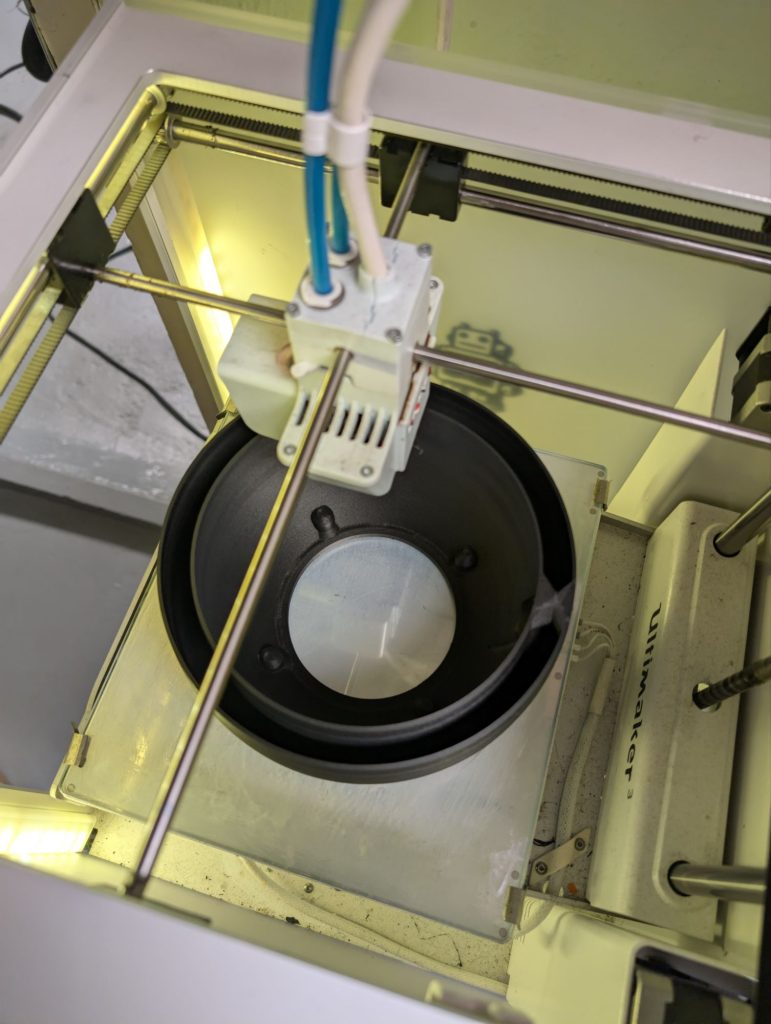

The print process was straightforward and used approx 365g of pla for the main egg with a print time of 16,5h. The wall thickness of the print is 1,5mm on both outer and inner surface. the printer has a 0.8mm nozzle and i do 8 walls and 2mm top and bottom layers.

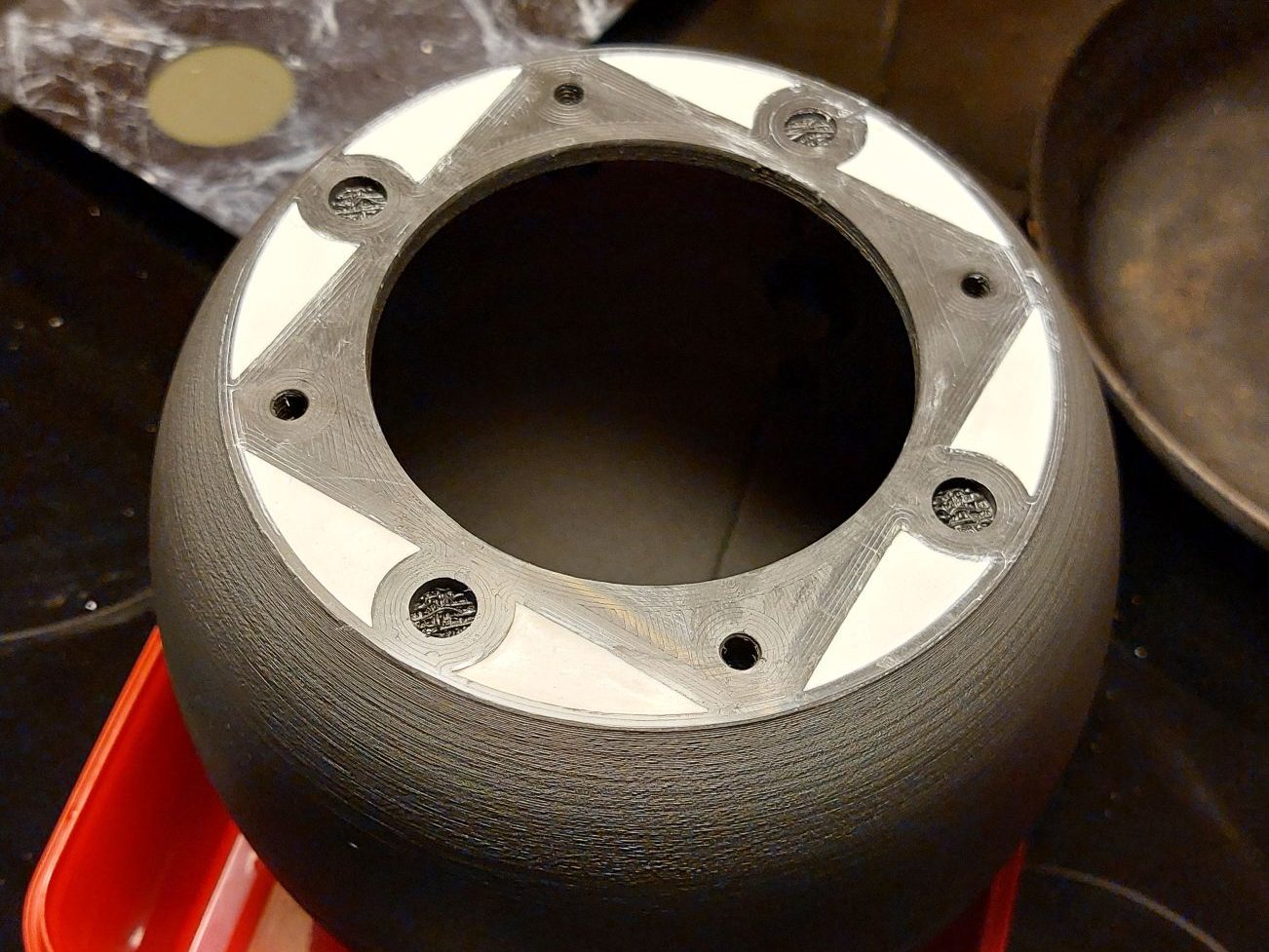

With the print done it’s time for the plaster to be added. The ratio i ended up using after some testing was:
This is just enough to fill one speaker if you don’t make a mess… after about 45min the plaster should be hardening and burning a bit warm. When it’s start so cool off again it’s possible to handle it and continue with the mounting.

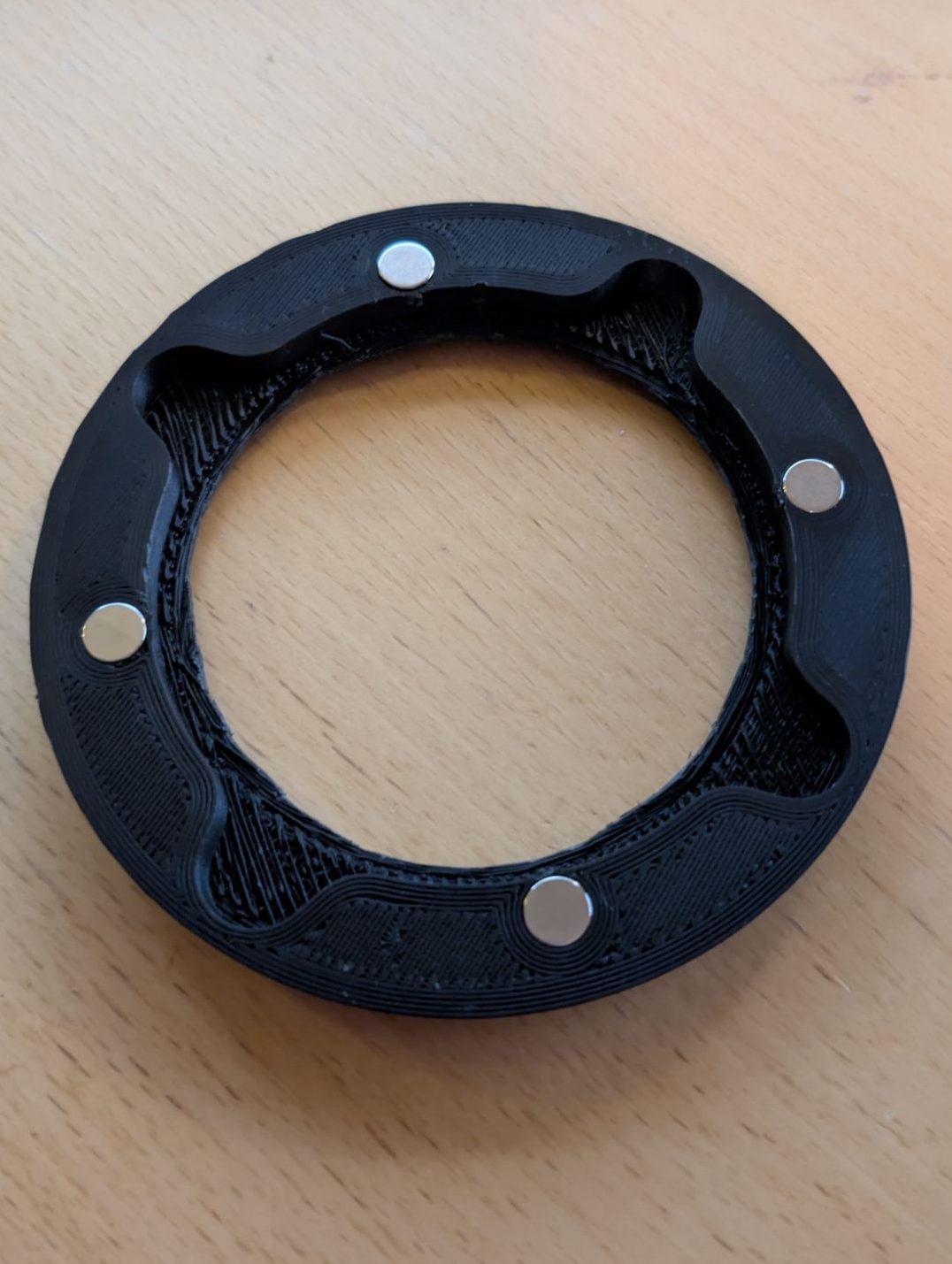

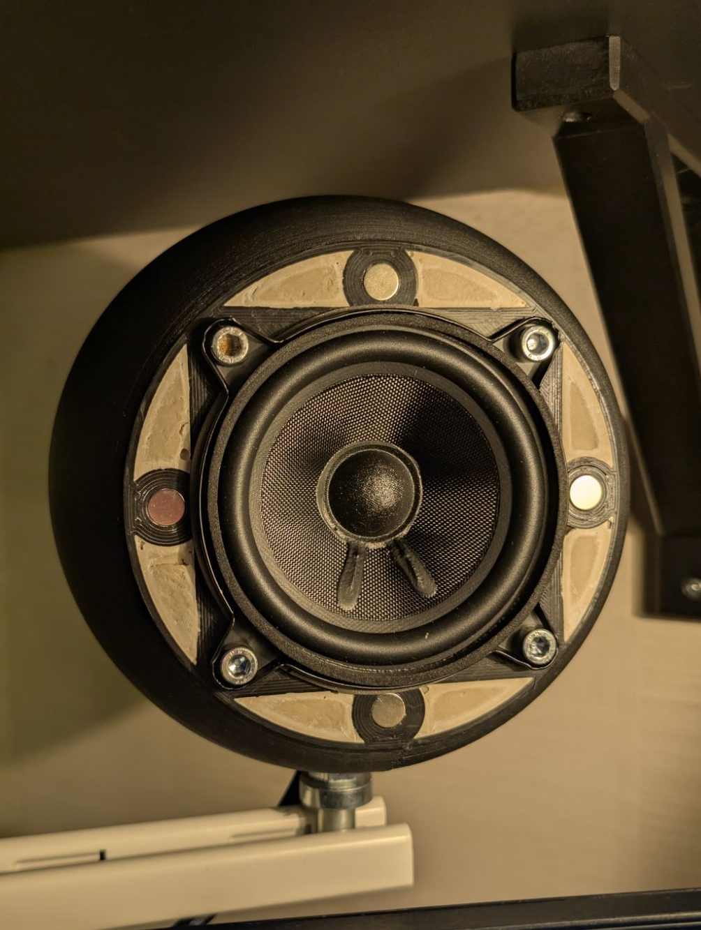

The front of the speaker is attached with magnets so it can be easily interchanged and experimented with. Due to some issues with the support, the centre hole didn’t end up so nice the first time around. But the magnes have plenty of power to stay firmly regardless of how the front develops.

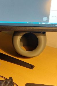

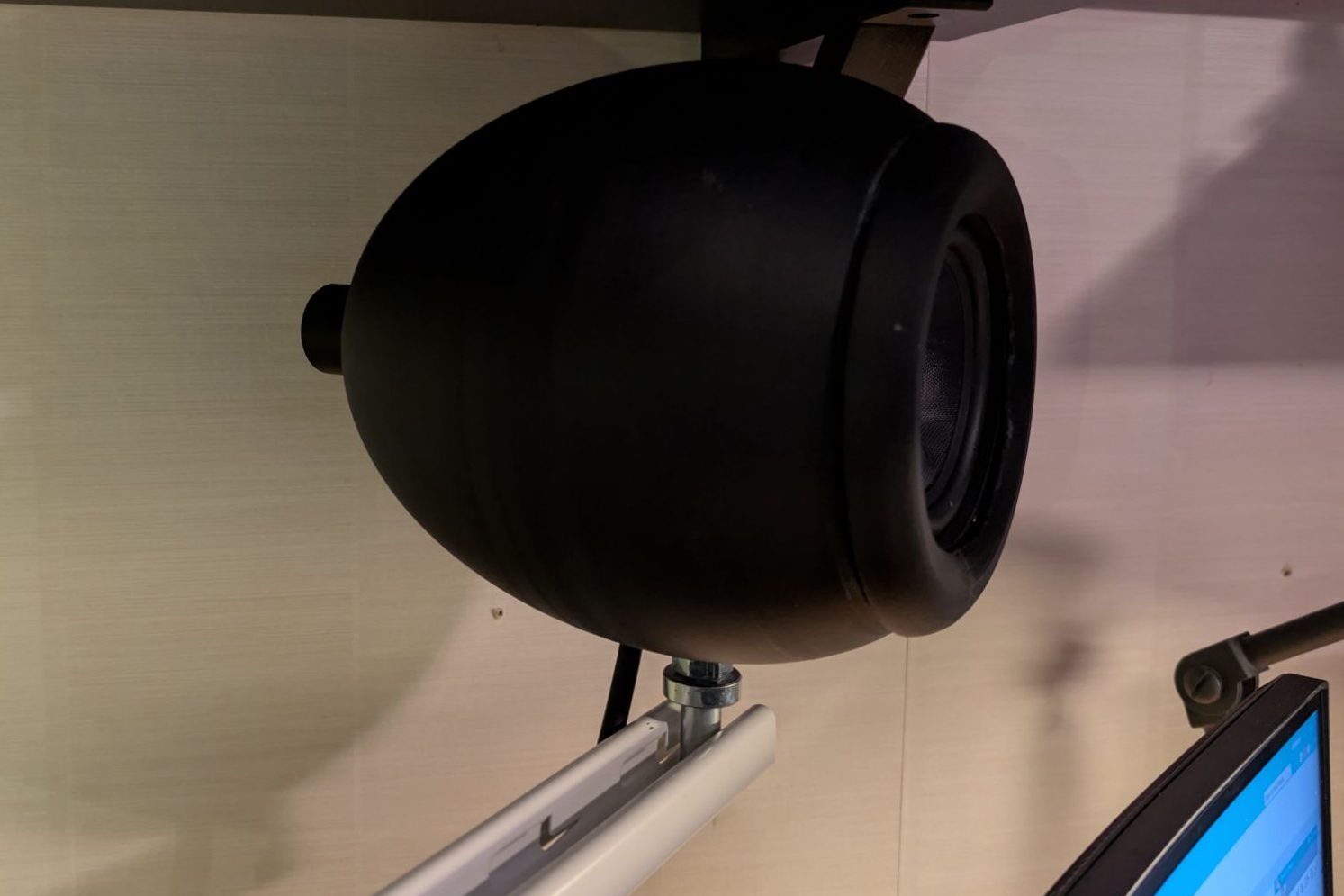

To save space in the desk the are mounted on a spare IKEA Algot bar on the screens camera / Microphone nut, at the top of the screen stand. It threads in to a M10 nut that is super-glued in to the egg. The M10 nut can be mounted on a normal microphone stand as well, even though its not optimal.

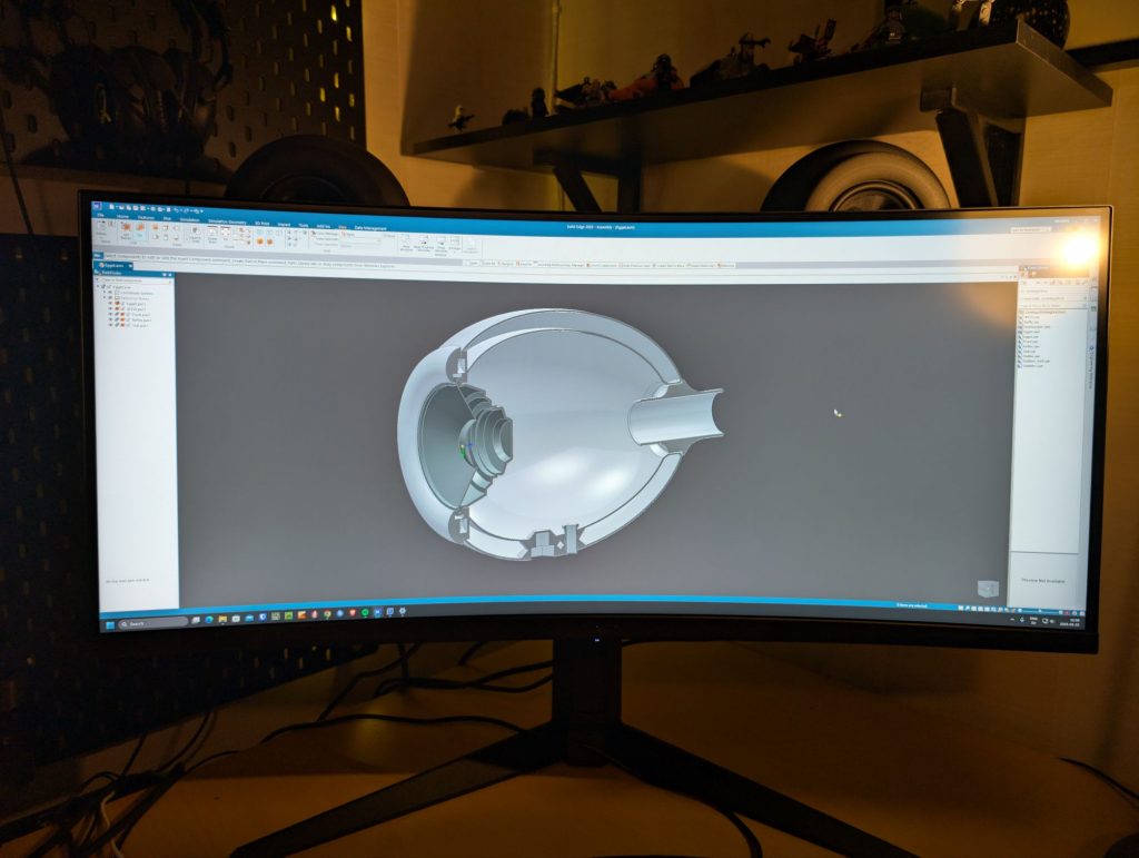

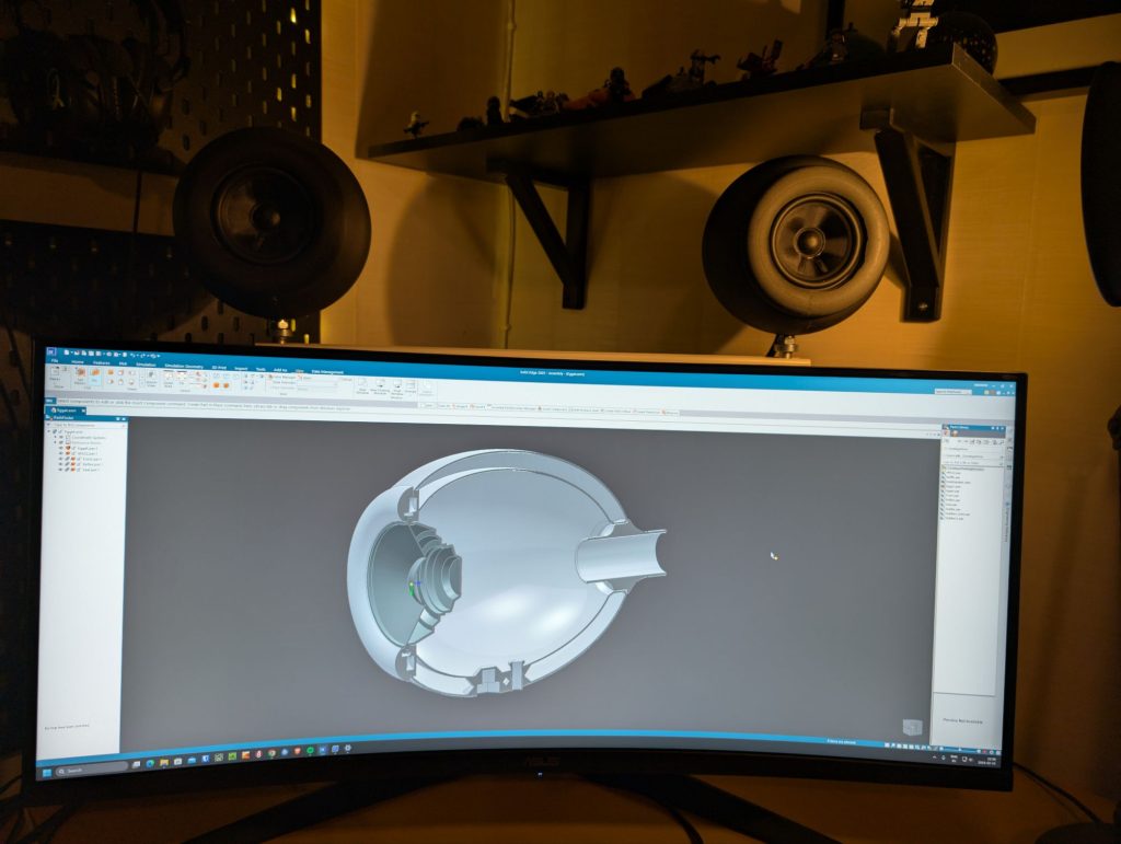

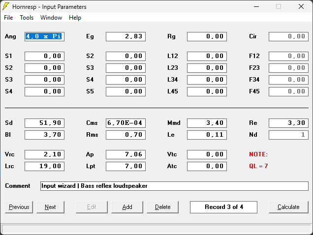

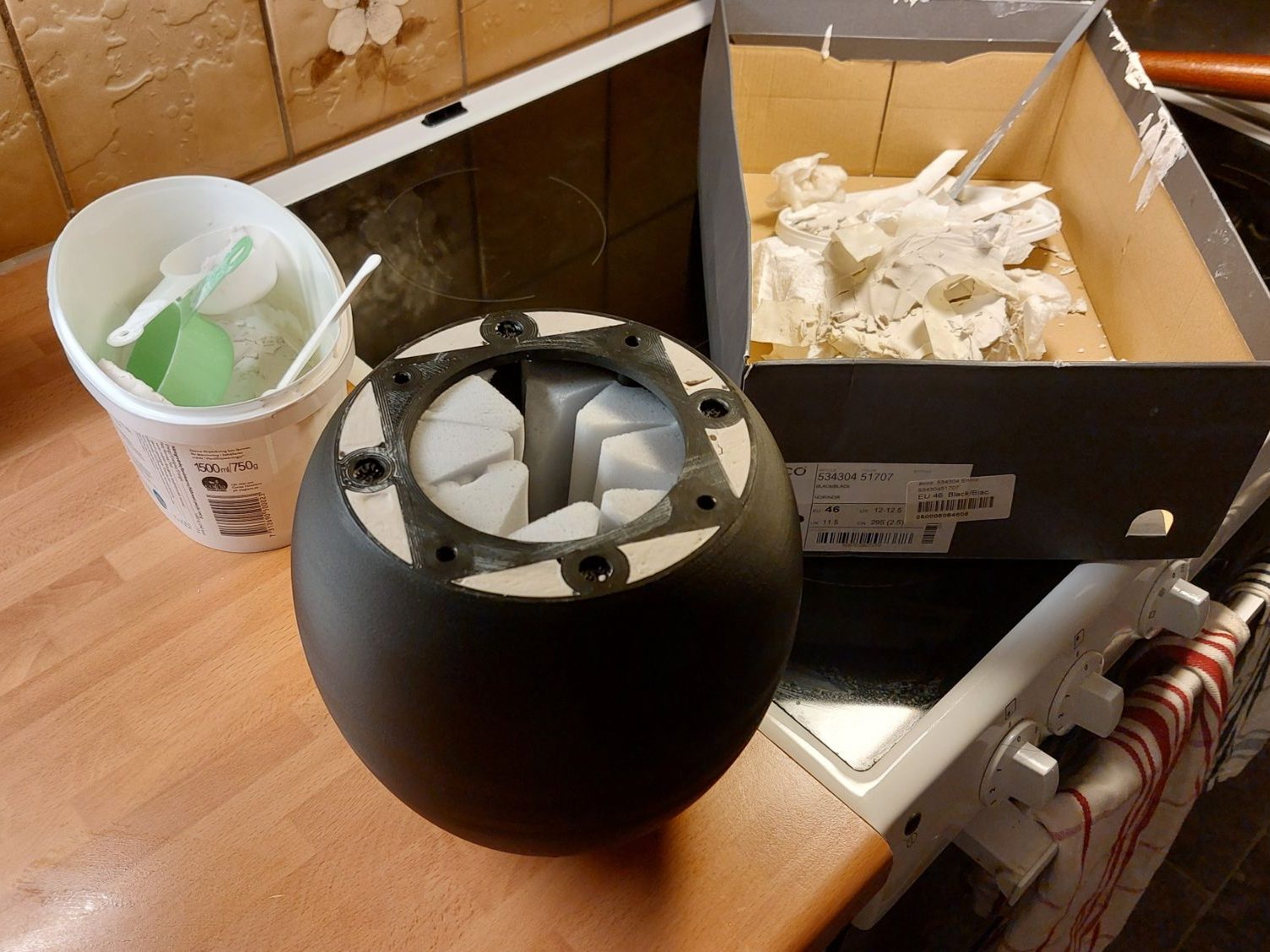

- 1100g Plaster
- 610g Water
- 110g PVA Glue

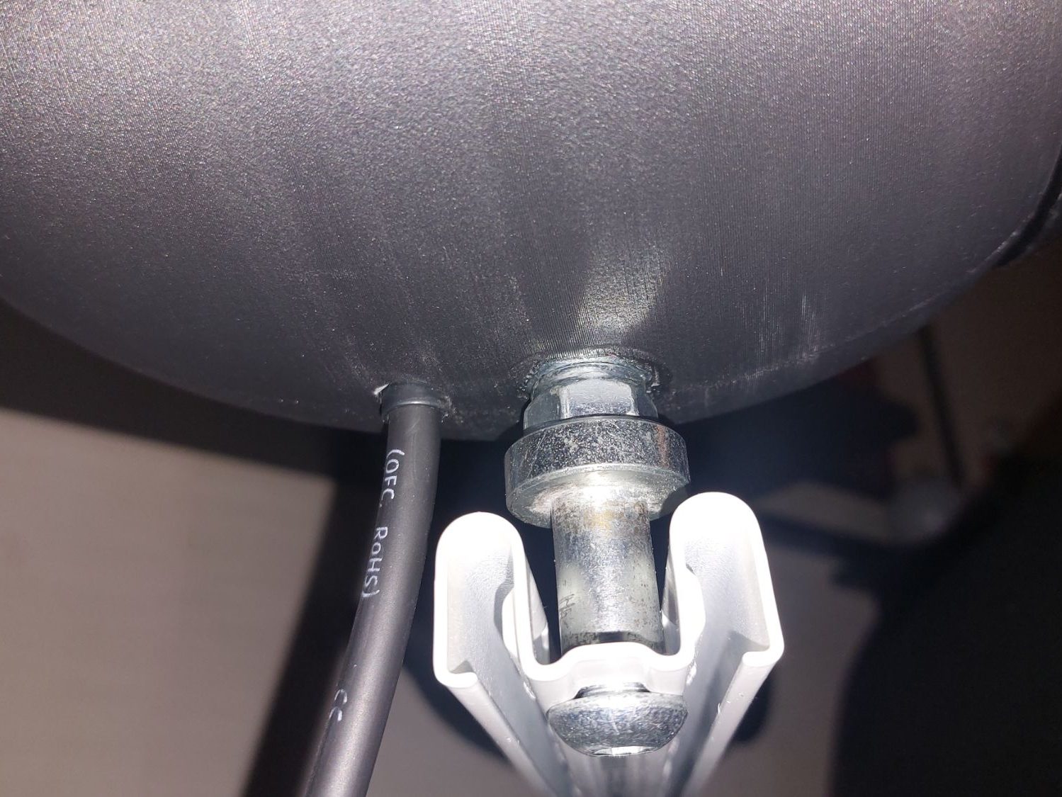

Seal and mounting
For the cable connection, i have a TPU 3d printed part with a slight conical shape, meaning that if you make a knot on the cable or a as ziptie or similar, the more you pull the cable, the more it will seal. This will aslo make it possible to have different cables and just remake the seal accordingly.

It started with fullrange intentions, but as you see it did not end up like that when i decided to go for "one print" instead of connecting several. The corner helps and i am awaiting a DSP to make the final adjustments. But the sound stage is great!
I did not consider anything else than plaster, since as you can see in the pictures above, that i have the plaster surface "Exposed" so no need to handle anything that isn't solid.

When they are suspended in the cable they point horizontally so all needed for that is a hook in the ceiling 🙂
Could be sand then some kind of whatever to close the top. But plaster is not bad for acoustic anyway. I tried printing with big nozzle like 2 mm but did not get watertight print
