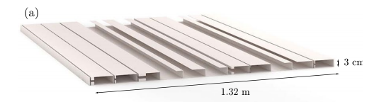

I ran into this paper - broadband diffusors that work up to wavelengths 46x the thickness of the diffusor. Looks like it would be a feasible 3D print (in a number or sections to get to the 52 inch width).
675942d1524086724-magic-metamaterial-diffusers-slice-png
See in particular, page 7 and table 4. (The deginitions of the parameters in table 4 are shown in Figure 1).
https://www.ncbi.nlm.nih.gov/pmc/articles/PMC5511165/pdf/41598_2017_Article_5710.pdf
These could be made into wall hangings only a little over 1" thick and work down to 250Hz! Get some grille material the same color as the walls and should be an easy sell to significant others who would hate traditional diffusors. If I work up the STL files, I'll post them.

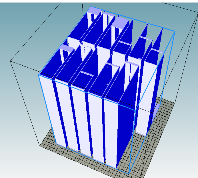

And here's the complication with that -- I made STL models for a 1ft high slice of this (in 11 prints of smaller parts to be combined) and the print time for that, with every speed up trick I could do, is still 28 hours. And that's with a 1mm nozzle and a 12"x12" bed. So, not a small project.
I may still do it, since my printer mostly sits there doing nothing most of the time. But to get to a 3ft x 4.5ft panel, its like four days of printing!

Yeah, and the structure doesn't look good for molding, or even extrusion for that matter. I'd be afraid of the overhanging wall things resonating. I put little bridge struts every 3 inches or so in the STL model to try to avoid that. Maybe some flat supports (or a screen?) could be attached to the top to keep it stable?

You are right, structurally it "flaps". The resonator slots need little fillers every few inches. A few columns inside the larger resonators to support the faces.
I'm thinking that maybe a sheet of 'hardware cloth' (square grid largely open screen') could be glued across it to tame it all down, without too much added labor effort.
You might be right about using board strips, additional length is nearly 'free' (labor wise) doing that. Note that in the model the thickness of the walls is under a mm! I did them all at 1.2mm (about the thinnest I could get with a 1mm 3D printer nozzle). But I suspect that could be cheated substantially.
