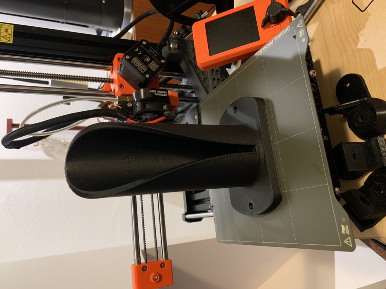

Working on my multicell horn and reading of some other K threads lead me back to the idea of trying out a K-Tube on my JBL2445. There are 4 models attached - single and dual slot, each in two lengths. The shorter one is around 1/4 of 500 Hz wavelength and the larger one is maximum size for my QQ-S printer. I will start printing today so that they are ready for the big polar measurement race between multicell, 2380 clone and K-Tubes (scheduled for mid October due to work travel🙁 ).

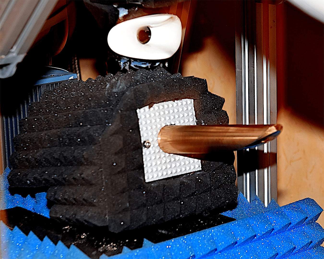

some pix (I don't want to walk over Reinout's thread by showing them)

The tube construction shows potential immediately and almost any shape I tried was good. I mighy actually try a 110 Hz round tube by scaling this one up again - I really like the MDD style speaker, so a K-tube could work for a 2-3 way as a front load for the 3FE22.

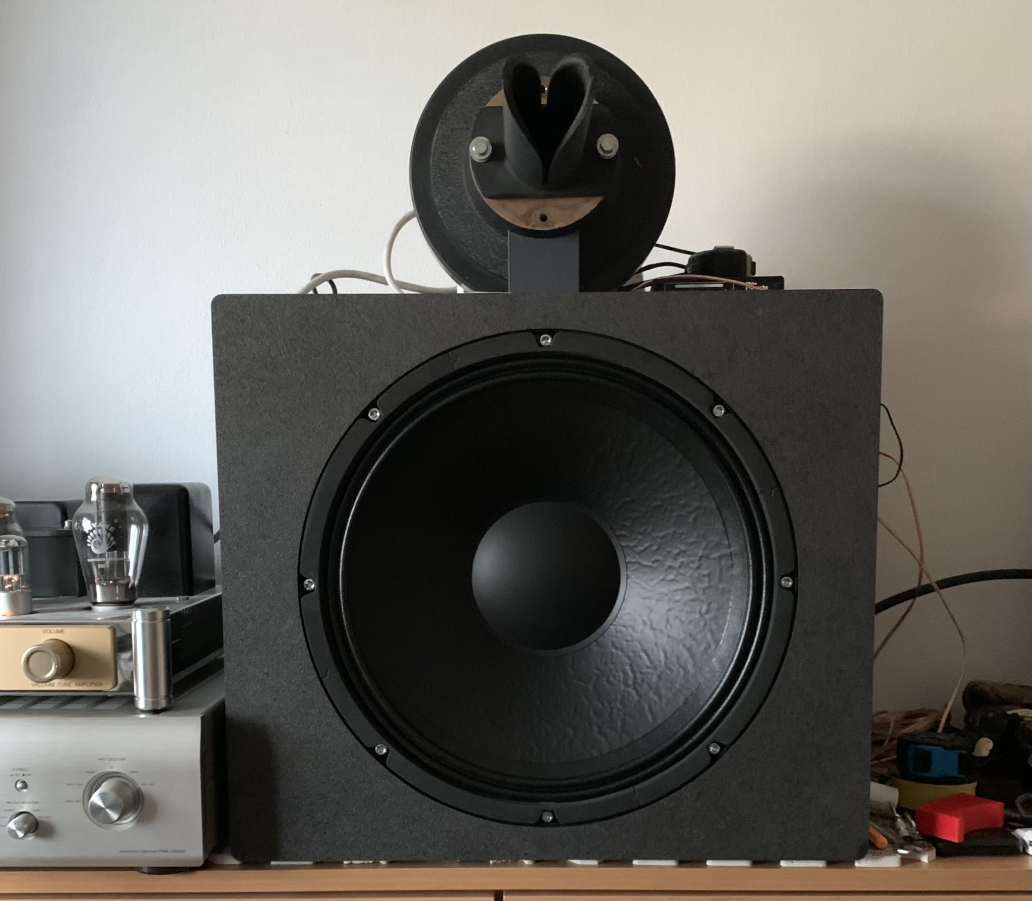

I got an idea. A K-Tube could be very easily integrated into the Tumbling Dice horn: (new adventures in) ultra‑fi: tumbling dice: experimenter’s lower-mid horns
It would just be plugged in from the bottom.

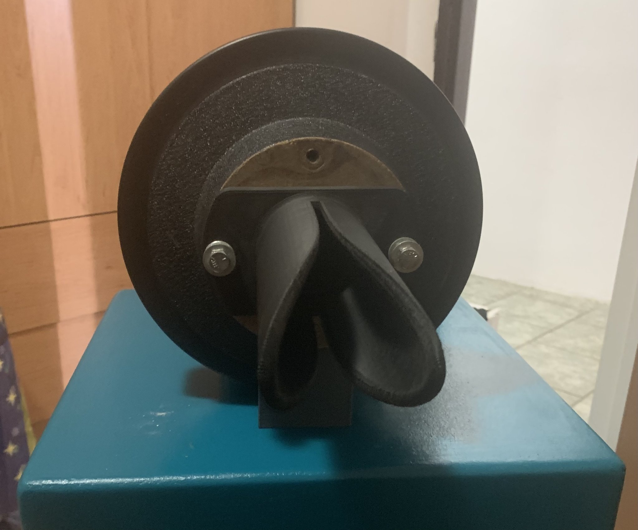

I had a few minutes for a quick mono only test. First impressions - it works, sort of🙂 The FR starts to drop below ca 1100 Hz. It needs to be pointed at the listener, otherwise the high end is reduced. I cannot much comment on the sound other than it is OK.
I would like to get lower loading on the driver, which means a longer tube.

AH - the double slotted tube ! = interesting the way the slots are oriented ("top" & "bottom") - I'm using a 9.5" single slot tube.

Yes, higher loading to play lower. I will try to print a longer tube, both single and dual slot.
Curious how long it needs to be to play from 500hz or 700hz for that evdh1a you got there is there a formula you don't mind sharing for 1in and 2in compression drivers about the length needed for specific frequencies
The driver is JBL2445 and the tube should be at least 1/4 of the lowest wavelength. I think since it is dual slotted, the effective lenght is shorter. All the tubes I have made are based on exponential slot expansion and are scaled from the first 1" model.

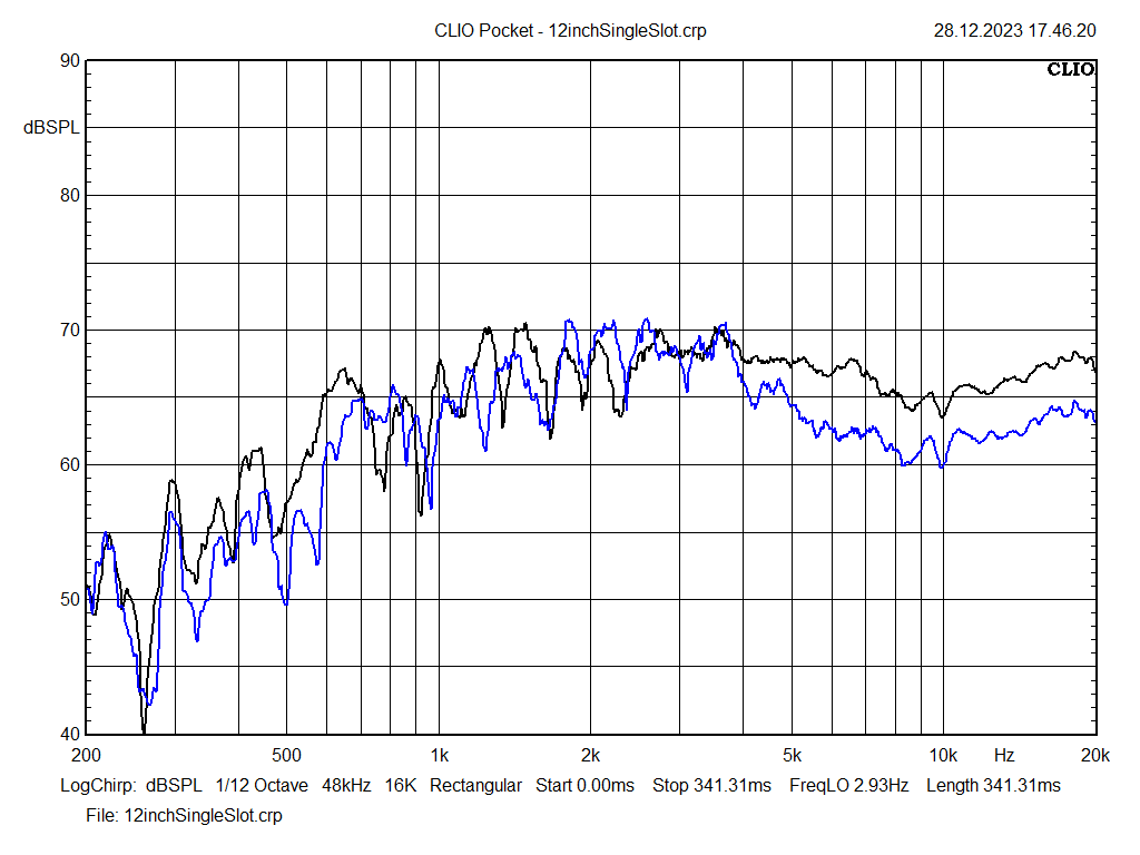

A longer (12.5") single slot tube...does load a bit lower lower. This picture shows a bare driver (blue) vs with tube (black) on axis. In room, 1/12 smoothed.
The ragged low end is most probably due to the in room measurement, but maybe also due to pipe resonances. With EQ, 600 Hz would be the lower cutoff. The interesting feature is that the HF is actually elevated on axis and it would make the JBL2445 play up to 20 kHz in a very narrow sweet spot. Not sure if that had any practical use. The dual slot tube is being printed, but I do not think it would be much different. I think this will be the last K-Tube experiment for now, since I can get much better results with horns and direct radiators. I could see some potential use for tubes above say 2 - 3 kHz as a relatively narrow tweeter - it might actually work really well as an ambience tweeter, making the reflections more random.
