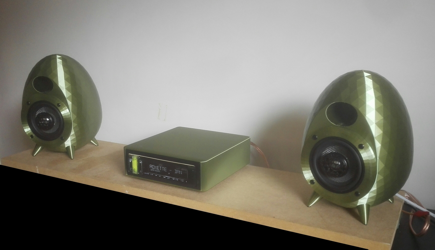

I made these 3D printed egg speakers about a year ago and now they are ready to be posted (many things had to be worked out and tested), many color variations can be made 🙂
Sound with the sioux unit is very good, well Make: Magazine posted them as Audiophile speakers, i have been using these units for 10 years and have never found anything that comes close to sound and price, just needs a tweek with a small upgrade to treble crossover
3" Egg is based on the W3-871SC unit, good sound but very little bass, with a sub they would make great satellites and they are cute, have been thinking about doing a 2" also

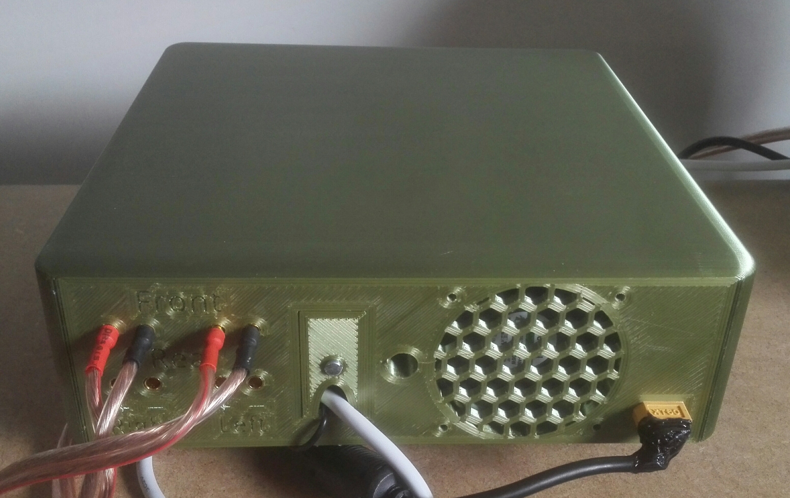

For now i have 3, 4 and 5" sizes but more will come later, TDA7294 + Transistors will also be in various versions + Class D amp(s) in 3D printed cases

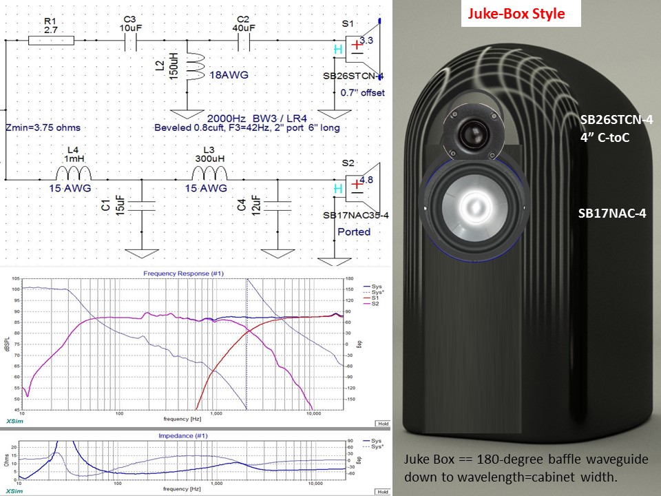

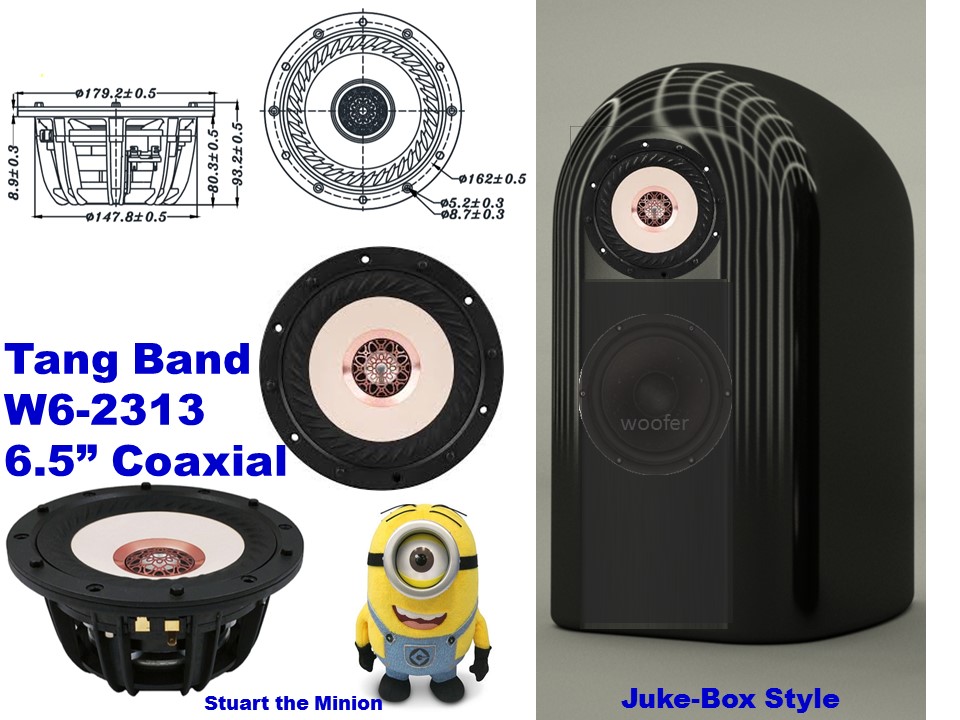

A "Juke Box" shaped cabinet looks interesting.
For desktop speakers and music monitors located near the walls, it can be desirable to create a baffle shape which produces mainly forward directivity down to wavelength=cabinet_width, and also has large radius quarter rounds to reduce edge distortion on longer wavelengths.
Juke Box = 180-degree baffle waveguide down to wavelength=cabinet width. 180-degree baffle waveguide up to tweeter's natural beaming.

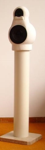

Somewhat similar to the spherical concrete speakers I made back in 2000. Sphere-like shape is wonderful on the outside, gives smooth baffle step, but terrible on the inside, because almost all dimensions on the inside are the same giving a terrible standing wave resonance. The egg might be somewhat better than an exact sphere though. I ended up stuffing the inside of the sphere heavily with polyfill for the closed box version, and installing a tilted inside wall that cut the inside into a half sphere in the ported version to reduce the standing waves.
