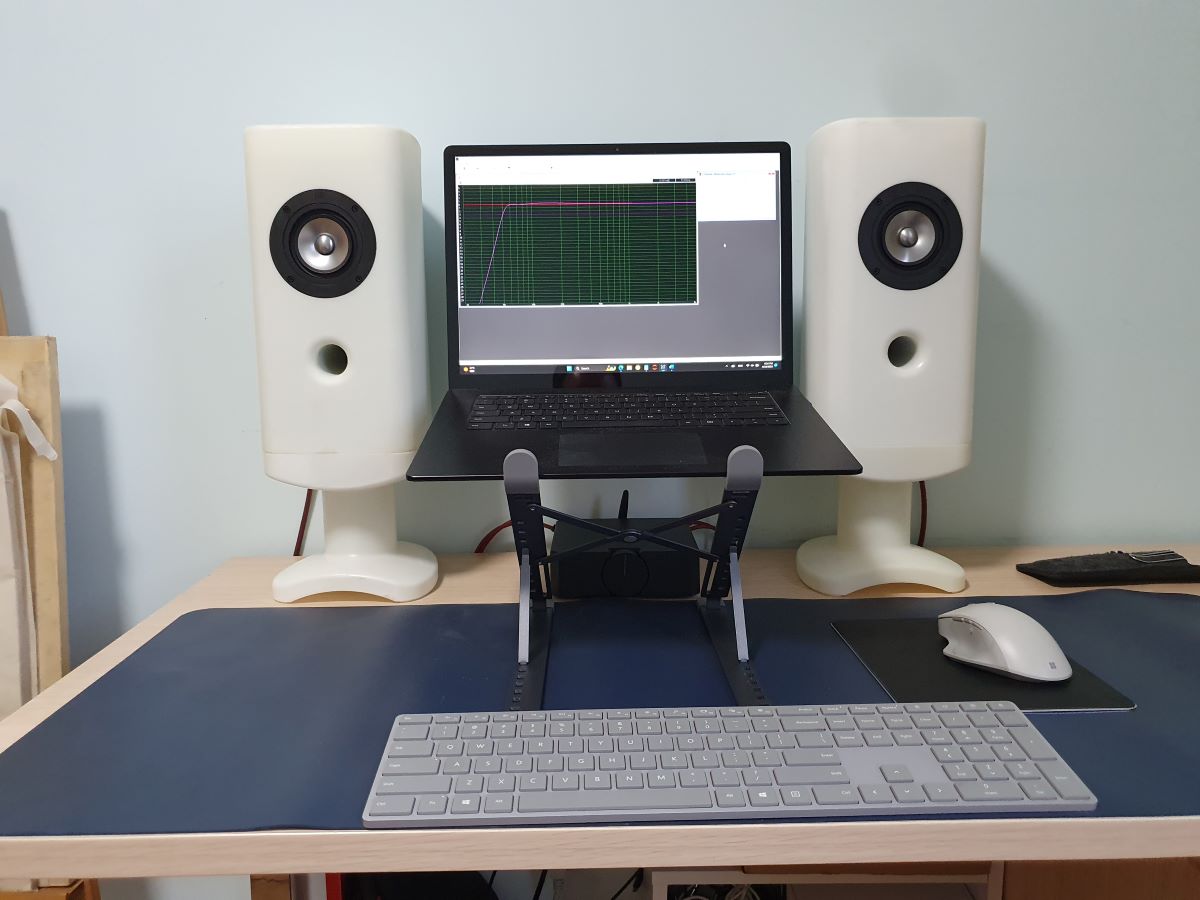

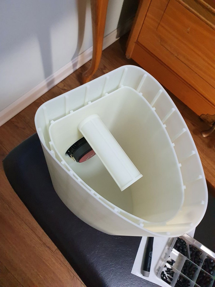

The drivers are Markaudio Alpair 5.3. I used WinISD to create an EBS3 alignment which turned out to be 4.4 liters tuned to 58Hz. The cabinet design calls for a bit of EQ at the bottom end: 2.8dB at 74Hz with a Q of 0.707

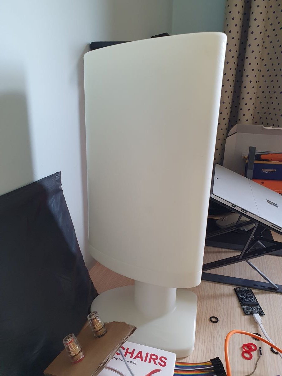

Above is the "final" design. There are some aesthetic points and a few printing issues that I'm not 100% on board with, but overall I'm pleased with the way they turned out. Waiting for paint...

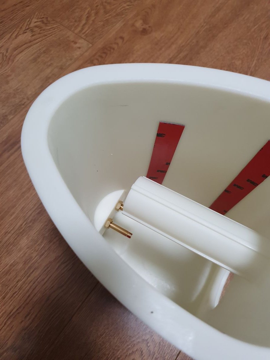

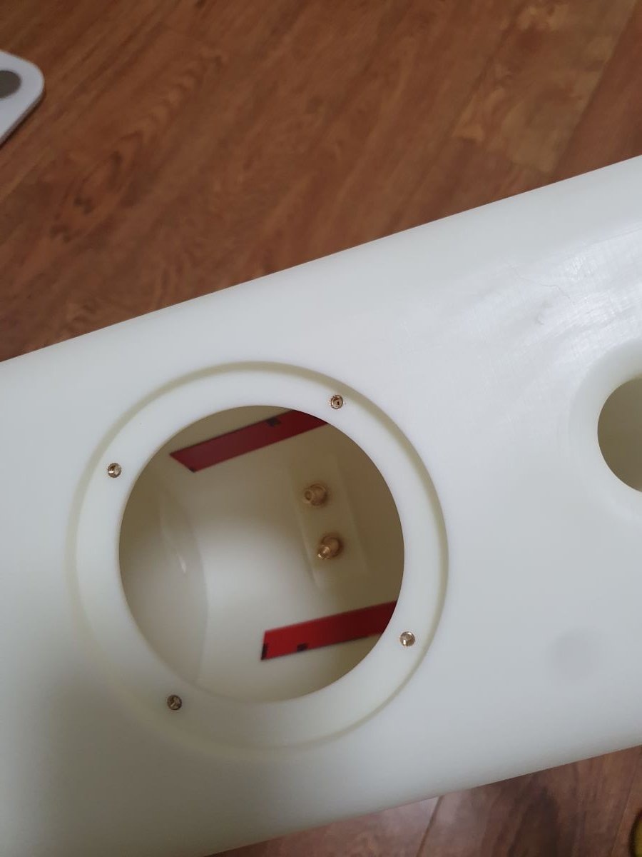

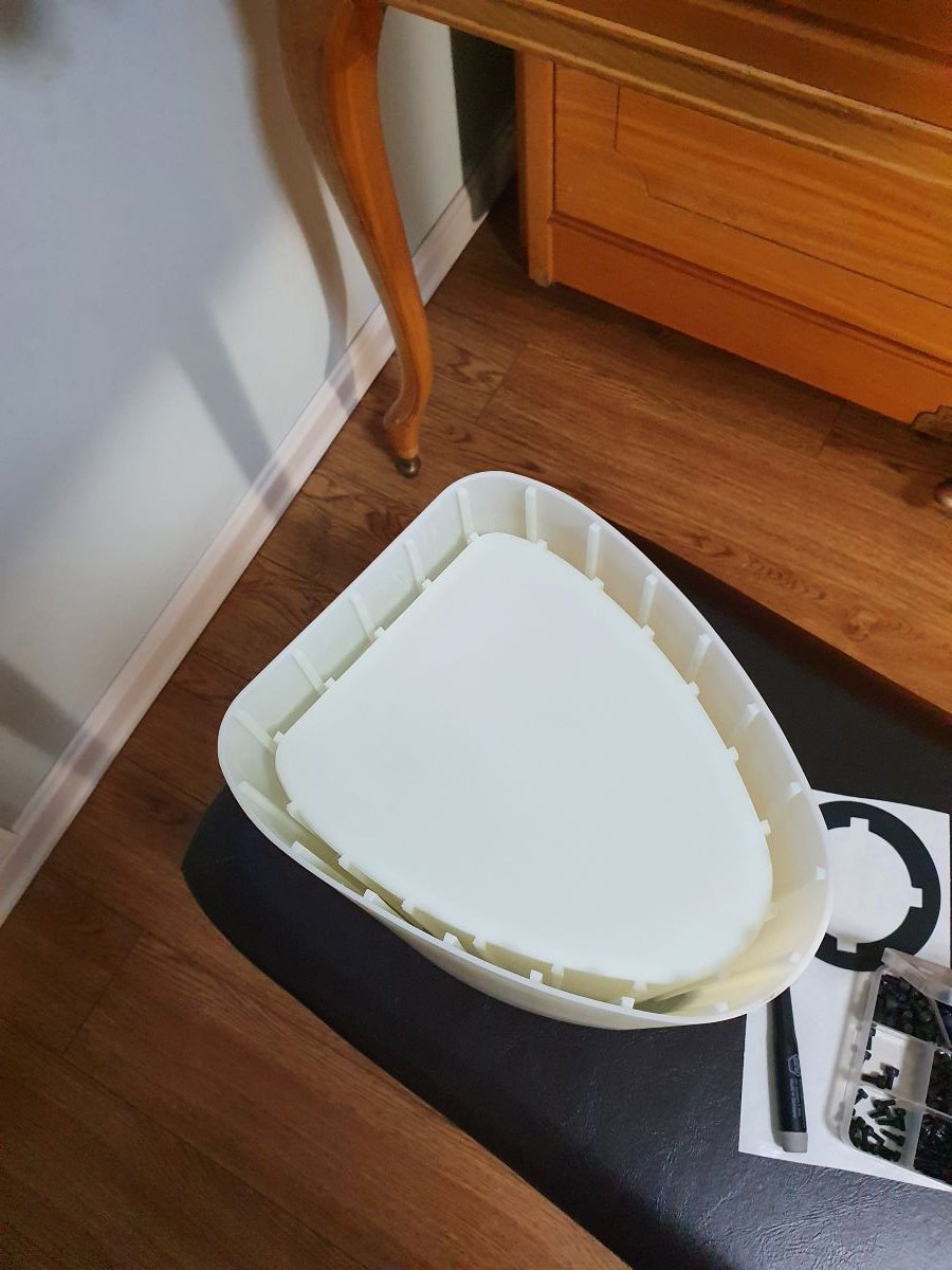

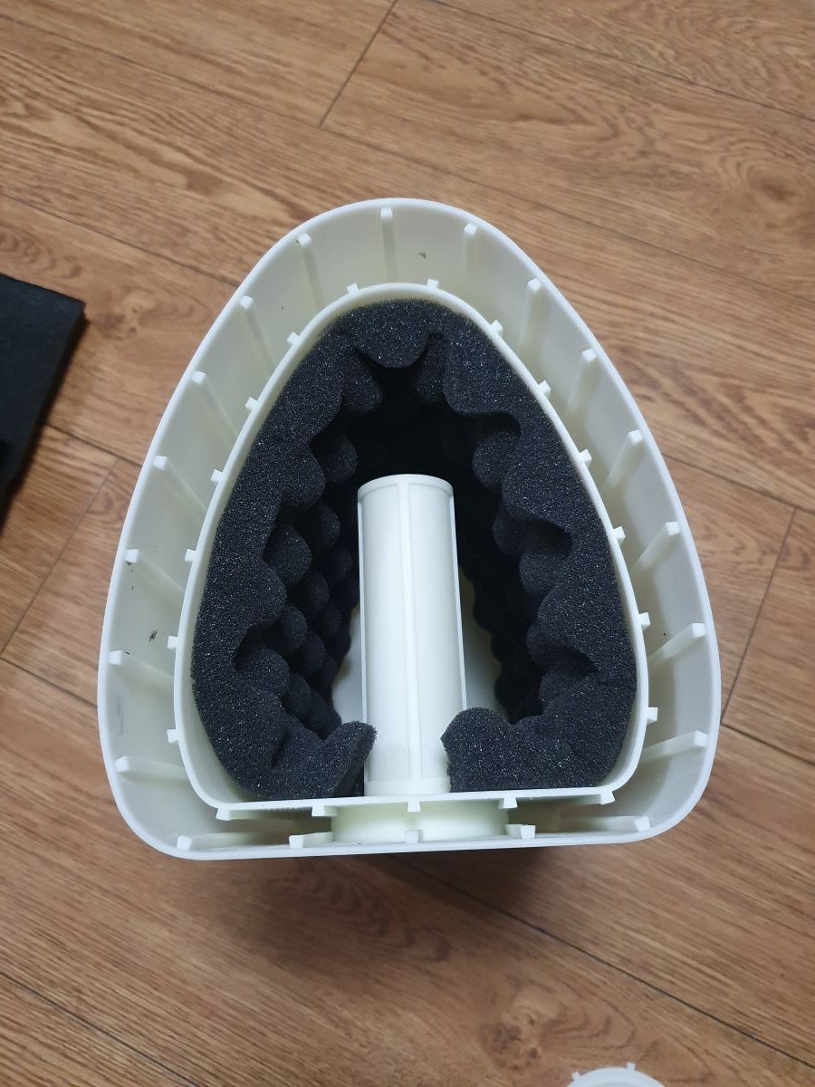

The design shown is a two piece (top and base) hollow printed design. Meaning I designed each part as a solid piece and the printing service I used removed extra material in order to have a hollow closed shell as opposed to the prototype which I designed as open shells to be printed solid and closed with covers (see attached). It saved a bit of money and hassle giving the solid design to the printing service and letting them adjust as needed. I intend to fill the hollows with epoxy resin at some point but it feels like a little bit of overkill for now. They are lined with eggcrate foam, connectors put in place, wired, and then the top is press fit onto the base.

Just FYI you can probably fill the voids with concrete/cement instead of resin if you want. I looked into it (for the same reason) and concrete does not need air to cure! 🤷♂️

Yes. On windows using Equalizer APO. Literally design the EQ/filter in WinISD then transfer those values to APO.Awesome! I also have a pair of 3D printed 1-ways on my list for the near future. I assume you are using some DSP to EQ these?

Good call on the cement. I've been struggling with what exactly I was going to fill them with. I did order some resin but I've been hesitant to actually use it as I don't have a good space to do it and I know it's going to smell a lot.
