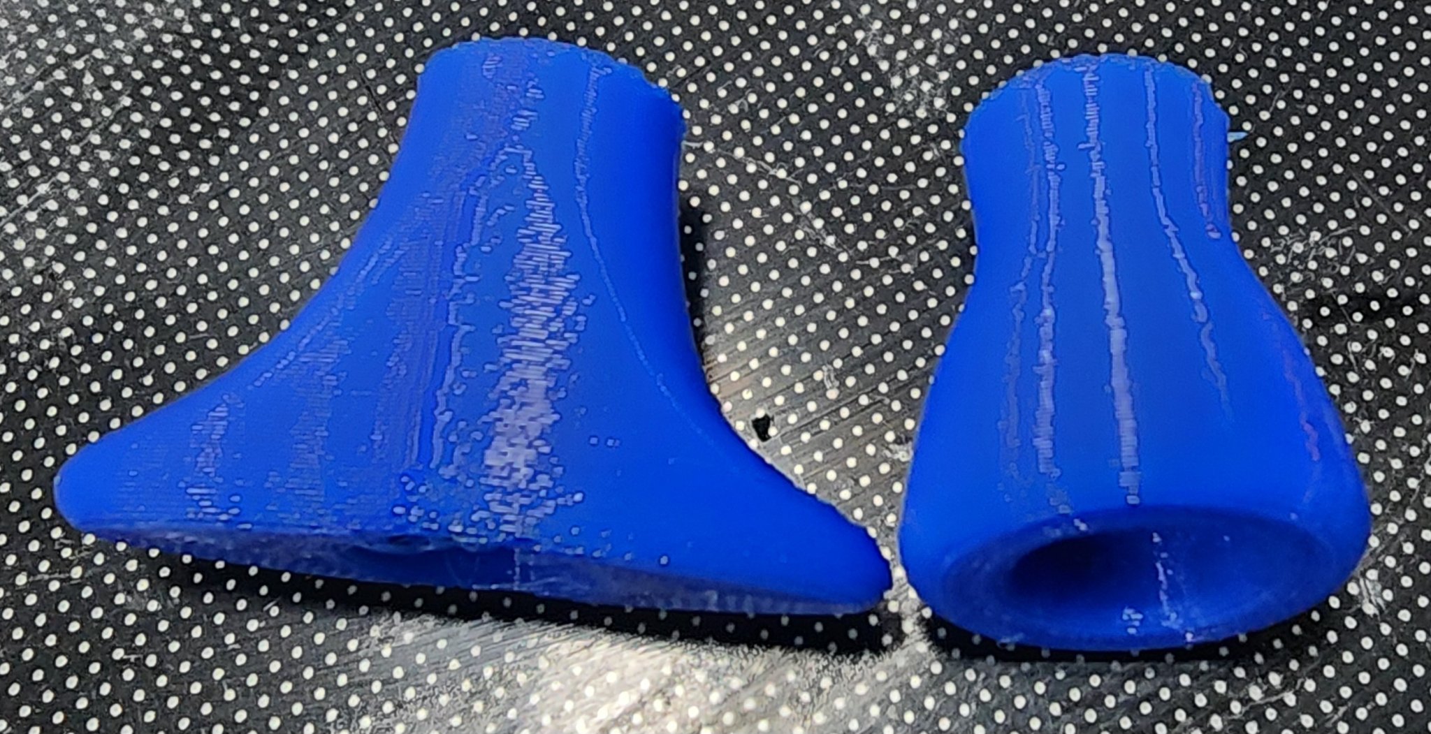

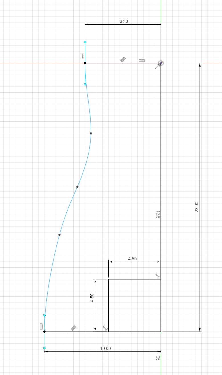

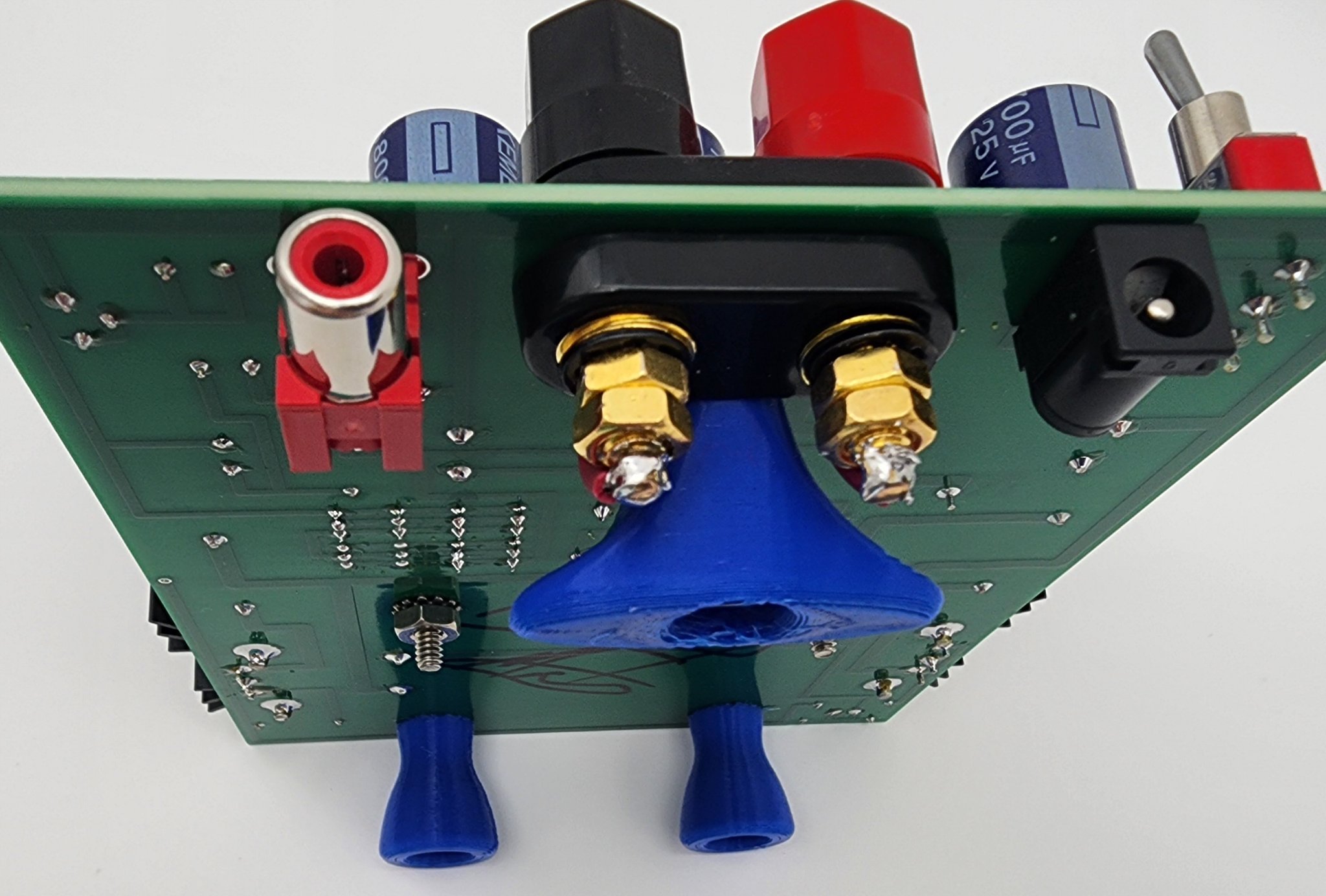

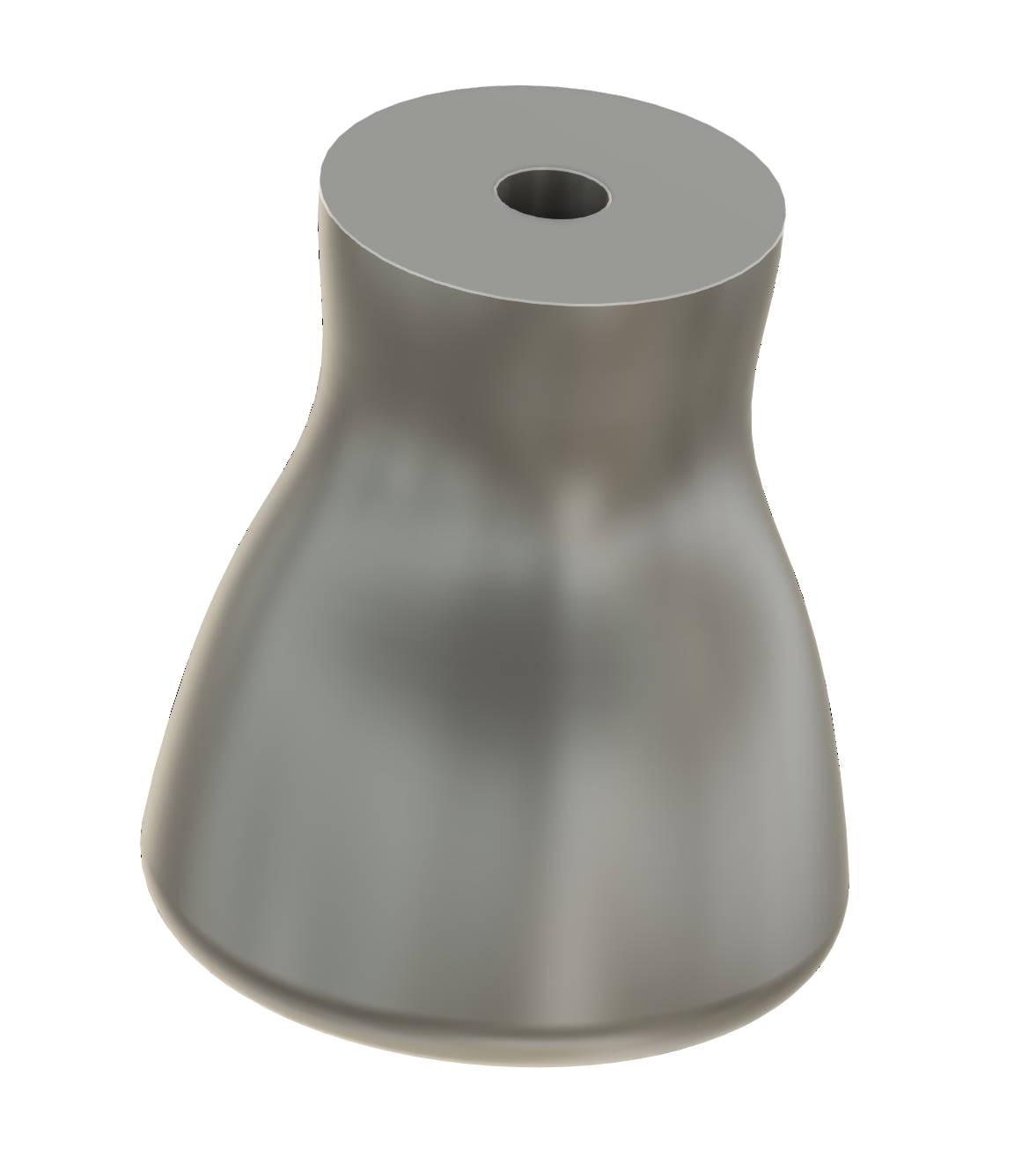

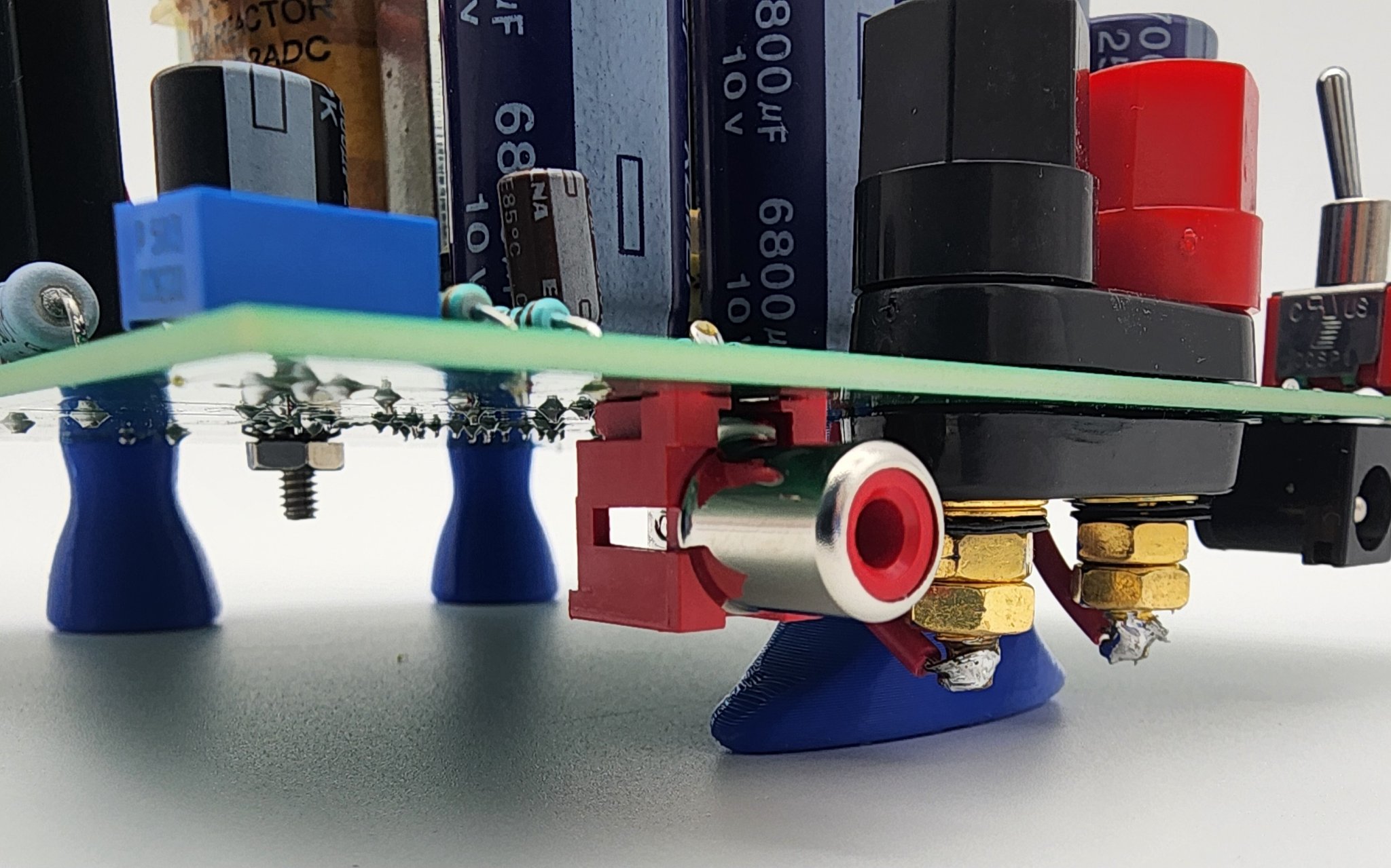

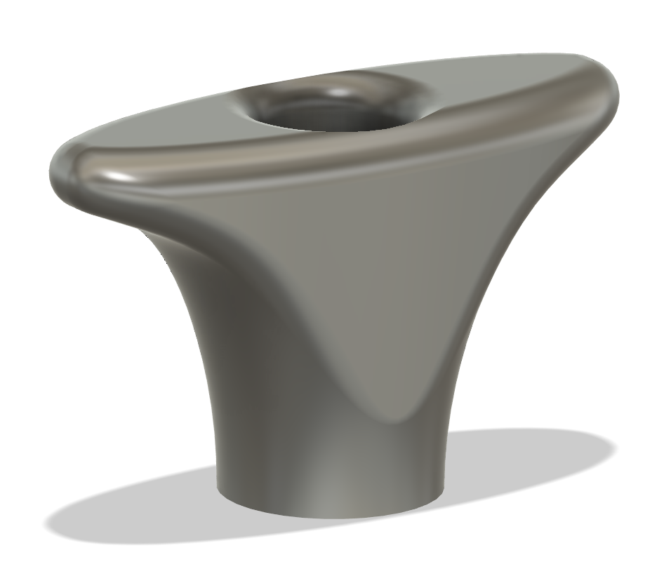

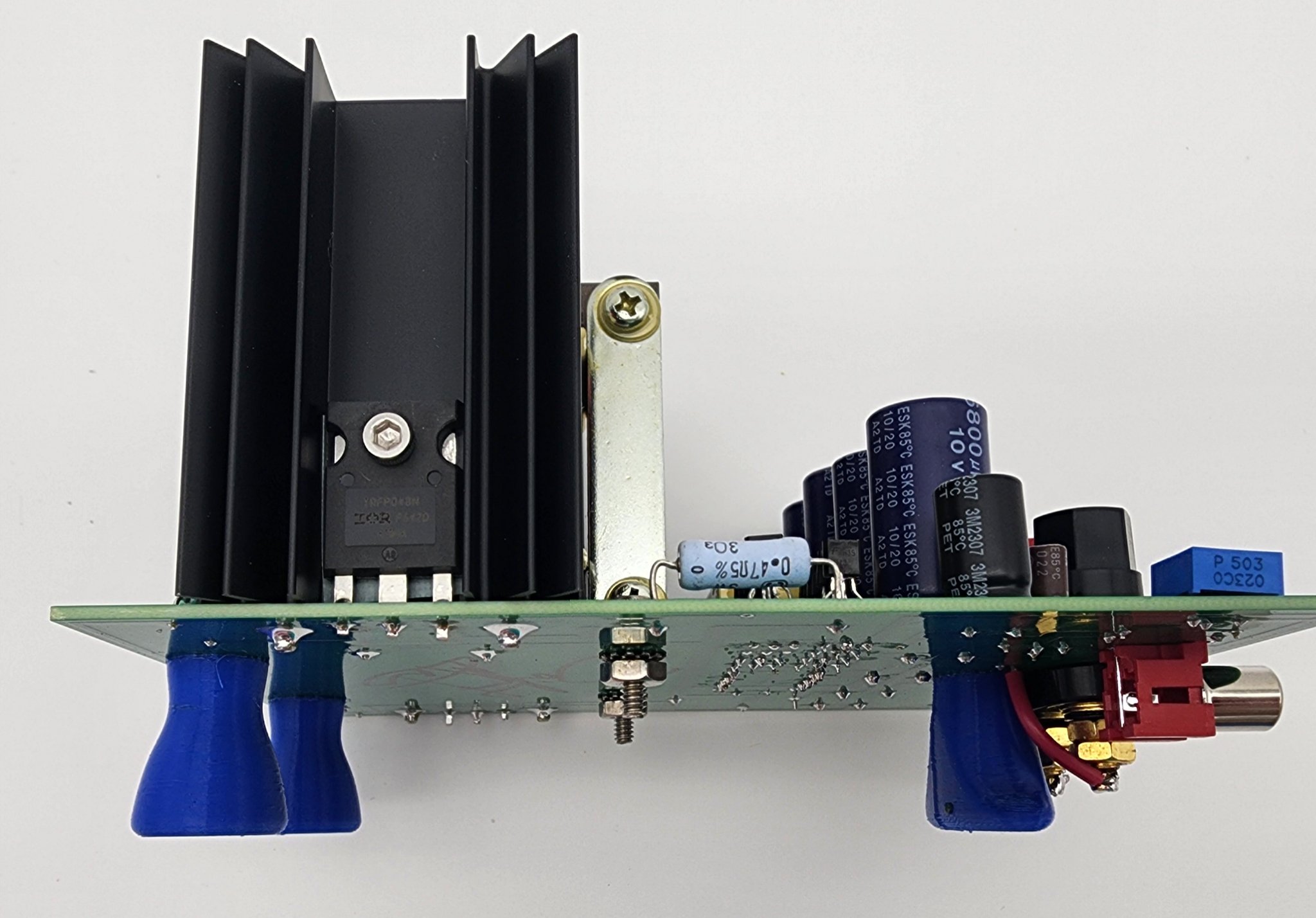

3D printed feet for the Zenductor II (and can be used with original Zenductor for that matter).
The goal was to both move away from the metal hex standoffs (both slippery and scratchy) and make a wider front post/foot for the tripod configuration (make it less tippy). The fact that it looks adorable is just icing on the cake 🎂

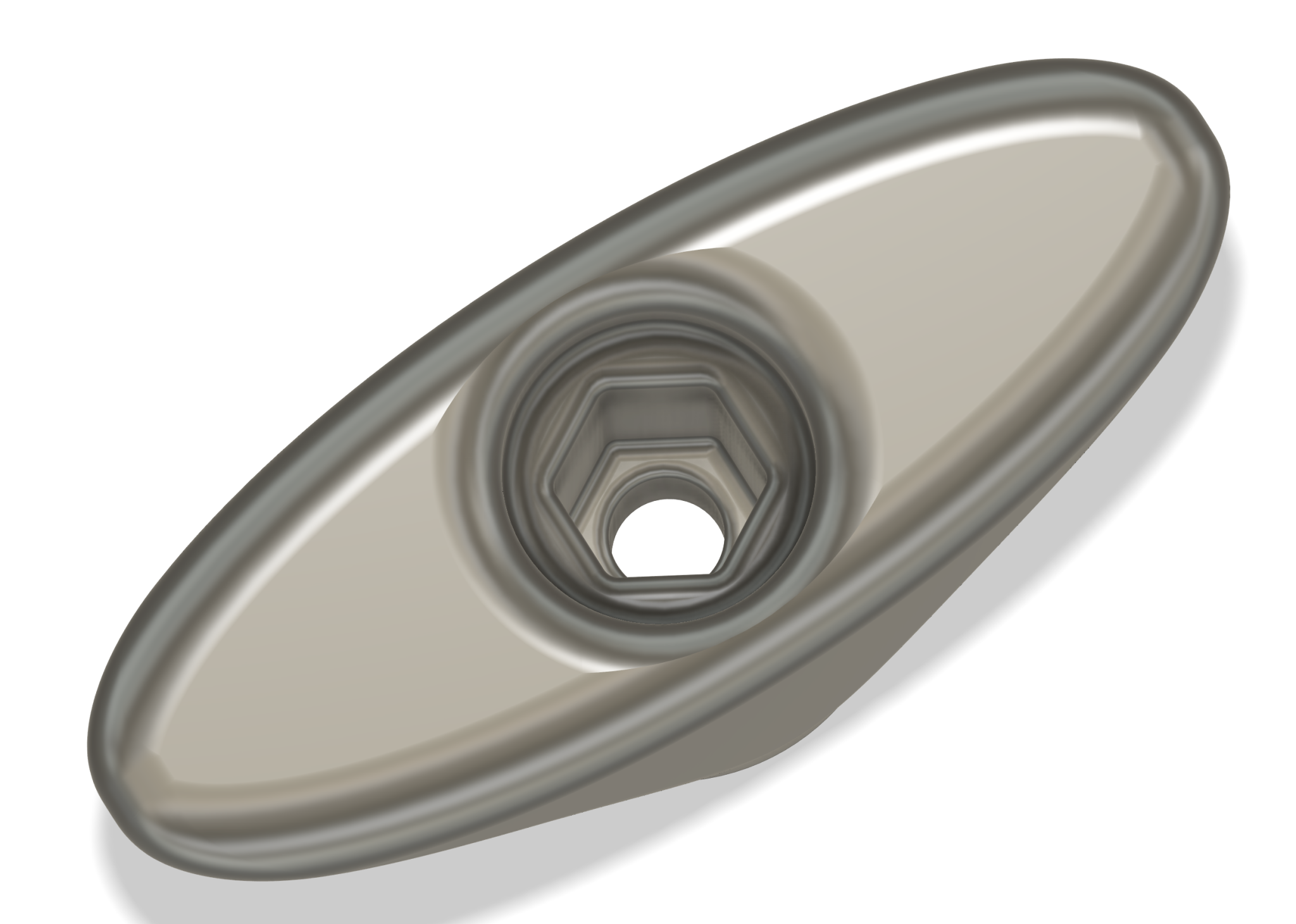

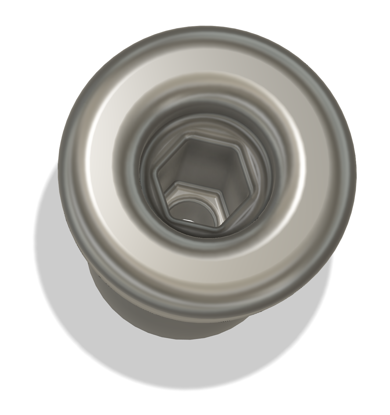

A standard M3 nut is inserted from the bottom (use a long m3 bolt to press it into the pocked) and a M3x10 (or longer) bolt is used to then secure the foot to the board.

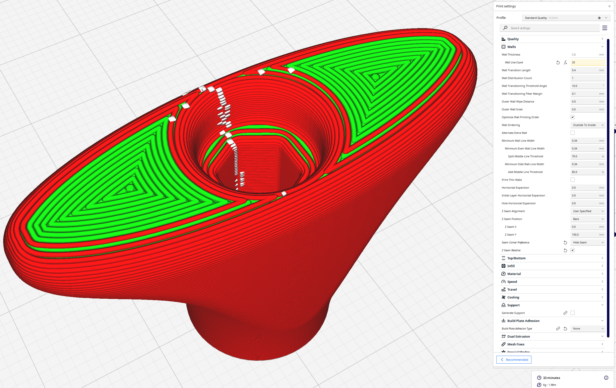

I printed solid with TPU, but PLA would also likely work (its not squishy like TPU though).
If anyone would like me to print these and send them to you with the necessary M3 nuts/bolts, I'm happy to do that for $10 shipped within the continental USA.
