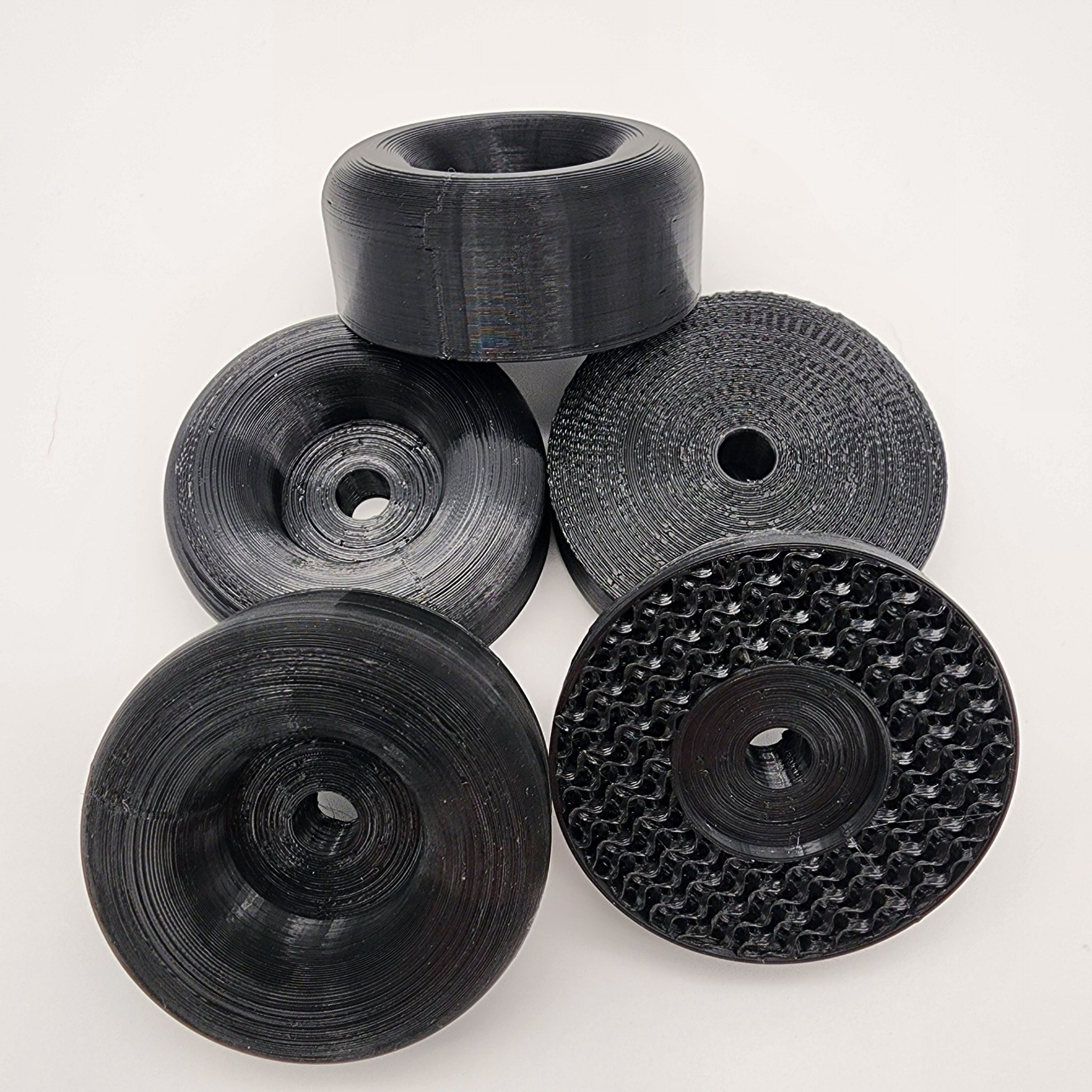

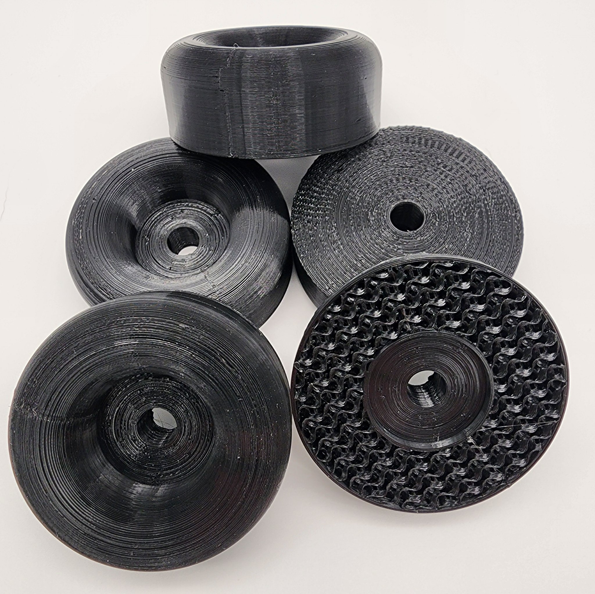

Here's the latest version I made based on dimensions of a commercial chassis foot for sale. You want to print using soft TPU (Thermal Polyurethane) to get close to the squishiness of rubber. Additionally, TPU has some grip (not as grippy as rubber, but works fine), whereas harder plastics like PLA and PETG are slippery and could scratch more delicate wood surfaces if used on heavy amps.
Suggested TPU Print Settings for Large Chassis Feet:
Here's the dimensions of these large chassis feet mimics from off the shelf rubber options.
- Temperature - Depends on your brand of TPU (I use around 220°C for mine)
- Walls - 2, or 3
- Infill - Gyroid, 15-20%
- Top/Bottom - Increase top to 8 layers at 0.2mm/layer. Feel free to do the same with the bottom layer if you don't mind a few extra minutes of print time, but not critical since it's in compression.
- I suggest using a glue stick for the plate adhesion, but if you know what you're doing, it's not critical to use, just a safety blanket for me since I print on flat glass.

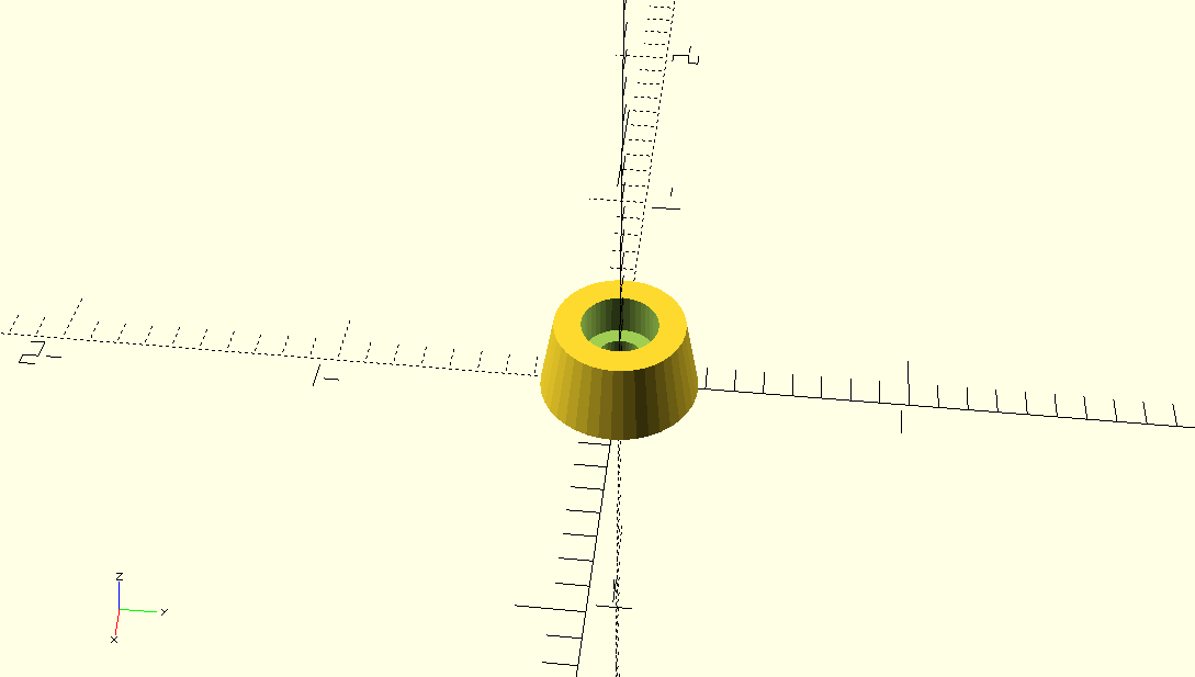

I've been using this design for a lot of my enclosures:
The hole is covered by a stick-on felt pad to avoid scratching whatever the enclosure is sitting on. This one was designed to accommodate 6-32 screws.

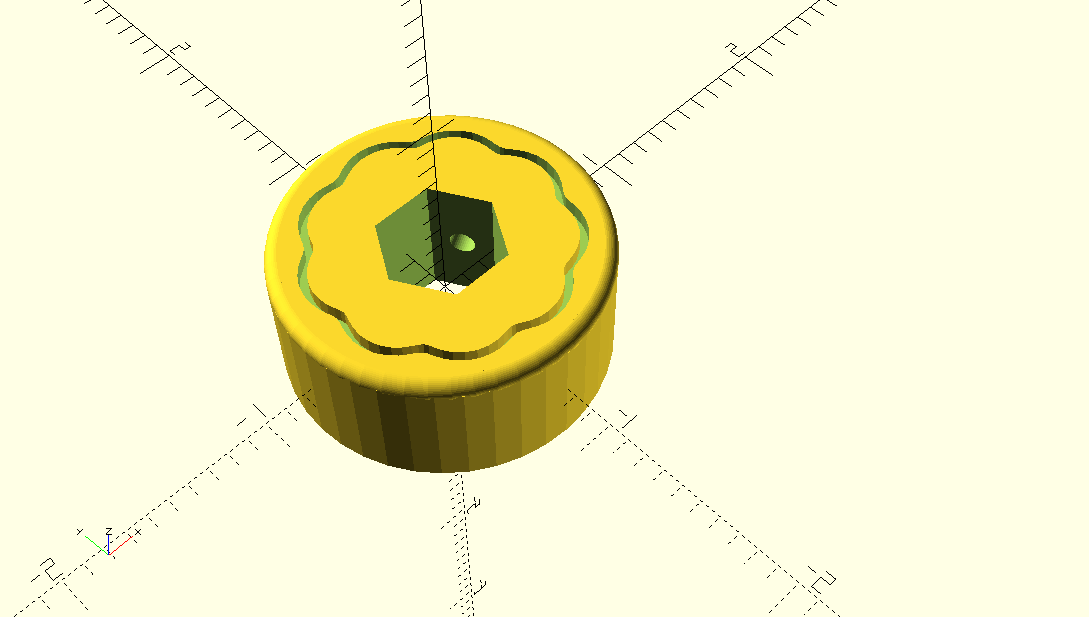

But the 3D printer applications don't stop there -- here's a control knob I designed:
The hex hole in the center accommodates a length of hex stock that is used to fix the knob to the potentiometer shaft. I'm using blue PLA+ which makes a nice contrast to the brass color. I also printed one in black, that will be fun to evaluate.
I also have printed board mount blocks for situations where the original holes in the PCB didn't work out. These all were designed using openSCAD.
3D printers are great for this kind of thing. I'm a recent convert and loving it!
I'd be happy to share these scripts if there's any interest.
BTW the control knob upper perimeter has been rounded-over using a torus form. That makes it look a bit more organic.
