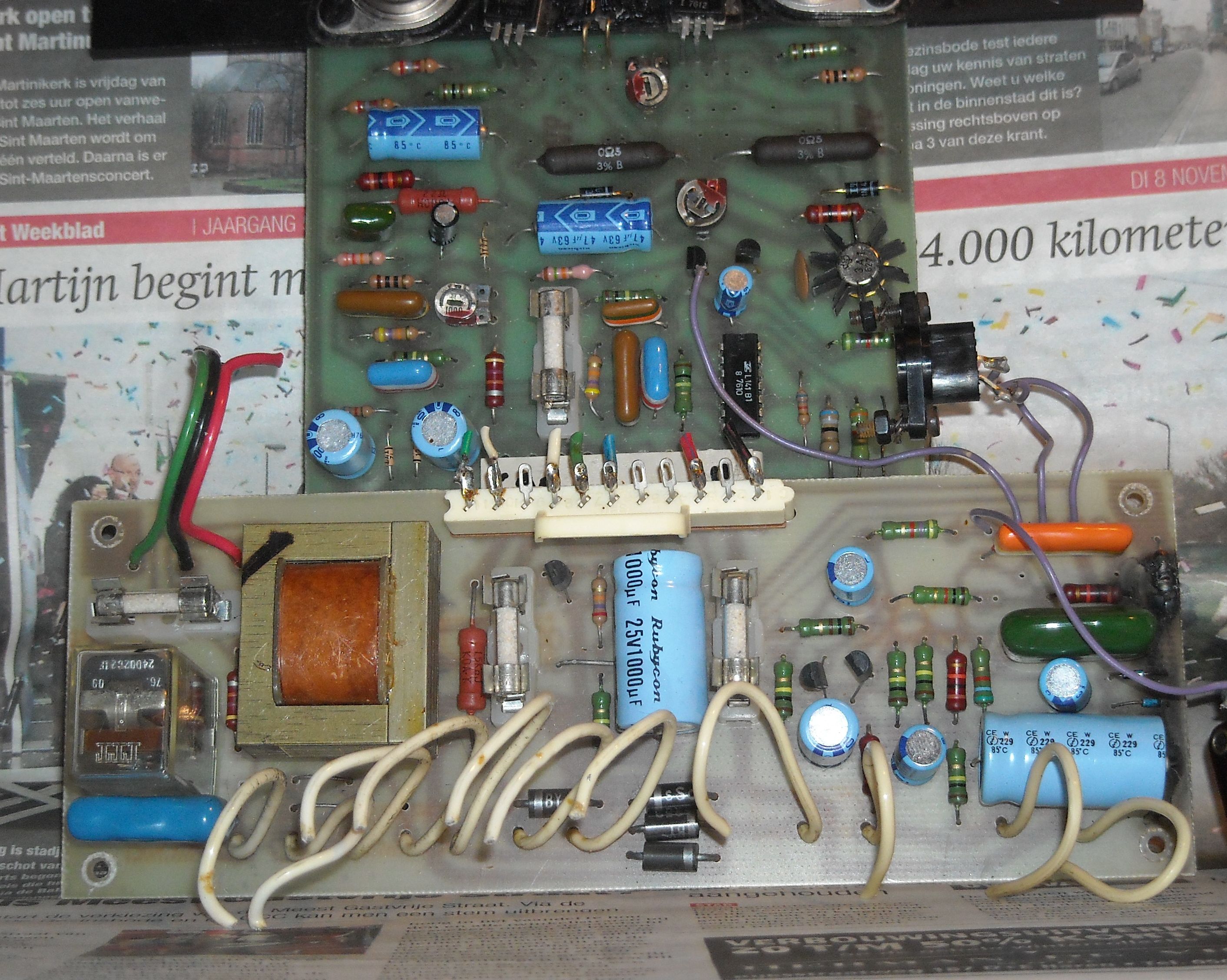

Don't know if you're still working on these but I have the schematic for the master control witch is very likewise. Mine have the thumb 2 and I could be wrong but suspect it to be 'normal'. Usualy you only plug them in once and be done with the thumping 🙂 Just try and give them some signal and see (hear) what they do?
I suspect the are for a particular woofer (they are in house designed/ made). I never got a conclusive answer to how and what they exactly did. No piezo element and I thought someone mensioned an extra winding on the coil but I'm realy not sure.
They sound pretty good btw, mine are not in to good of a state and still I like them a lot.
Don't use them anymore though since the don't like working without earthing and my unearthed pc or so I believe anyway. (something went wrong one time and burnt out a resistor bad...)

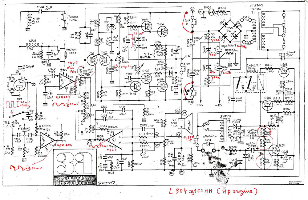

Hi there again ,
Okay I think you should change that burned resistor also you should check the diodes and capacitors close to him if they are in working conditions, and I don't know why you have connected that wire on transistor ?! . When you check these make a short connection with black wire and red then connect the woofer(whatever woofer) on green and blue wire then put on power connect the signal and it will work , here is a view of second amp that I have repaired successfuly
Also here is more clear schema of 3A ANDANTE "PRELUDE","MASTER CONTROL","LINEARE"
Good to see you fixed them, mine are working again as wel, replaced a couple of thing and made a better earth connection. I think I have to dive into them again to replace some more electrolytes though.
Your links to imageshack don't seem to be correct, perhaps better to upload them to this forum anyway, then they don't get 'lost' ?
one right link:
one right link:
Also here is more clear schema of 3A ANDANTE "PRELUDE","MASTER CONTROL","LINEARE"An externally hosted image should be here but it was not working when we last tested it.
