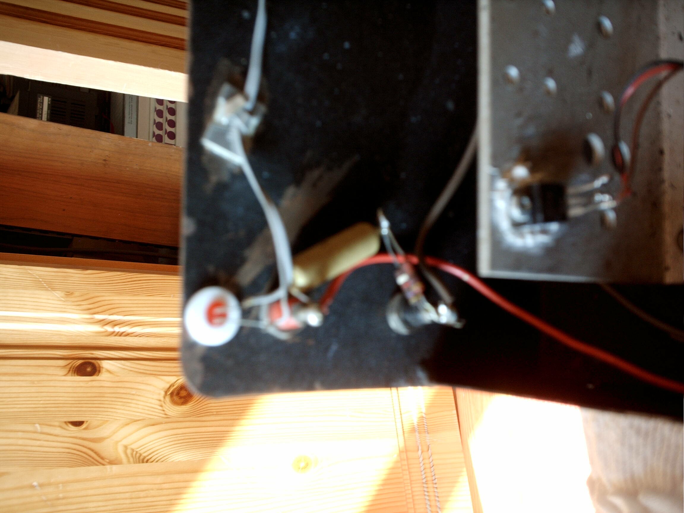

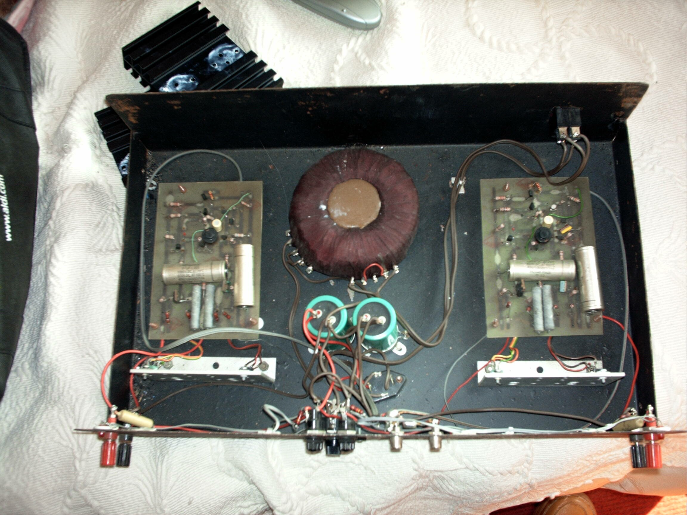

here are some pictures
I hope that these pictures attache ok
The amplifier now appears a little rough but its had a long working life !
I can even remember marking and cutting the boards by hand
This was way before the days of PC and cad software
I have also noticed that their is no dc blocking capacitor on the input to the diff pair but as the pre-amp was capcitor coupled it did not matter ( what a risk taker)
I shall post the schematic tommorow with a few more comments
This is only 1 of many hundreds of amplifiers I have made and designed over the last 40 years or so
But as they say we can all learn something new!
Ps the only failure in all this time has been the left hand led power indicator ( I knew these new fangled Leds were crap)
regards Trev

Very nice...real DIY work...lovely... a pity the camera cannot make close up picture
without loose it's focus... we could see these lovely construction in more details with the macro feature.
Some cameras does not have macro function, to make focus when the lenses are 10 to 20 centimeters from the target to be captured in photography.

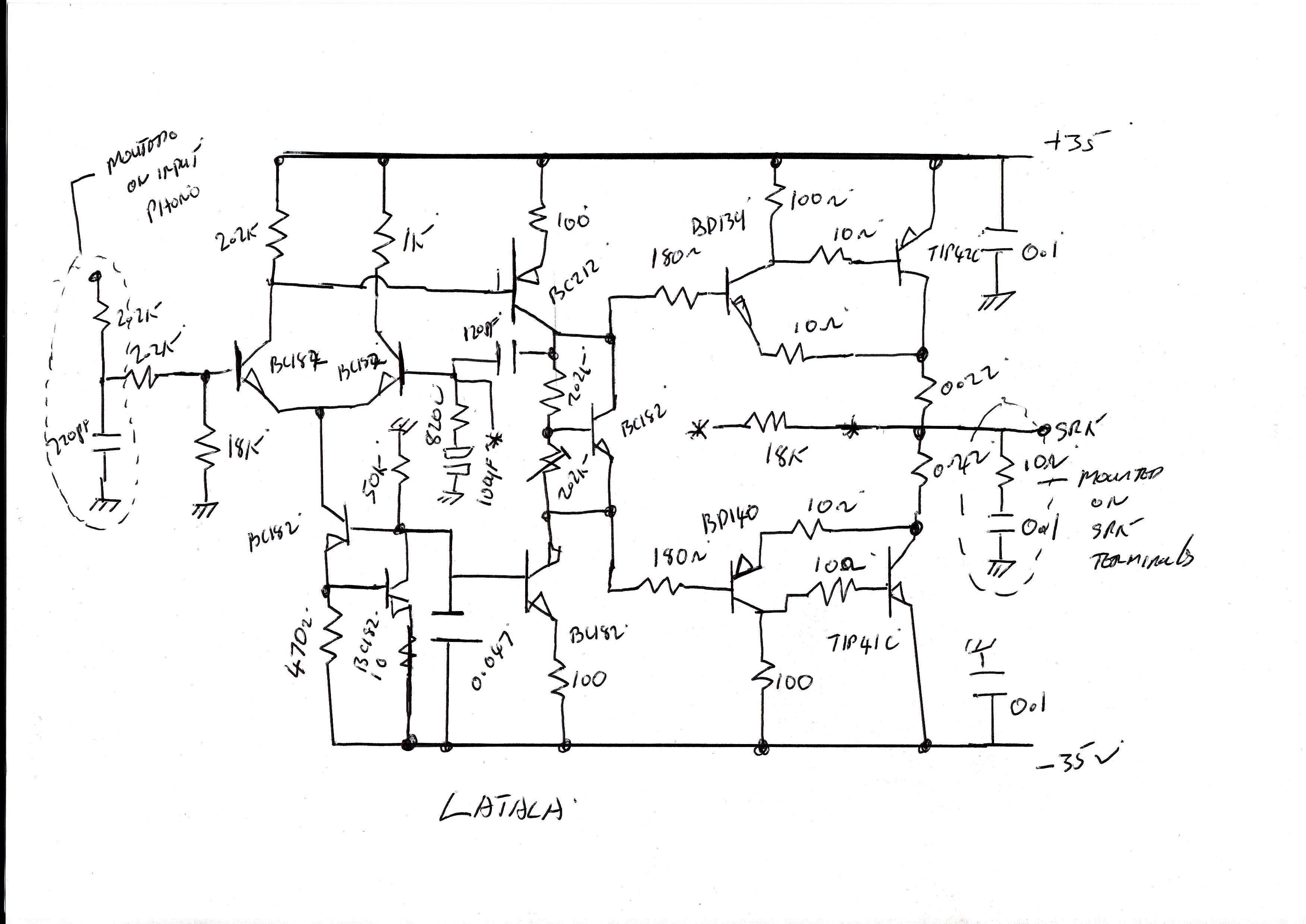

Please find hand drawn schematic of the power amplifier
I have used this scheme many times with great success However my designs that I use today have evolved from this design
To me the main advantage of this circuit is the thermal stability due to the use of the inverted darlingtons in the output stage.
I made many tests at the time that this circuit was created relating to thermal stability and can say that this was in the order of 10 times better re bias drift related to output transistor temperature when compared with both Quasi and true Darlington output stages. You will note from the earlier pictures that the bias monitor transistor is not even connected to the heatsink
I would say that this is a good design for any one looking for this power level
In this day when we have a very large selection of high performance devices it must be remembered that the devices we could obtain where very limited
especialy re operating voltage etc
regards trev

I forgot to mention that The amplifier is effected by the capacitor that is connected between the Vas collector and the input to the diff pair it is 100 pf here however when I was testing this I found that distortion could be made as low as 0.02% if this was reduced to 22pf,however stability was affected I decided by listening tests that the value of 100 pf gave me the best sound and a reasonable measured performance!
To me one of the most desirable properties on any power amplifier is stability
I should imagine that this amplifier would be very good with modern devices

Hi Trev,
Nice design!
Well, just for kicks I plugged the circuit into Spice.
With 100p compensation the loop gain phase margin is 88 deg, the dominant pole is around 260Hz. With only 20p compensation the phase margin only decreases to 84.5 deg, so I think it still is stable enough. The dominant pole in this case is around 1.2KHz.
The calculated distortion with 100p at 20KHz and 51W is 0,54%, with 20p, 53.1W 0.16% (no surprise here).
Just curios, what made you choose the compensation that you used instead of using it as a "regular" Miller capacitance at the VAS?
Regards, Peter
Nice design!
Regards, Peter
The schematic looks alot like the design of the Plastic Tiger power amplifier from the fabled Southwest Technical Products Company of Texas. Dating from around 1968.
I've never understood why sziklai pairs were qualified as "unstable", and this is one of the reasons why the tiger had a bad reputation.
You should probably replace those supply electrolytics soon, or they might cause lack of bass response, I think...

At the time It was stated by I think Linsley Hood that this was a better method that would render the amplifier less prone to slew rate limiting
To be honest I started using this method of compensation and never gave it another thought I have used it hundreds of times
I still have my Sugden test set that I used to measure distortion and noise etc
This would be done typically @ 100 hz 1khz and 10 khz
I totaly agree that the caps should be changed now and may do so in the future
My designs have moved on in all kinds of ways this was the thinking of 35 years ago
I have no experience of Spice modeling
Is there a sample program that I can download?
Nor do I, and I guess you can download it from their website, whatever it might be. I only simulate things in reality on my protoboard.
What do you mean by "re thermal stability" and "re that" ?The Tiger I became aware of only about 5 years ago via the web
I do not claim any origional thinking in this design and only mentioned it as I love invered darlingtons re thermal stability and found them no worse than any other output stage re oscillation provided they were fitted with stopper resistors as shown
I have also also done many mosfet units but always come back to inverted darlingtons
The exception is the new Sanken Darlingtons fitted with on chip temperature compensation I have had superb results with these !in my latest design cloned from the Albarry amplifier
I did also do a much improved version of this 35 year old design that had seperate power supplies for the voltage stage and a larger power supply dedicated to the output stage only
To me it was a revelation transient attack and vice like grip in the bass
would any one like to see the drawing re that
These are not concepts but practical amplifier
Regards For now Trev

Hi Trevor,
I have been using LtSpice, probably the most popular spice programs. It is a full featured program, free, can be downloaded from Linear Technologies web site : Linear Technology - LTspice IV Downloads and Updates , you not even need to register. The reason it is free that it is full with the macromodels of all the LT chips, LT considers it as a marketing tool.
Here is a web page to a LtSpice tutorial: LTspice Tutorial
There is also an excellent Yahoo discussion group on LtSpice.
You have to take the results of a simulation always with a grain of salt, and it is no substitute for engineering knowledge. On the other side it gives a tremendous insight into the circuit operation. It is always a ton of fun!
Try it, it will be another useful tool!
Good luck, Peter
Good luck, Peter
